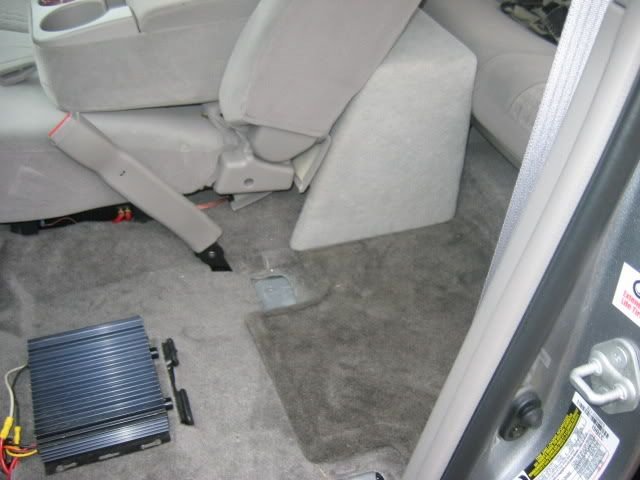

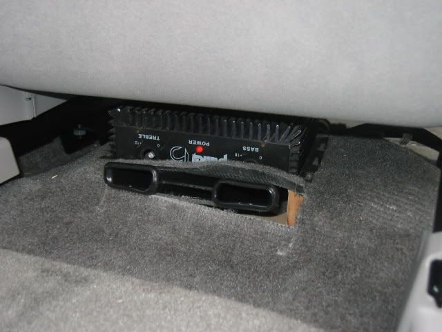

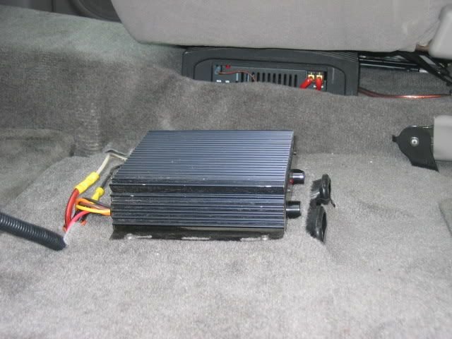

    I had 3 amps in my 2005 DC mounted under the front seat, but I had a bench seat..
    Used a pair of Punch amps I bought in the 1980s and another Punch for the sub...
    Amp2_46dae727186e92b721b31109c04bf0b253dfe013.jpg AmpMount2_e9024a3e8e980b4efdcaba018b96b9672ad35607.jpg

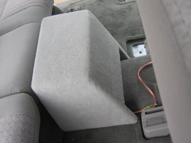

    I had a single 10" enclosure made that straddled the rear seat hump.
    That way I could easily take it out if I needed the room.
    WooferBox2_e4e9bd4e477af44a505cf4206a2e5a0b7393b9a2.jpg WooferBox1_f538d9301c8e33d5d9c726c4dc9efa258c83ff08.jpg

    That sub you have in that pic is great. I just put that same set in my Corvette recently.

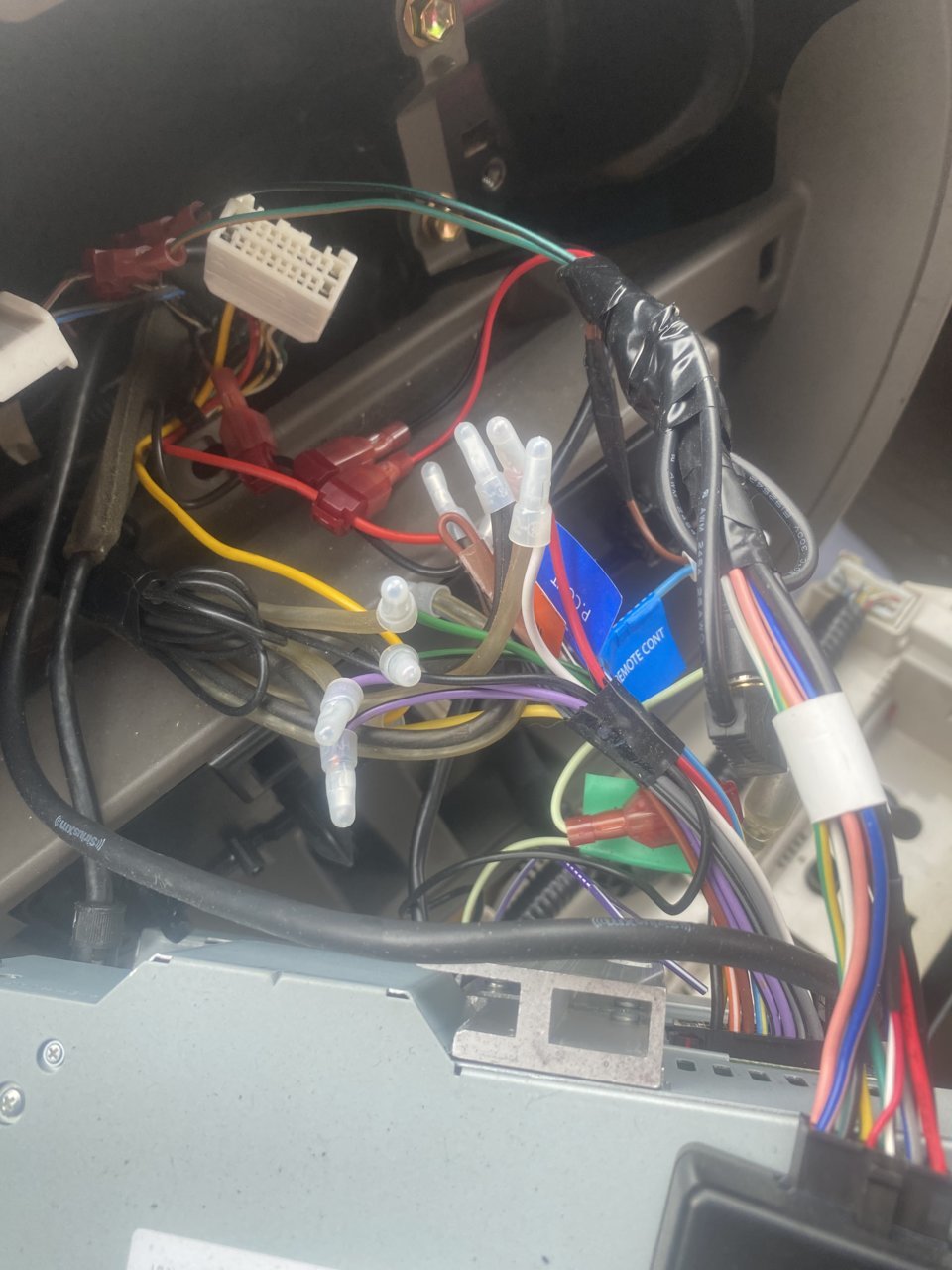

    The great part about modern radio stuff is we've reached point where we're at pretty common standards for aftermarket components and harnesses. Like, speakers will always be on purple, green, white, and grey wires, each always corresponds to the same color. Solid yellow is virtually always constant power, red is almost always switched/ACC power, black is always ground. I've rarely seen blue wires not being used for remote power signal/turn-on wire (for power antennae, amplifier turn-on signal, etc.)
    Once you get into your 1st install and realize a lot of this stuff, it really is just a matter of having a good pair of crimpers, and proper fastener to crimp on, and sometimes taking a second to think through cases where you may need to crimp three wires together - like, if you have your stereo, and a steering wheel control adapter module, you may need to crimp both onto the single power wire, merging the three together.
    Anyone can do it. But it helps to have someone to lean on when you hit those weird corner cases and some of the Engrish-ass instructions aren't really helping. :D

    This looks a lot like someone’s stereo I know except they use insulated spade connectors. :anonymous:
