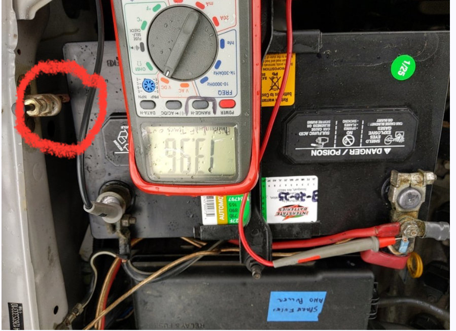

    2006 Tundra DC SR5 4WD 4.7 V8
    Nothing loose. Getting a good charge.
    WILLINH and KNABORES like this.

    If you turn off the truck, wait half an hour and test again, and it's under 11v, @KNABORES is probably dead-on.

    This must be fancy 2006 hardware!
    NewImprovedRon likes this.

    Nothing but the best for the Tundra! Viper alarm/remote start.

    Thought maybe later years had underhood lighting

    Classic pin switch
