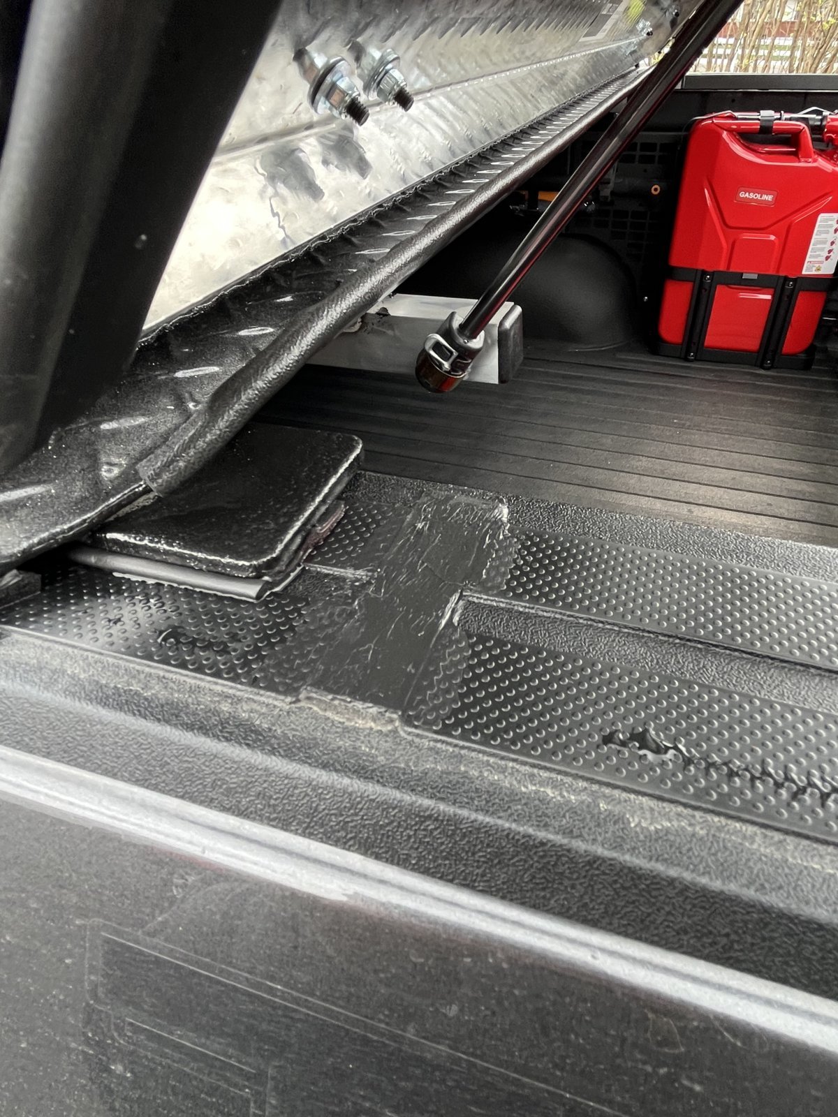

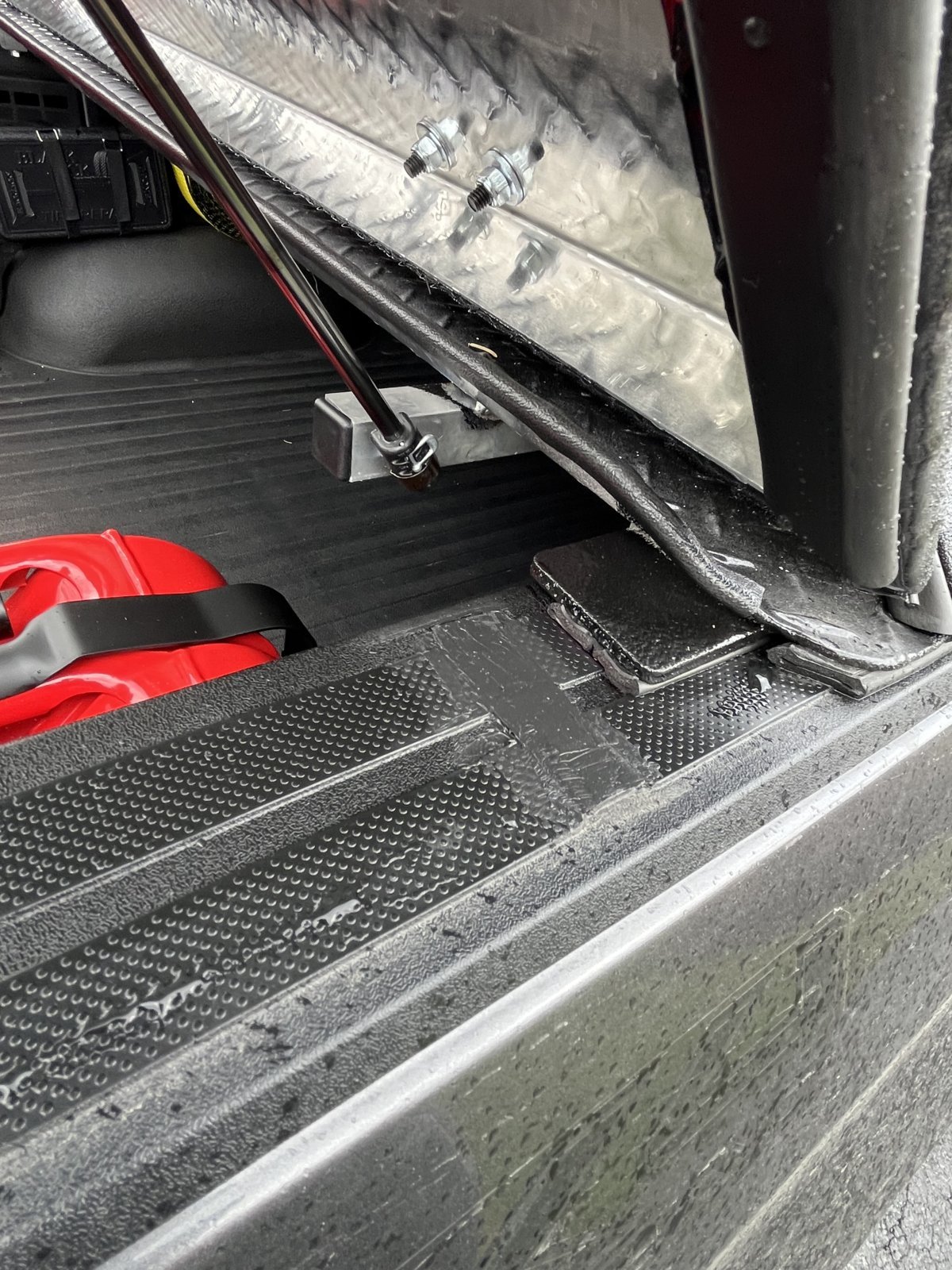

    Did a little silicone work to fill the gaps in the bed rails. Seems to have stopped rain from leaking on the sides. Just have to figure out the bulkhead. Used some leftover thin neoprene foam rubber I had. Perfect thickness. Stuck it on and pained silicone on top.

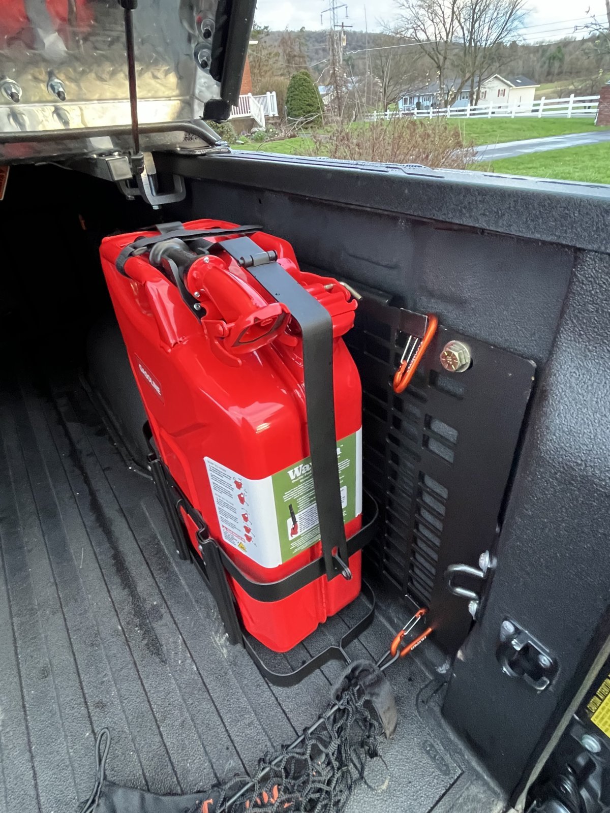

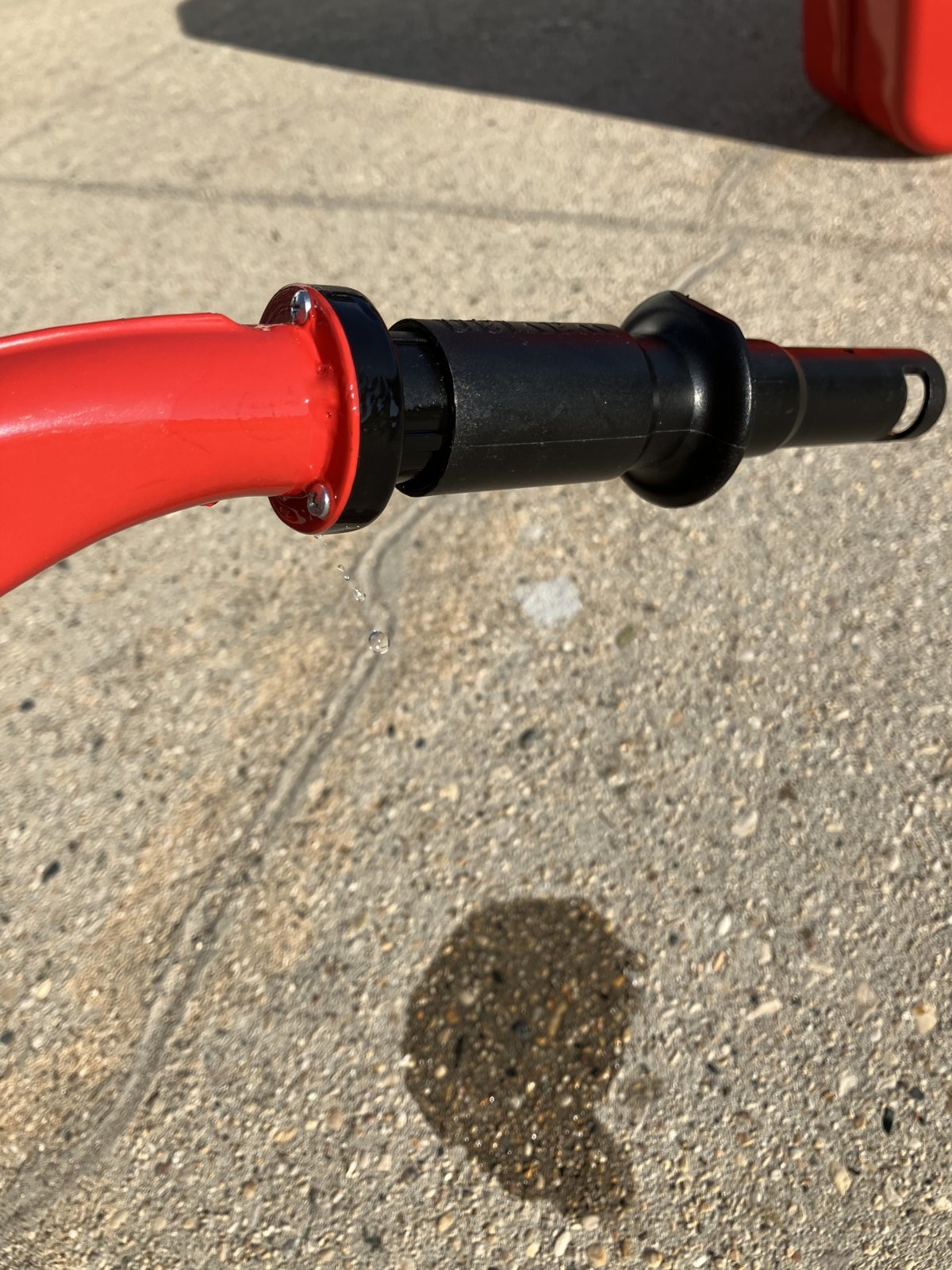

    @therealjonwick. On a side note, I like your Wavian jerry can install and I'd like to do the same install with mine. What hardware have you mounted on the bed side walls for securement of the jerry can? Also, I have had issues with multiple pour spouts for my Wavians as they all leak at the metal/plastic joint. Have you had any leakage issues?
  14. Apr 12, 2024 at 4:15 PM
    #1124
    therealjonwick
    therealjonwick New Member
    Jul 30, 2023
    #101209
    559
    JR
    2019 OR

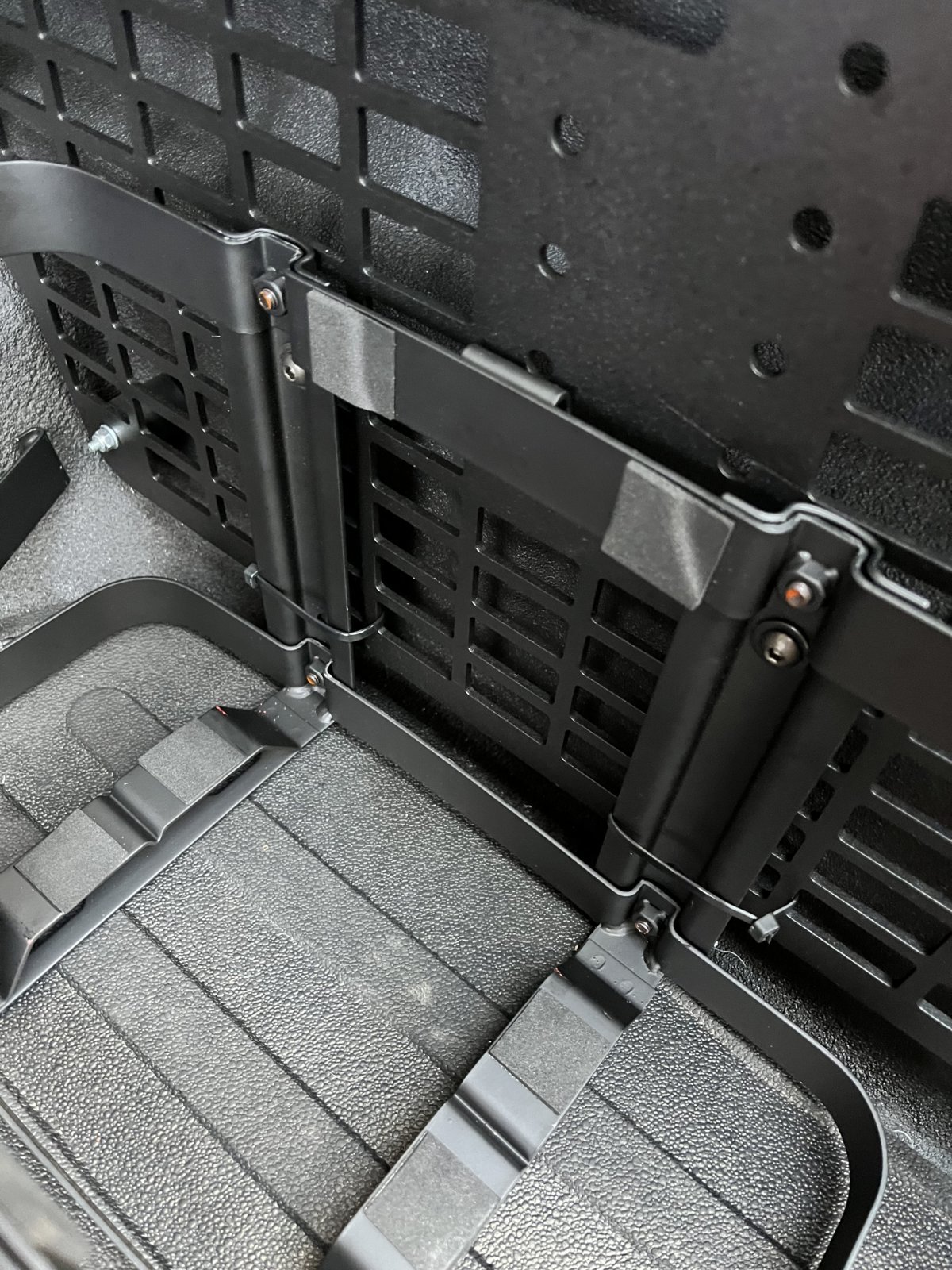

    Thanks! I just got it so I have not used it. I will keep an eye out for that. I purchased the can holder recommended through Amazon: https://www.amazon.com/dp/B0BGSP7HX2 I used vibratite on all the screws.
    I mounted it to my molle panels. Cali raised. I used their mounting kit hardware through the holes of the can mount. Two in the top holes, then zip ties on the bottom. Can is full and is secure while driving. I did notice a bit of paint wearing off on the mount. Nothing too crazy. I might add some more neoprene rubber to those areas.

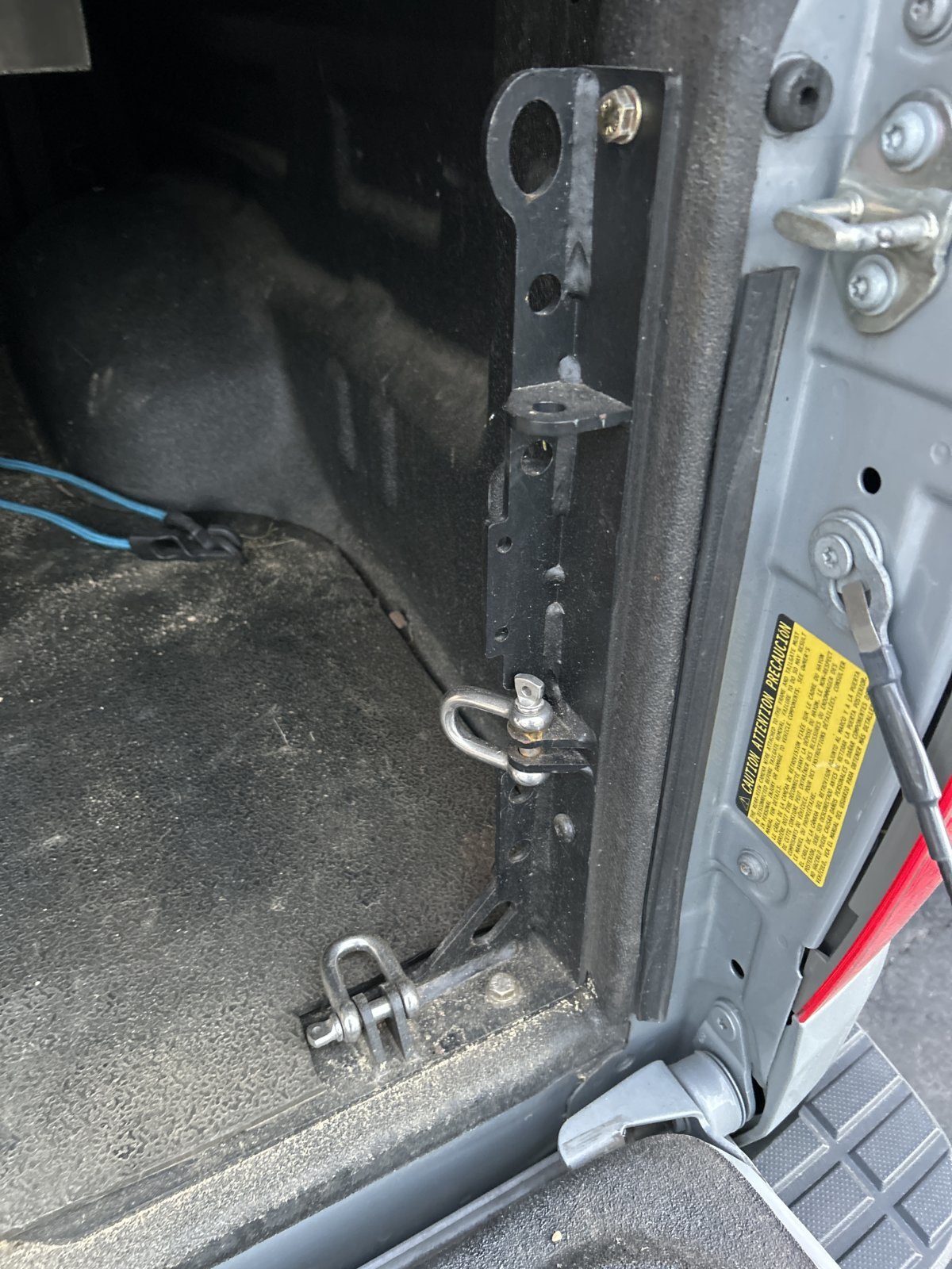

    What bed stiffeners do you have? Trying to get a set. Not sure what are the best out there. Also want to cut my bed mat as little as possible.
  16. Apr 13, 2024 at 4:37 PM
    #1126
    shawn474
    shawn474 Lego connoisseur
    Jul 23, 2019
    #33569
    2,859
    MoCo, Maryland
    I honestly forget the brand; no idea.
  17. Apr 13, 2024 at 4:40 PM
    #1127
    therealjonwick
    Jul 30, 2023
    #101209
    559
    JR
    2019 OR
    They look like Total Chaos but a bit different

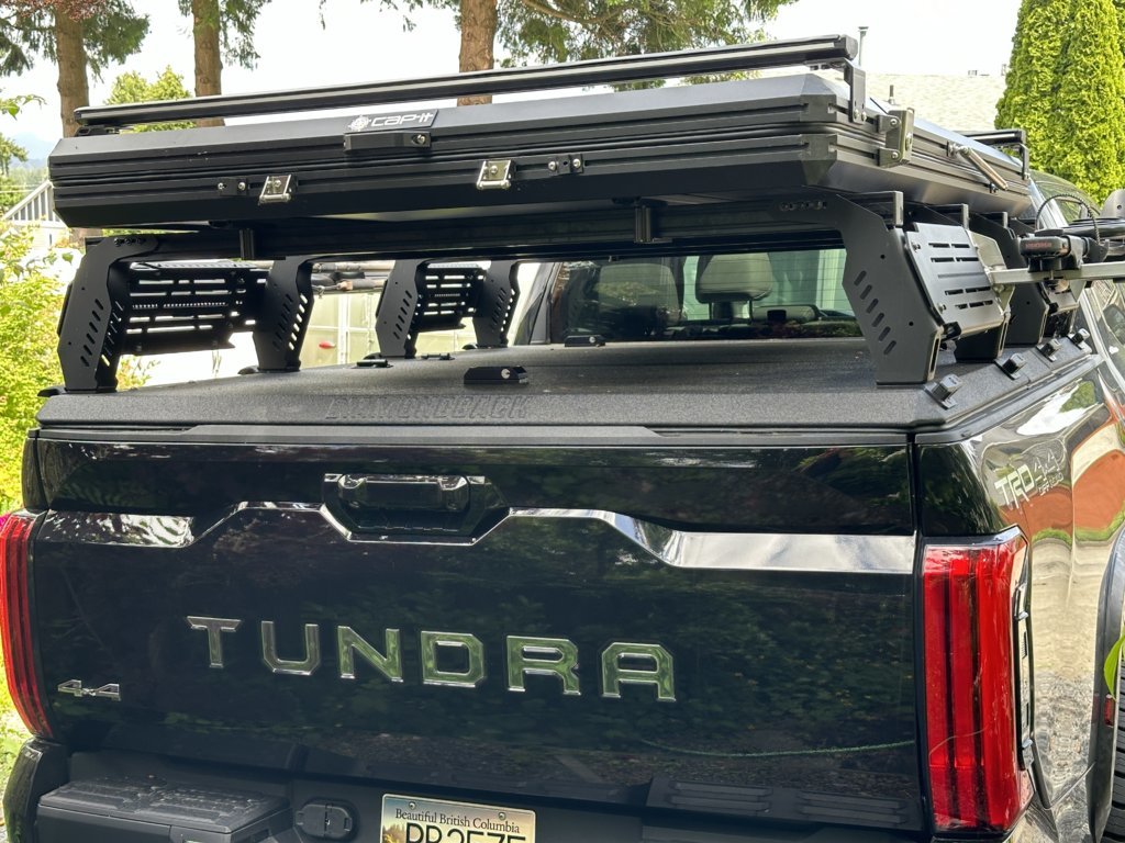

    My Uptop racks sit on each cover section of my SE. It mounts to the cover cleats like the gettrukd does but has 2 separate sections so you can open the covers up without taking the rack apart.
    When the tent or bike racks are attached, this becomes more of a challenge to open. Not too sure how to answer the flimsy question, this is certainly not flimsy!

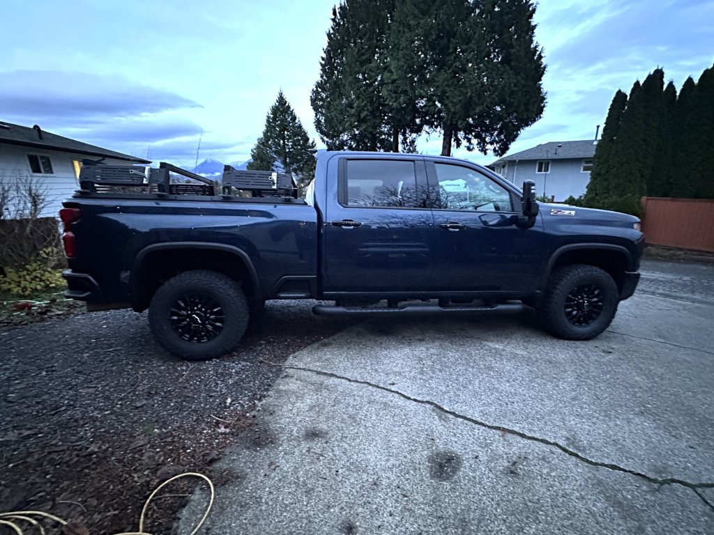

    I have my second Diamondback (was on the Gen 3 Tundra 6.5 Bed for almost 2 years). This one is an SE which is a tab lighter than the HD.
    I took the cover off and was able to squeeze it onto the Chevy 1 ton and it fits. This was a big question for me and since I put it on, I saved about $3k. It is an inch smaller all around but the seal does make contact and the locking bars work too.
    The Diamondback cover is great and well worth any inconvenience
    IMG_2954.jpg ce especially if you switch to a Chevy :)
