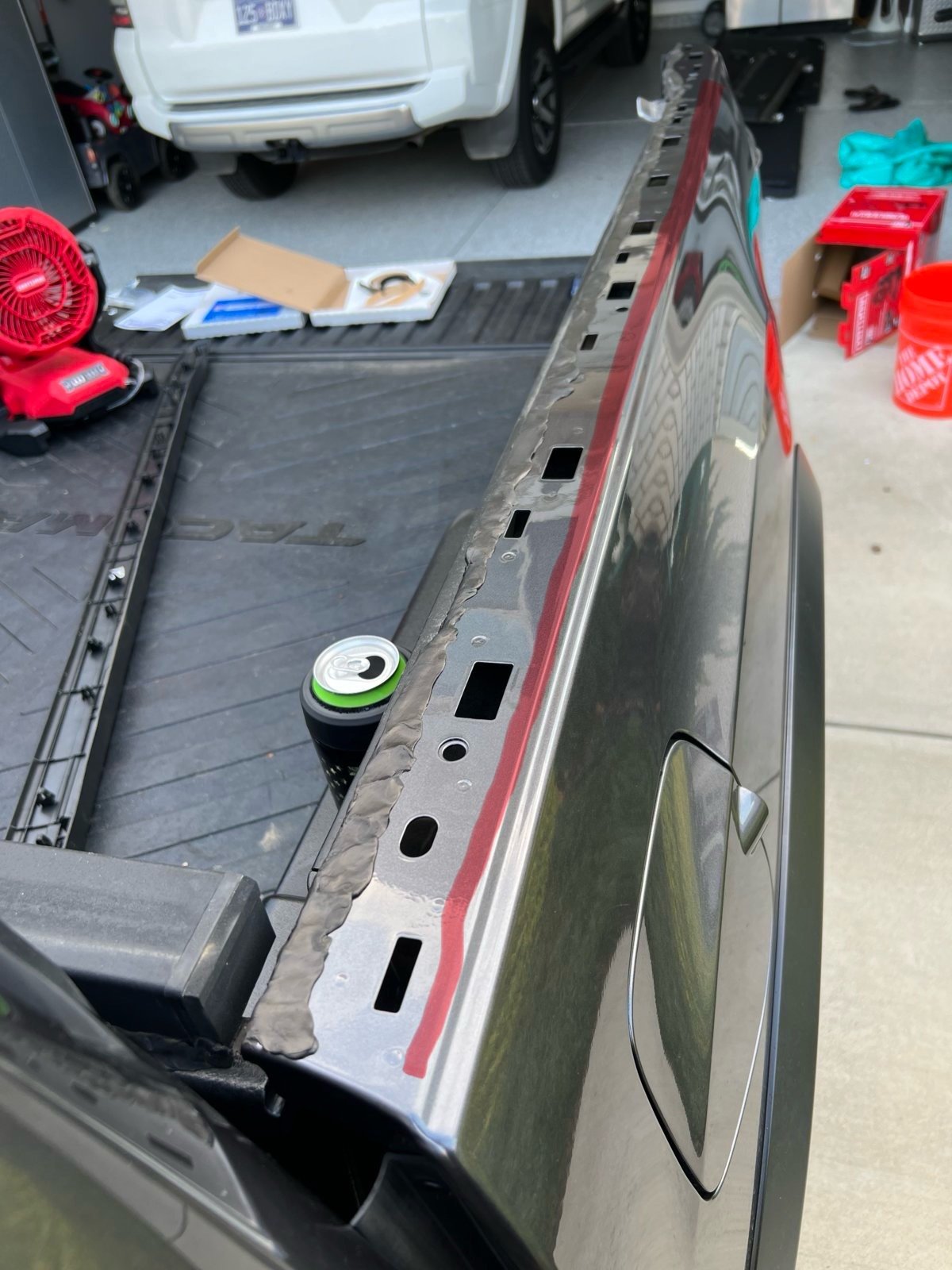

    Borrowing this pic of a Tacoma - this is the exact area on the tundra where my DB cover leaked. You need to fill the gap between the bed side and front wall (I ran a bead of silicone down the crack) and also along the top of the bed rail under the plastic cap like the putty shown in the pic.
    The tundra doesn’t have a separate piece width wise along the top of the front bed wall but DB provides weather stripping to apply there which helps level it with the bed rail caps.

    1. How hard is it to remove the plastic covers?
    2. Why not just butyl tape on the top of the bed sides (but near the outside not the inside like you did it)?
    if you can stop the water intrusion from the “outside” it will just drip down the side of the truck.
    I also have some leaking into from the cover, but,from under the plastic covers, AND only when using a high pressure washer

    plastic covers came off easily. Really just pull up and they pop out. At least on the Tacoma they did. I guess you could use butyl type on top of them but used my bed often to haul things that couldn’t fit under the cover, so the cover came off fairly often. Guess I didn’t want it exposed. Plus butyl tape is a bit sticky, so I realized if it encountered the seal around the bed cover it would stick to it when opening the cover. I like the butyl tape cause it’s easier to remove than caulk or sealant and when doing some research a lot of people said it was very good to use to keep water out. So I just tried what I thought would work and it worked out well.

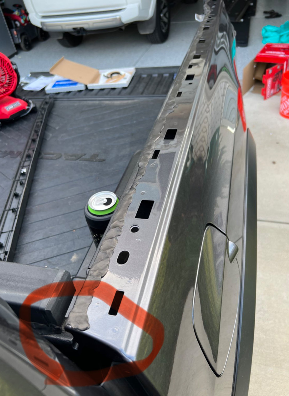

    I have a hard time explaining so here’s a pic of what I meant (I highlighted in red where I was asking why you did not place the butyl).
    you placed on the “inside or close to the bed” and I asked why not “outside and closer to the outside of the box”

    Ahh, ok that makes more sense now. I think I stuck to the inside cause I folded it over the edge of the bed. There was some holes on the top inner portion of the bed that needed to be filled in. I figured as long as there was a seal the outside wasn’t needed. But I think either would work.

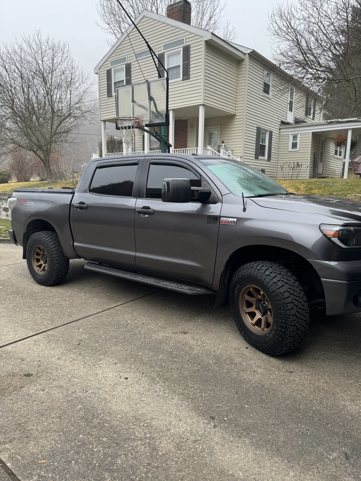

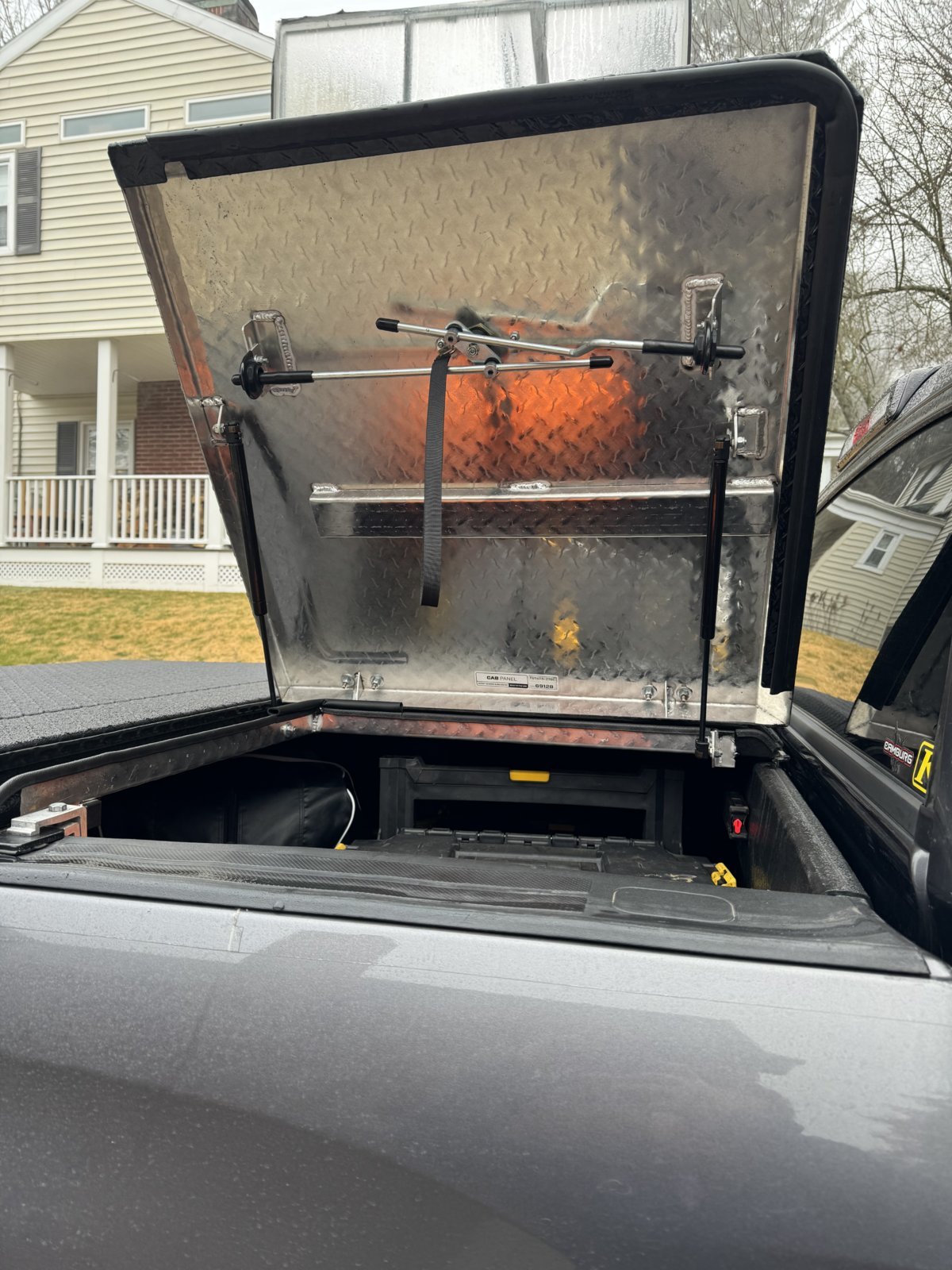

    Recently picked up this DB 270 for my 2013 for a decent deal. Have wanted one for a long time. Has anyone custom built a cross bed box for theirs similar to the crossbin Diamondback sells for $400 on their website? IMG_0602.jpg I figure a Saturday afternoon with some plywood and a few beers I could easily make something that does the job.

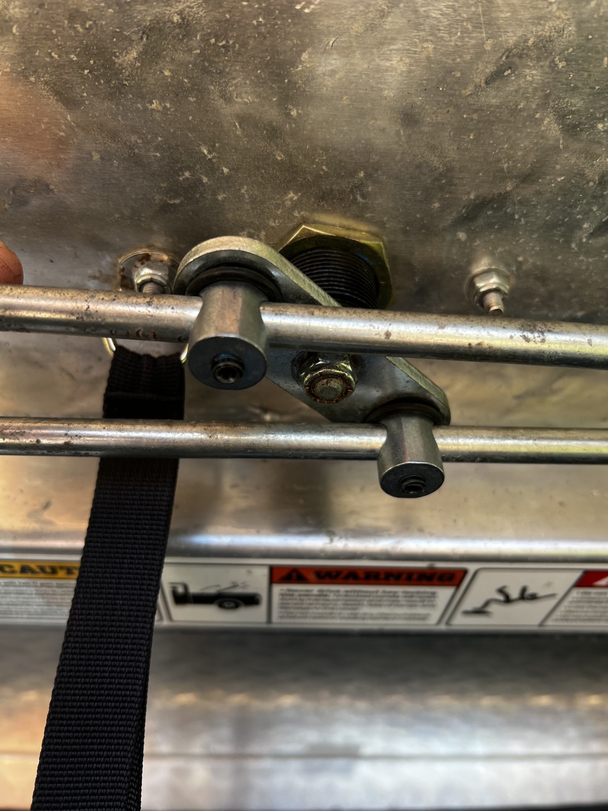

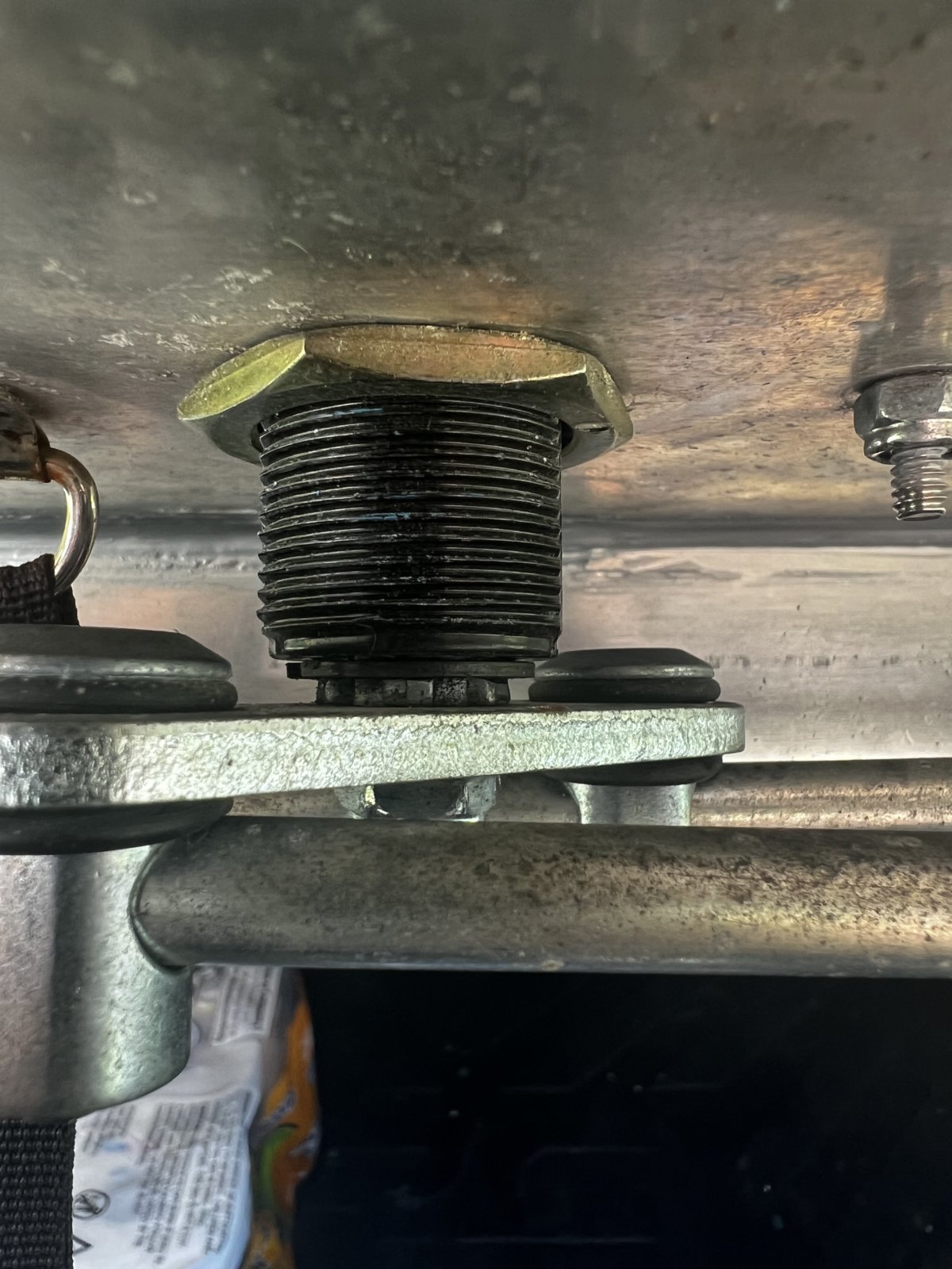

    So I picked up a used diamondback SE a few months back. Bought some new weather strip for it and it works great. The lone problem is the constant rattle I hear when the back window is down. I caulked along the C channels like others have recommended but I still have the noise. After investigating a bit more it actually looks like the lock mechanisms are loose on the underside of the cover. Even when locked I can wiggle the center a good bit and it makes the noise I hear. You can see in the photo it looks like there is an O ring in there that is chewed up a bit. I tried to loosen/tighten the 13mm nut in the center but it just spins. Has anyone else taken this lock off before? Just trying to see if I can get it apart and add a new thicker o ring to fix the problem.

    I have never taken the locks off before but I mean mine has made noise with my Tacoma and now my tundra. If I hit bumps I can hear it with the back window open. Figured it was just the nature of a metal cover and making noise. Never really thought much of it. Mine wasn’t rattling though, so maybe that is why it didn’t bother me

    Yeah I hear noises like those as well and like you said, the nature of metal. This is a constant rattle though with any imperfection in the road. Drives me nuts.

    I’d recommend messaging Diamondback. They are really fast at responding. Could be a bad seal around the underside of the lock maybe. That’s what I would do and see what they say.
