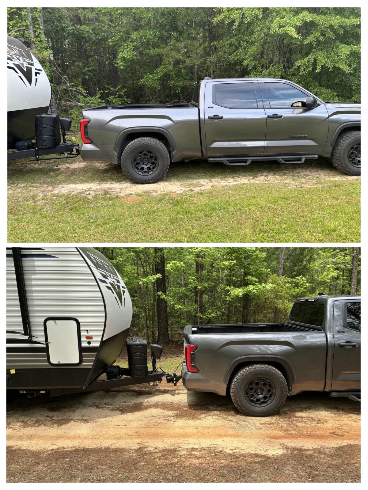

    My Camper is 8830 dry with a 925 tongue weight. I have the Timbren SES and they work perfect. Before (bottom) and after the Timbrens.

    In your bottom picture you do not have the spring bars installed in your WDH.
    Tundrastruck91 likes this.

    23
    Good point, It had no noticable effect on the rear height though. I set up the WDH myself so may need some tweaking?

    #25048
    16,399
    Neil
    2020 MGM SR5 CM 4X4
    That's a WDH? I don't see any clamps on the trailer.
  20. Jul 28, 2024 at 7:02 AM
    #200
    ocman40
    ocman40 New Member
    Mar 2, 2024
    #112922
    23
    Check the top pic, bottom pic I didnt have them on as I was not about to pull/tow until I had the Timbrens installed.
  21. Jul 28, 2024 at 7:13 AM
    #201
    Cpl_Punishment
    Jan 24, 2019
    #25048
    16,399
    Neil
    2020 MGM SR5 CM 4X4
    But why take them off the trailer?
    NatesNightMare likes this.
  22. Jul 28, 2024 at 7:21 AM
    #202
    ocman40
    ocman40 New Member
    Mar 2, 2024
    #112922
    23
    I had not installed them yet, When I took the bottom pic I was testing to see how it affected the height/sag and had not pulled it yet. They are on for good now.

    Yeah you may need to set up your wdh better. Theres plenty of youtube vids that help. You should only have 5 link of chain or more. May have to drop your hitch down some also. Im lifted with no bags and my wdh once setup right had me level and I have a 2nd gen. I have about 6 maybe 7 links

    Setting up a WDH correctly is the ticket (without air bags)....
    Using a 4' level, Level the camper (unhooked from the truck) according to the frame underneath... Measure from the top of the inside of the coupler (where the ball goes) to the ground... Set the ball on the truck at this height... Using something like this ... https://www.acehardware.com/departm...ing-tools/measuring-devices/25865?store=05294 ... Set it on top of the flat spot on the ball... You want the ball to be at a 6 degree angle (a lil more if you want more lift) ...
    Measure (the front wheel well) from the top of it to the ground before any thing is hooked up... Set up WDH as said above... and then measure the distance on the front well well again... Your looking for the same original measurement with nothing hooked to the truck...

    Need to mention needs all to be done on level ground
