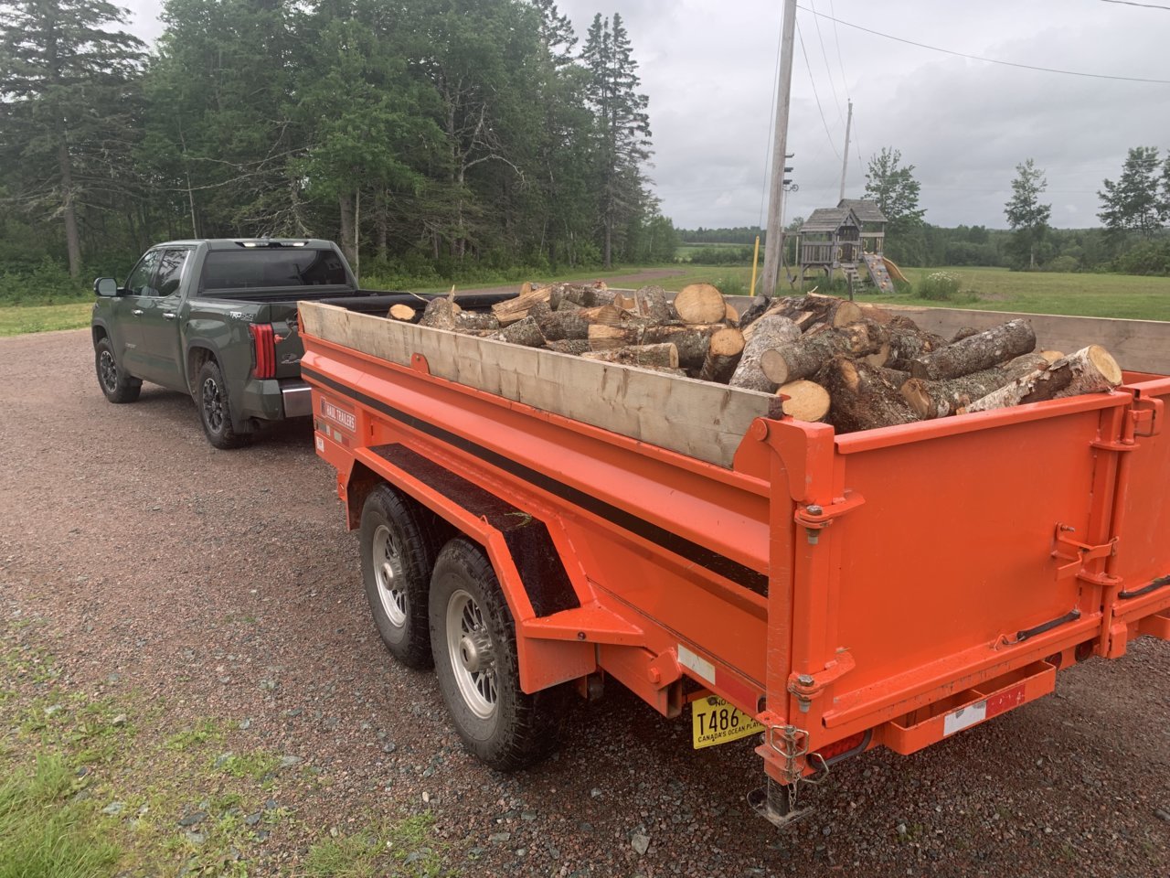

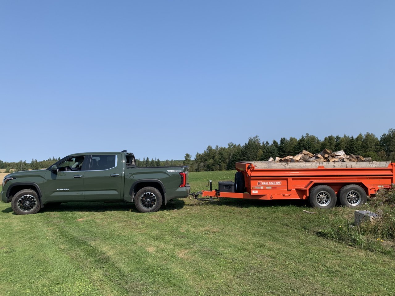

    By the looks of this picture… a nice weight distribution hitch and torsion bars would help you greatly, when set up and the right amount of tension on them.
    Pic #1 - That load including trailer was approximately 6500lbs. No torsion bars on
    Pic #2 with torsion bars but almost 9500lbs with trailer combined with green firewood, but truck was sitting perfectly level along with trailer..
    However I am anticipating new springs from General Spring to try out hopefully and will have some good luck with the increased weight capacity.

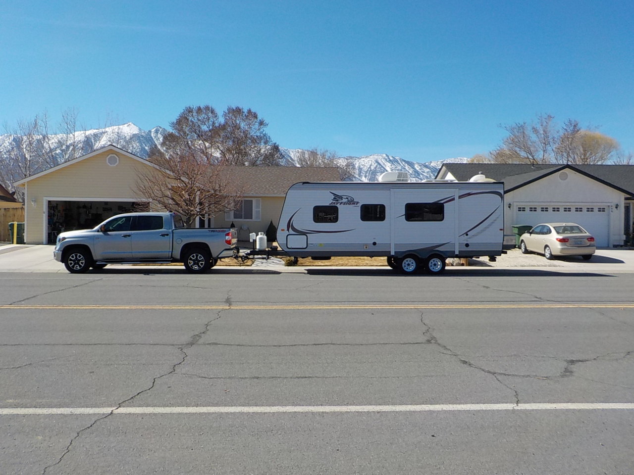

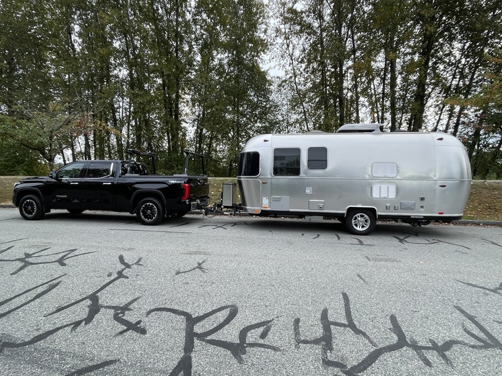

    This is my setup with WDH and air bags set at 50 LBS. It is a 24 ft Jayco, with a hitch weight of 750 lbs. Trailer loaded weight is 7000 lbs. This picture is with no passengers or cargo in truck.
    When truck is loaded the truck and trailer set level. Air bags do help. truck.jpg

    That looks terrific! What airbags do you have, or are they factory? Any chance you got the rear axle weight with it hooked up and loaded?
  9. Oct 13, 2022 at 7:49 PM
    #129
    Half track
    Half track New Member
    Dec 30, 2019
    #40506
    126
    Rob
    Western Nevada
    2020 Silver Tundra SR5 TRD, 38 gal tank
    Tow Mirrors
    I had firestone air bags put on at my local RV shop. And no I have not weight my back axle when loaded.
    But using a WDH you see about weight 20% of your hitch weight goes back on to the trailers axles.
    So I would say my rear axle with the WDH would be about 150lbs less.
    But air bags really help when I disengage my WDH arms, to make sharp corners in campgrounds and back in to campground spots. Without my air bags the rear end of the truck drops by 3".
    I camp mostly in the sierra mountain and a lot of the camp ground spaces are not level and have tight corners.

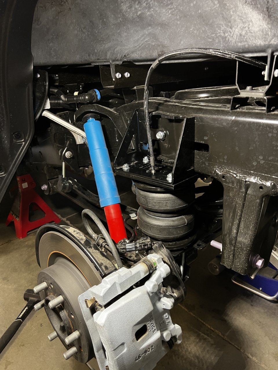

    #84960
    56
    Chanh
    2022 Tundra Platinum
    Wheels,lift,air level std stuff

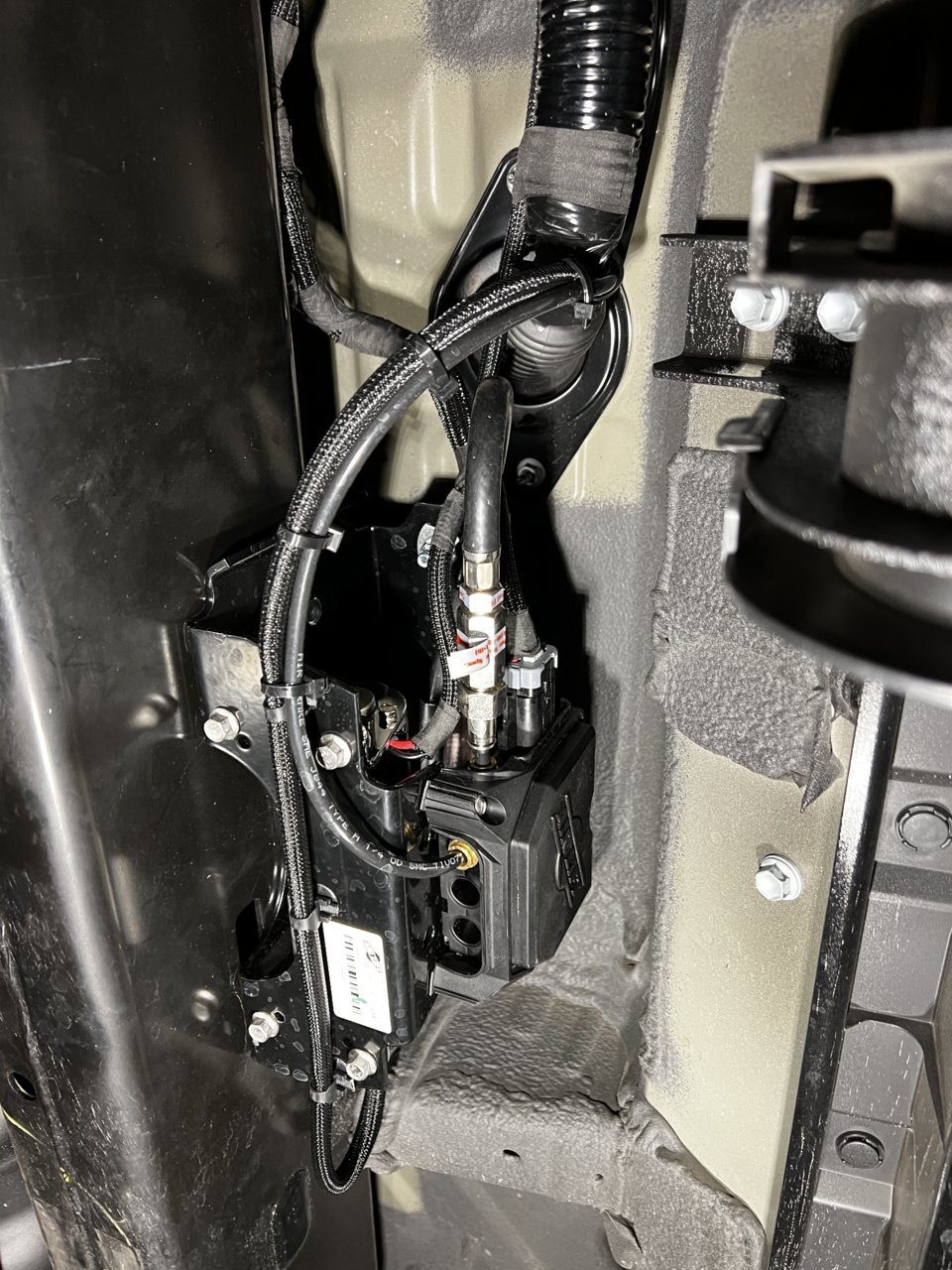

    Installing airlift 57383 lit on my platinum tomorrow...pic will follow..

    I've been using a WDH & AirLift's Ultimate 5000 Air bags with great success. It will level any load you could possibly carry/tow with the Tundra, that is within manufacture recommendations. Ride quality is great, and I can't discern a difference with no load/deflated bags at 5psi, over stock form. The AirLift WirelessOne air pump will maintain a minimum of 5 PSI to prevent damage to the bags. Anyhow, you'll read a lot of hate on the forum for airbags, but if you're carrying loads in the bed, or towing with the appropriate WDH setup, they certainly have their place. The bottom line is, these trucks have a soft rear suspension, and a WDS while it helps, is not an end all be all.

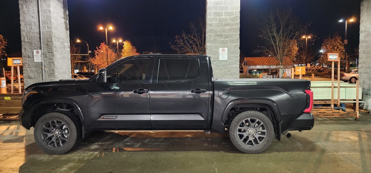

    My plat hybrid is only a few weeks old, haven't towed anything yet and it's starting to sag in the rear..

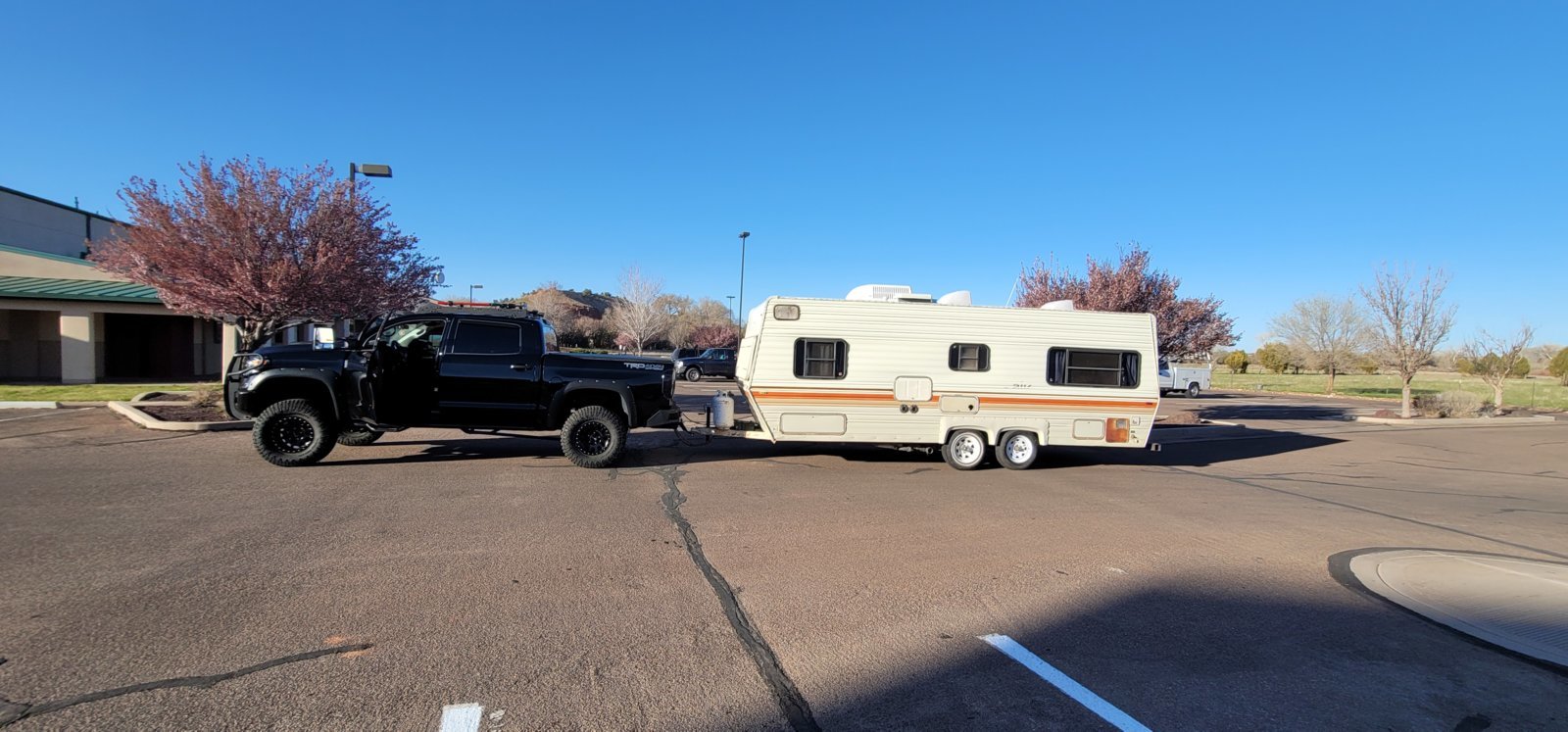

    Just picked up a trailer and I think ive got a bit of sag. Im also thinking about flipping the axles and it rides quite low. Any info please
    Trailer paperwork looks to say around 4-5k dry weight?!
    Am watching a wdh setup nearby
