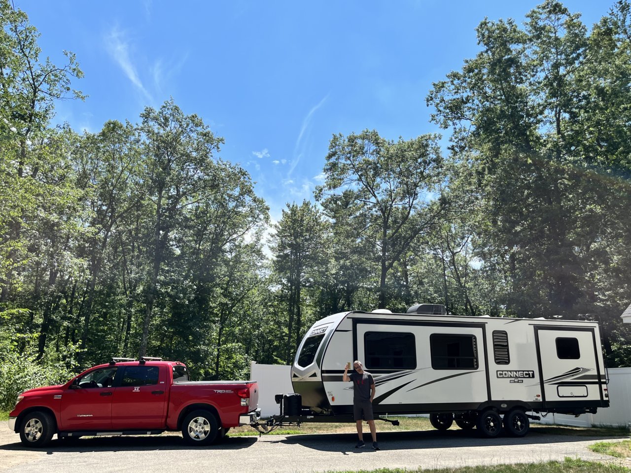

  28. Aug 24, 2022 at 6:36 AM
    #118
    LEM
    LEM New Member
    Jul 4, 2022
    #80280
    13
    2022 Lunar Rock Tundra Limited TRD
    Nor did my 2007. Here they are in comparisonD1A23C89-2DE9-4D86-BF44-1778A71D7EB0.jpg with the same trailer.
  29. Aug 24, 2022 at 6:43 AM
    #119
    Cpl_Punishment
    Jan 24, 2019
    #25048
    16,399
    Neil
    2020 MGM SR5 CM 4X4
    Did you readjust the WDH for the new truck?
    GODZILLA likes this.

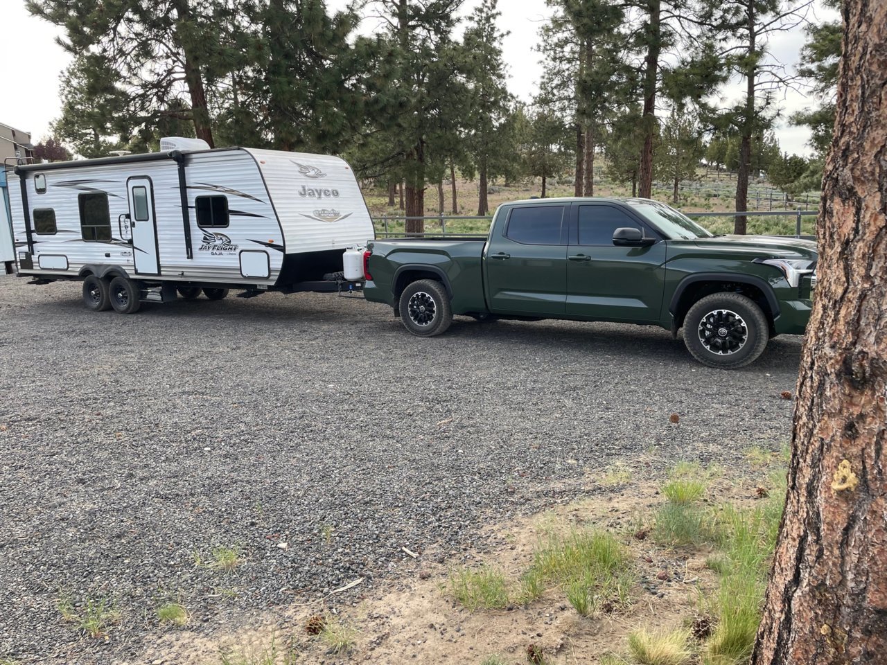

  30. Aug 24, 2022 at 1:51 PM
    #120
    Knifeguy
    Knifeguy New Member
    Aug 5, 2022
    #81567
    58
    Erik
    Oklahoma
    22 SR5 4x4 Crew-Max Short bed
    It could be the photos, but it sure doesn't look like there is much tension on the bars on almost all these pictures of sagging trucks. They all look pretty straight.
