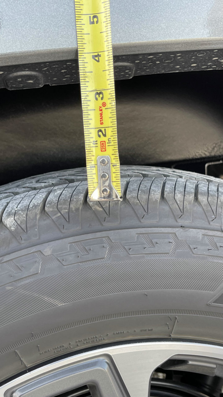

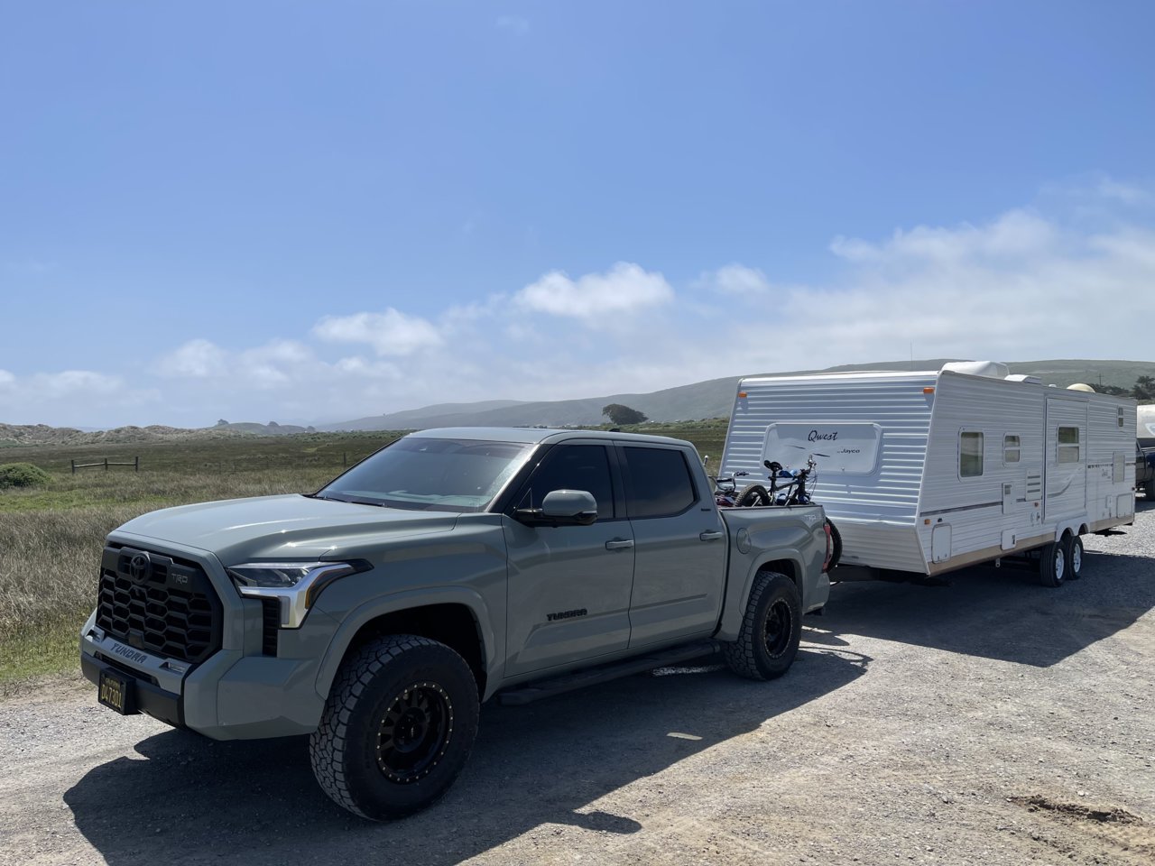

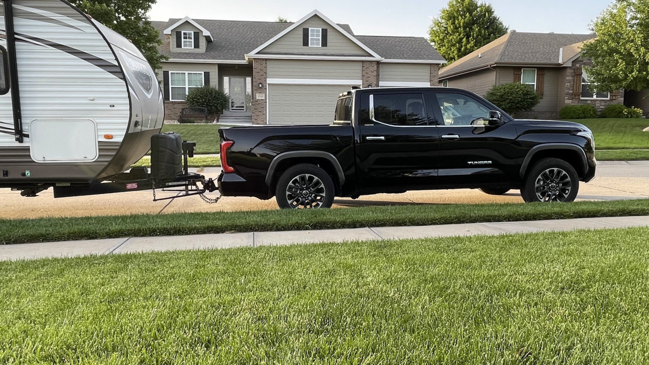

    Reading this thread.... I'm a new 2022 owner (Limited Trim) and picked up my camper for the first time tonight and got upset by amount of sag. Seems like adding air bags is my only option? (I don't want a lift at all). Measures 4" from the fender to the wheel with my WDH hitch on (1000lbs bars). 7.5" with no load (See thumbnails of these measurements). the WDH hitch is only taking out .25" of the .75" of front fender lift when the bars are used. So, maybe I can adjust that a bit more for this truck to get that closer to half of the .75",but still, I'm worried about our long drive in July if I don't do something about this sag.
    Has anyone installed after-market air-bags? Does Toyota have a factory self-leveling option I should consider?
    My 36' camper is 8,000lbs dry

    You have the same problem as the OP. An 8000 lb dry trailer has probably a 1200 lb tongue weight when loaded. You should have minimum 1200 lb bars. I believe Equalizer goes from 1000 lb to 1400 lb bars. Your tongue with propane and batteries is easily over 1000 lbs and is crushing your wdh bars
    RV dealers are notorious for doing a crappy job setting up wdh’s

    If you front axle is not right about where it was before hooking up your hitch is out of adjustment.
    I have done bag and I have done SumoSprings. I would go SumoSprings again if anything. However, both of these options overloaded my rear axle while not putting the weight back on the front like it should.
    Do it right or you may find yourself very much regretting it at some point in the future.

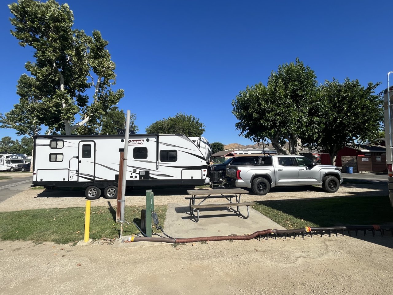

    I have a 5400lb (dry) TT. Guessing it’s just over 7000lb loaded. I have a scale, tongue weight is 1000lb. That’s pretty heavy! I use a properly set up wdh (took a couple times to dial it in just right). When hooked up the front stays level, I sag just under 2” in the rear (so the truck is level due to front rake). To me that’s expected with a half ton. My 2019 ram 1500 did the exact same thing. The truck tows great. I prefer it to the Ram, much more low end power and better shifting.
    i think you need to look at your wdh weight rating and setup. You should have no problem if it’s properly set up and the right size.

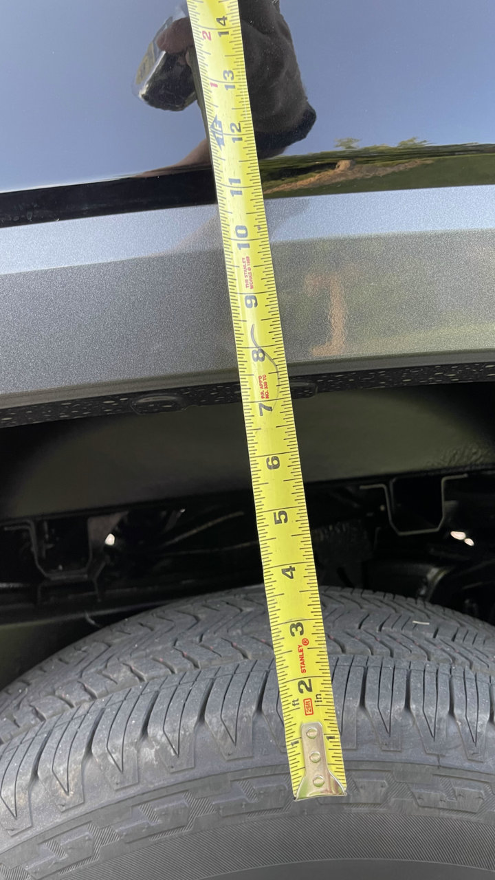

    Spent time to adjust the hitch last night and got an inch of sag removed. The front only lifts about a quarter of an inch now versus 3/4 of an inch before. Couldn’t get a tape measure up there but the bump stops look to be about 2 inches above the axle. Maybe slightly more.
    i’m still researching aftermarket airbags to install, but the firestone ones at real trucks.com say they will fit on their website but I spent an hour and a half on the phone with them yesterday and they determined they will not fit as fire stones documentation only has them certified fit through 2021.
    If anyone has experience with a set of airbags that are verified to fit the 2022s, please let me know.

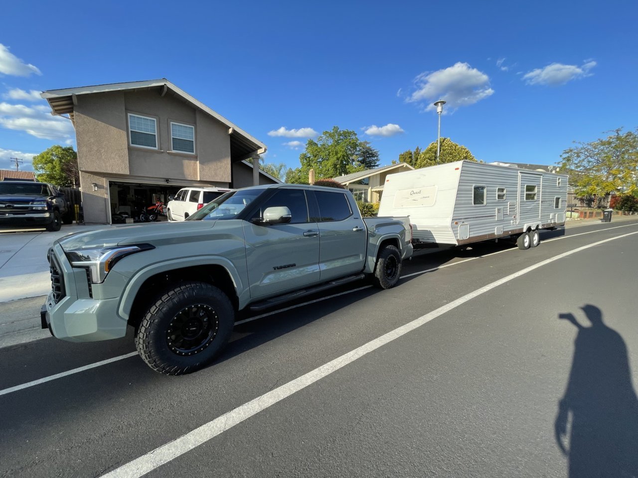

    Black out emblems, dominator d6 boards, westcott leveling kit, 17” Moto Metal rims with 33x12.5 Irok Swampers
    As of right now all that is being used is land cruiser air bags that are 1000lbs as air lift and Firestone have not released any specific kits for the 22s

    My truck set up. See post above for more info. Tow’s great!A5485E0A-72A0-47EF-8A09-8BDCF9DFA0FC.jpg

    That looks pretty damn good. The front still looks a little high to me but that could just be the wide angle of the shot.

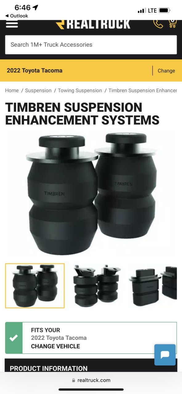

    The guys at real truck.com recommended these.
    Acedude likes this.

    this is for the TACOMA though

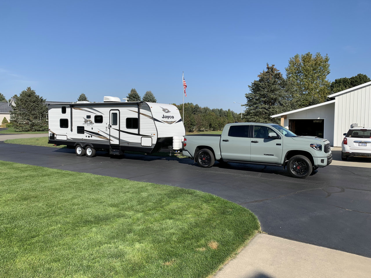

    Y’all need to learn how to setup a WDH properly. Pulled my 34’ 9k loaded TT with no problem and no bags.
    8E1B8816-8340-456A-A9DE-47ADDA1D1058.jpg C92D7487-E3A6-4514-AB71-0681B1C5470D.jpg
