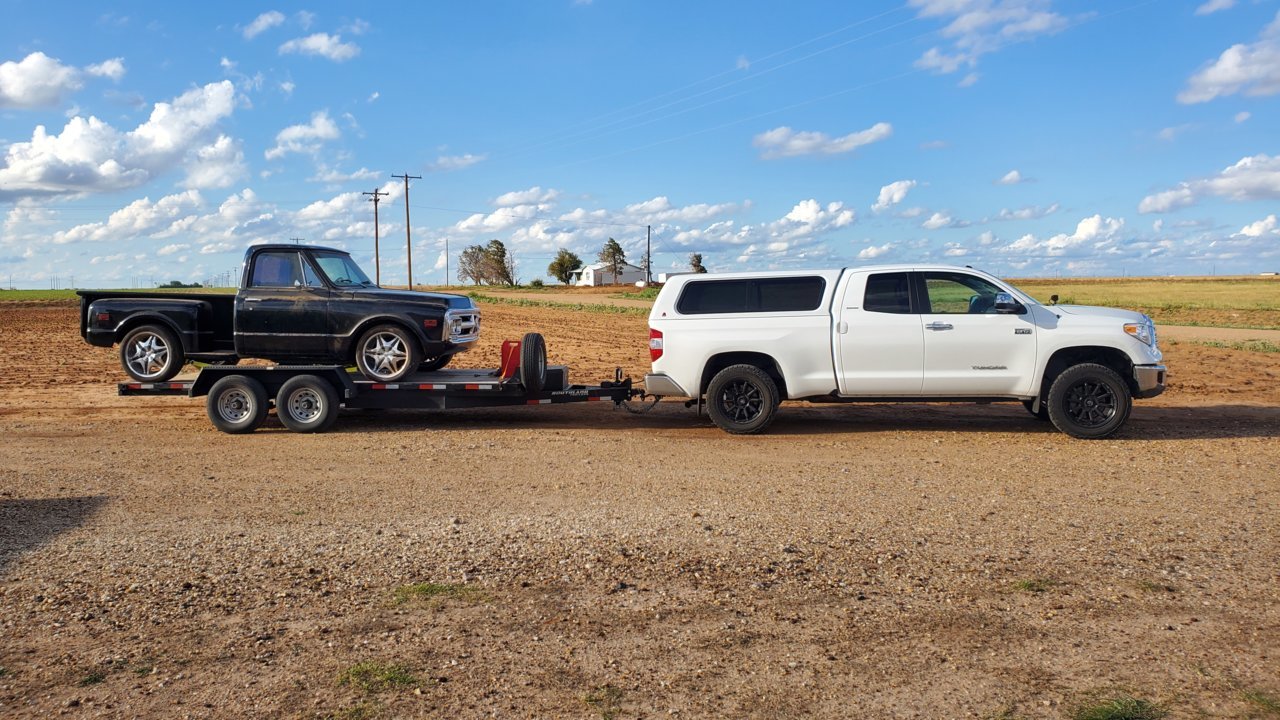

    I hear you but squatting with stock suspension is nothing new to any trim level. All 2nd gens were the same way. Toyota tunes the rear suspension toward comfort, not work.
    WDH and air bags or timbrens or RAS or new springs (leaf or coil). Many people beef it up and have no issues. How far they should go beyond what Toyota says they should is a source of endless debate here.
    I will say that I used to load my 4Runner down for trips, and when I put airbags in its rear coils, I could lower the psi down to 5 and not notice they were there.
