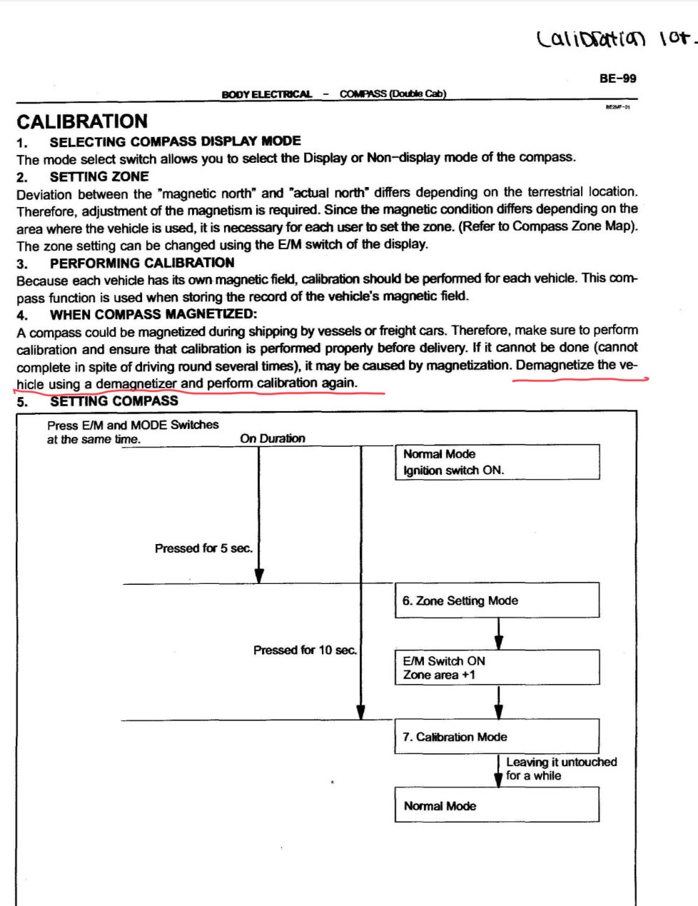

    I have retrofitted a compass/temp overhead console in my 06 tundra DC. There is power to the unit, but the compass only indicates “N” and temp is all over the place, sometimes reading in the negatives on a warm day. I have gone through the calibration procedure multiple times, but no change. Either I need to demagnetize (like underlined in red) or i have a faulty console?
    Any thoughts?

    Yes i have that, the page above is from that FSM procedure. Ive done the whole procedure multiple times, driven in circle’s multiple times etc. The thing is, it says once the temp displays, then drive in circles, but the temp wont display until your driving. ???

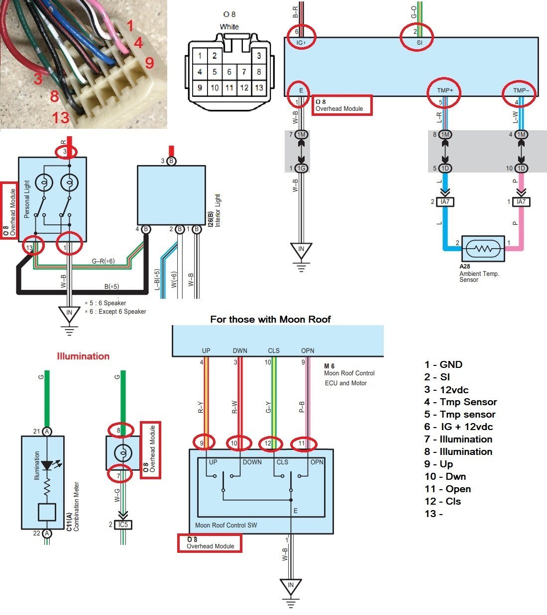

    Sounds like you may be a victim of getting a overhead console that's not using the same pinout your truck is expecting. There are a couple of variations it seems. That's discussed over here, IIRC. https://www.tundras.com/posts/2714202/
  11. May 21, 2024 at 6:41 PM
    TacticalAnt
    TacticalAnt [OP] New Member
    Mar 3, 2024
    #112985
    73
    2006 Tundra DC

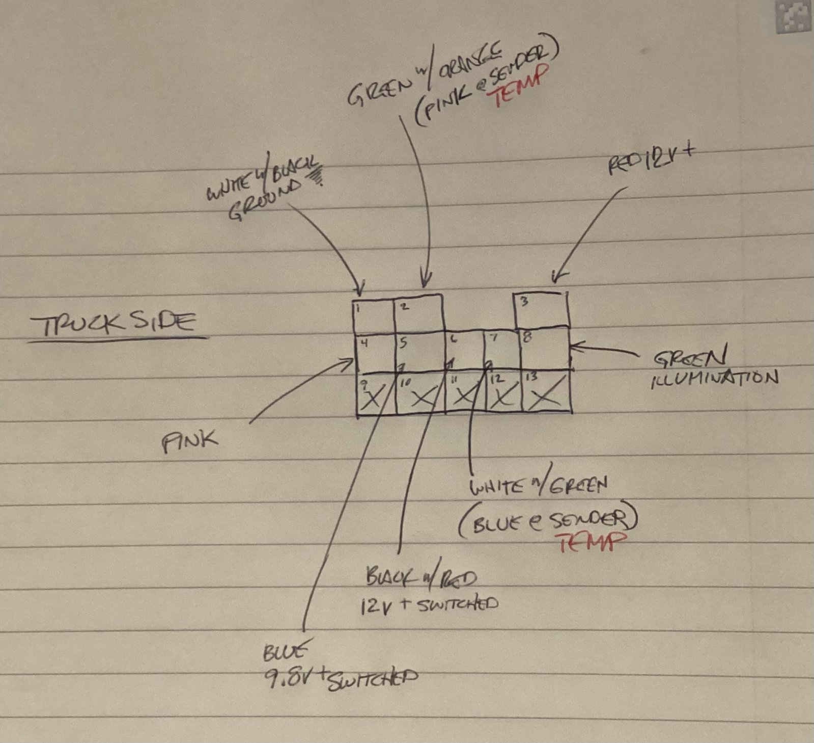

    Way to go @shifty`! Ok interesting info after checking. i went over to the link and pic and added below. I checked continuity from the sender. although the wires are all the same color and position as the pic below, my temp wires are pins 2 and 7 (#2 green with orange stripe, #7 white with green stripe) .Again confirmed by continuity test.
    So then I wonder what the pink and blue wires run? Do I understand correctly that the compass only needs a power source and a ground? I wonder if when the temp is wired properly the compass will work?

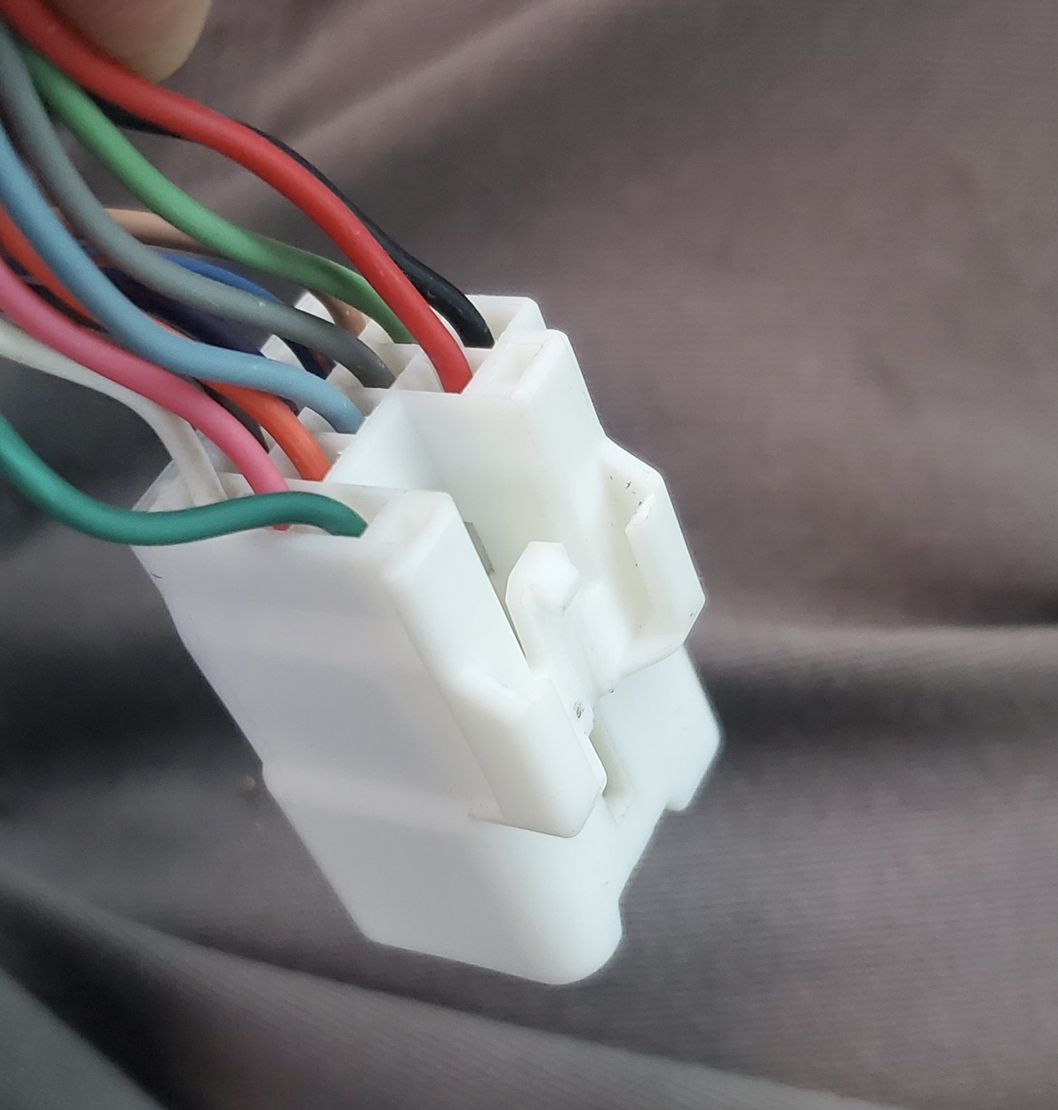

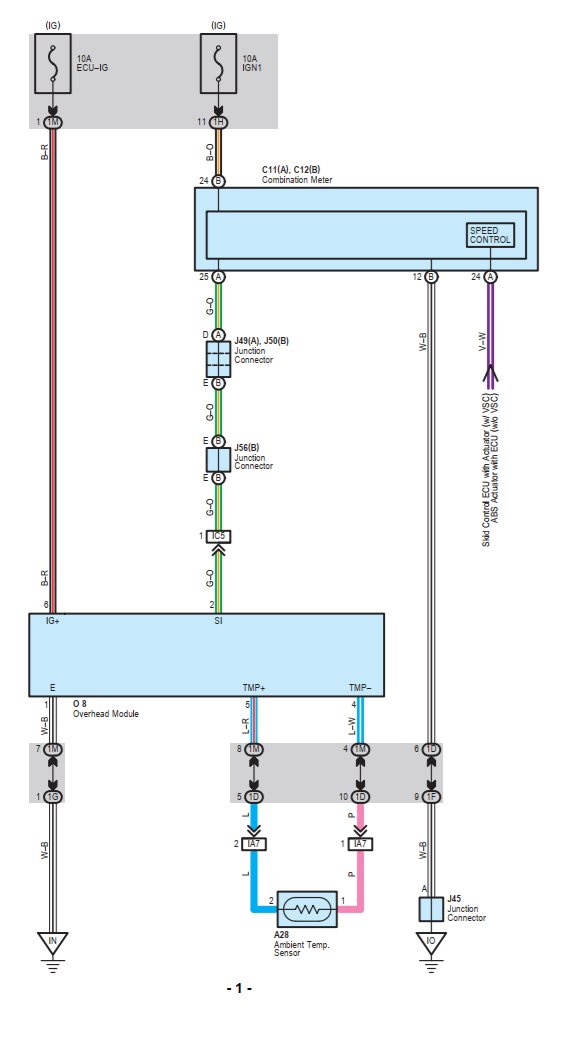

    This is what the wires are doing on the truck harness side: maybe we can get @BubbaW to look at this?
    This is the plug on the console:

    2006 Tundra DC

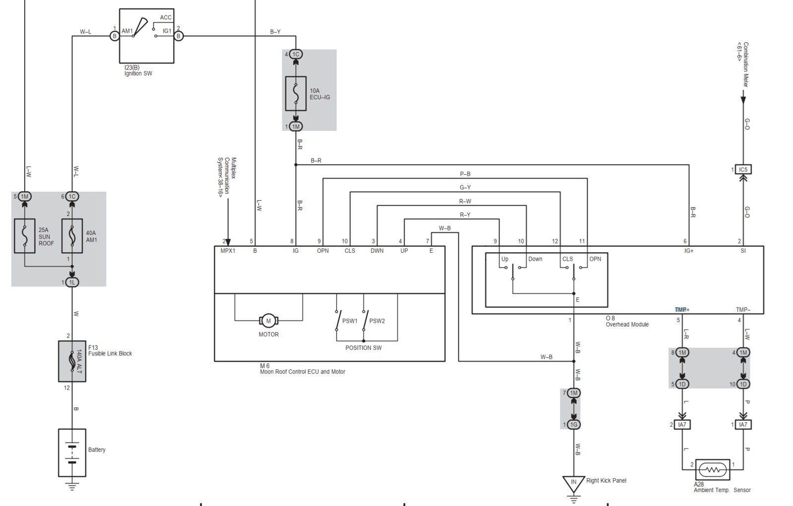

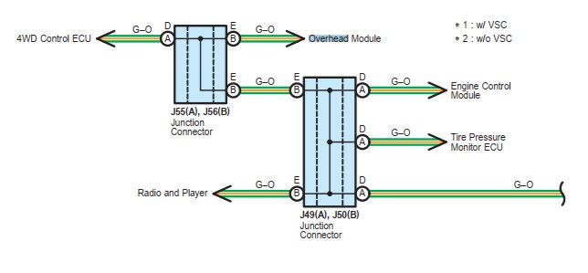

    As i study this diagram, the key seems pretty understandable, but cant figure out what wire #2 is? What is “SI”?
  14. May 22, 2024 at 4:42 AM
    shifty`
    shifty` We call it “riding the gravy train”
    Jun 20, 2020
    #48239
    29,985
    ATL
    '06 AC Limited V8/4WD
    I think the important part is to pay close attention where pin #1 is in relation to the connector, which side of the connector you're looking at, and whether you have a specialty configuration that jibes with what you're reviewing, like the sunroof variation shown. This is why I have issues with EWD, I hate reading them. If you look, you can find some breakouts for the abbreviations, either in the front or back, I want to say it's the front. Legend of sorts.
    Best guess on "SI" is it's "Security Indicator". Here's the expanded view of those diagrams, I see the line you're referencing passes into IC5 bulkhead/connector, which I think is behind the dash gauges, then the overall diagram shows it terminating into the combination meter (which I believe is technical term for the gauge cluster?)
