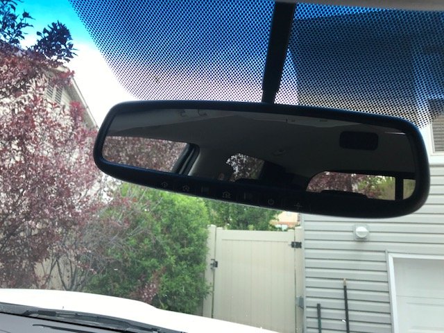

    I changed out my standard mirror for homelink/dimming/compass mirror, one of my favorite mods. Check eBay for a Gentex 453 and a long 8" Gentex extension to hide the wire:
    bleach[OP] likes this.

    Genres with homelink is 3 wires, without homelink is 2 wires. I typically just get junkyard ones from other Toyota’s with the pig tails.. super easy to wire up if you don’t already have the connector
