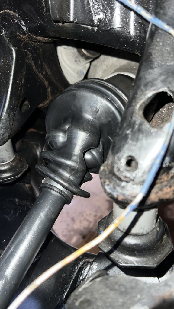

    Just installed a new NAPA Shaft Kit. While finagling it into place I noticed the boot partially collasped.
    Do I worry? Replace the Ear CV Clamp? Or move on?
    Thanks in advance!

    Remove a clamp and equalize the boot pressure with a small straw. Look at this pic.

    Looks stretched, not deflated to me

    Thanks guys! A few… a QUITE a few manipulations and rotations then it all worked itself out!
