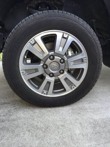

  13. Jan 24, 2015 at 7:36 AM

    Has anyone gone with a 295/60/20 with a 0 offset wheel on their 14 tundra. Looking to do this setup but need information.

    I'm just guessing here but I believe the stock wheel on 2014 Limited is +50 offset. If you go with the +12 offset your tires should stick out about another 1.5" give or take a little. Adding more offset with +0 offset will add about 0.5" to that (estimating).
    You should be able to avoid any metal rubbing as you're effectively moving the wheel out and away from the body mount and pinion. The plastic is where your worries will likely play out.

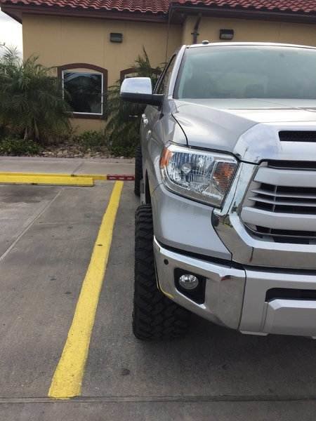

  20. Jan 30, 2015 at 3:13 PM
    1tuftundra14
    1tuftundra14 The Terminator
    Jan 23, 2015
    #899
    13
    2014 1794 edition
    7" bds lift with 35"trail grapplers with 20" fuel wheels
  21. Feb 1, 2015 at 8:07 PM
    TruckyTruck
    TruckyTruck Dumbest Username
    Jan 6, 2014
    3,618
    Gary
    That looks good man. Looks like you went with 33s? How about a straight pic to show just how far they stick out?

    Lookin good @1tuftundra14! I'm not a huge fan of chrome but I really like how the door handles compliment the wheels:)

    They stick out about a little more than 2 inches but I'm getting pocket flares so I wanted them to stick out . I went with a 305/55r20 and yeah me either but I'm kinda getting used to it. Thanks guys I appreciate it @TruckyTruck @FunkinTundra

    Here's the front pic

    Looks great. Love the wheels. Your tires definitely stick out more than mine.

    Looks awesome, so what was the offset you ended up with on this setup?

    Thanks guys. I got the +1 offset 9" wheel with 305/55r20 trail grapplers. My truck didn't come with stock black it came with the silver stock wheels.
