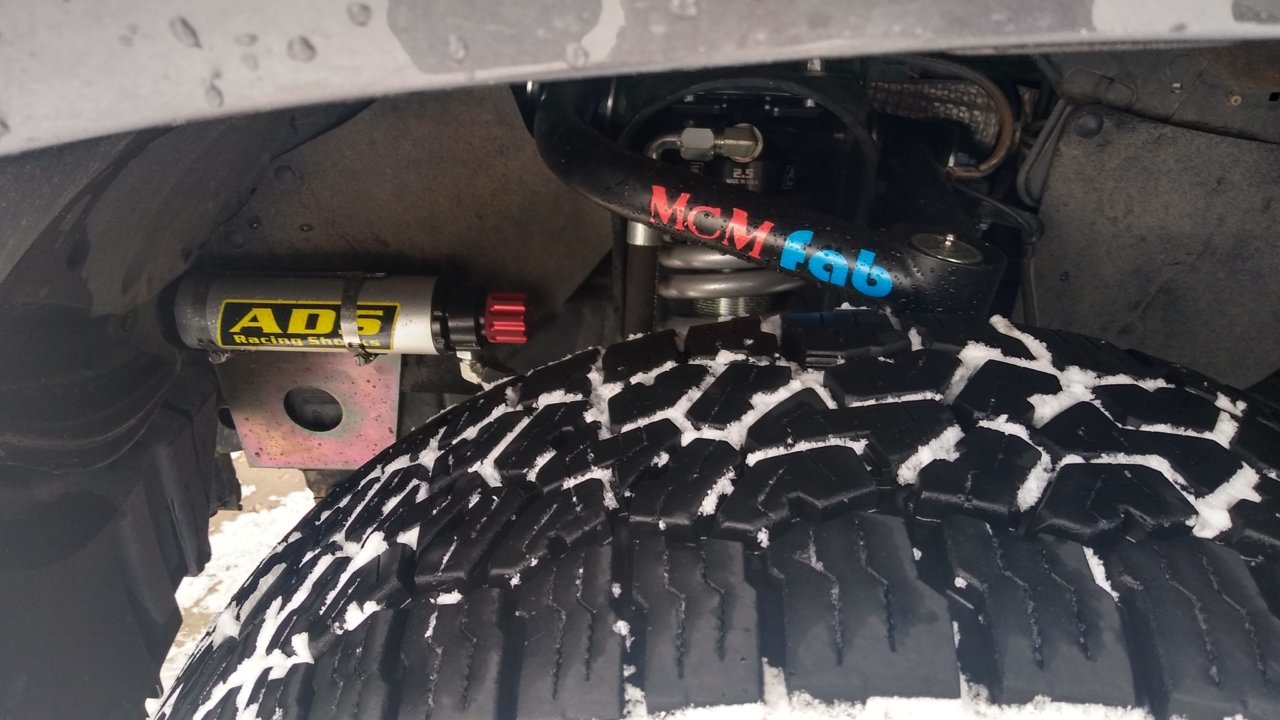

    Magnuson 2650 w/76mm pulley, ADS suspension, 35's, misc overlanding bro-trophies
    I just put ADS 2.5's w/ clickers on my truck and initial impressions are good. The only thing I'm not crazy about is how the front resi mounts. They are very close to the tire at full lock, which kinda ruins my plans to upgrade to 35's. I think the way the Icon resis mount like in the post above would be better. Something to keep in mind if you're still on the stock wheels. IMG_20210124_154249697_HDR.jpg

    @ADSracingshocks - F 3 point ohh / R 2.5 - w/clickers @camburgracing - uniball UCA @rigidindustries - 40" amber/white split, Dually XL, D2 @coopertires - 35/12.5/17 STT MAXX @bayareametalfab - low pro bed rack @toyotausa - 17" rock warrior @sdhqoffroad - rock sliders, a-pillar @hondogarage / @apple / @gaiagps / @dualgps- navigation @wheelersoffroadinc - superbumps
    25mm offset, 35x12.5 and I have no clearance issues myself.
