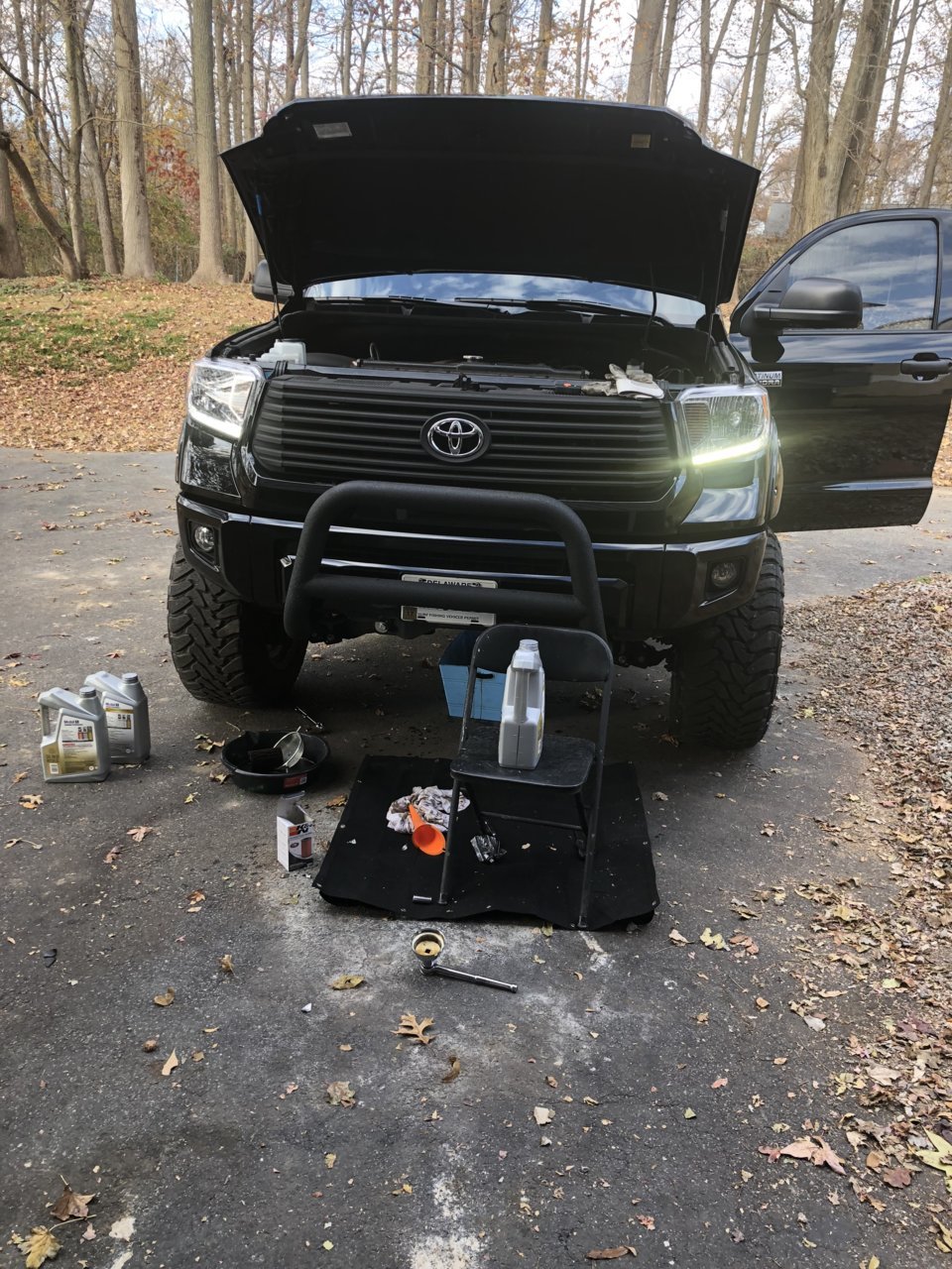

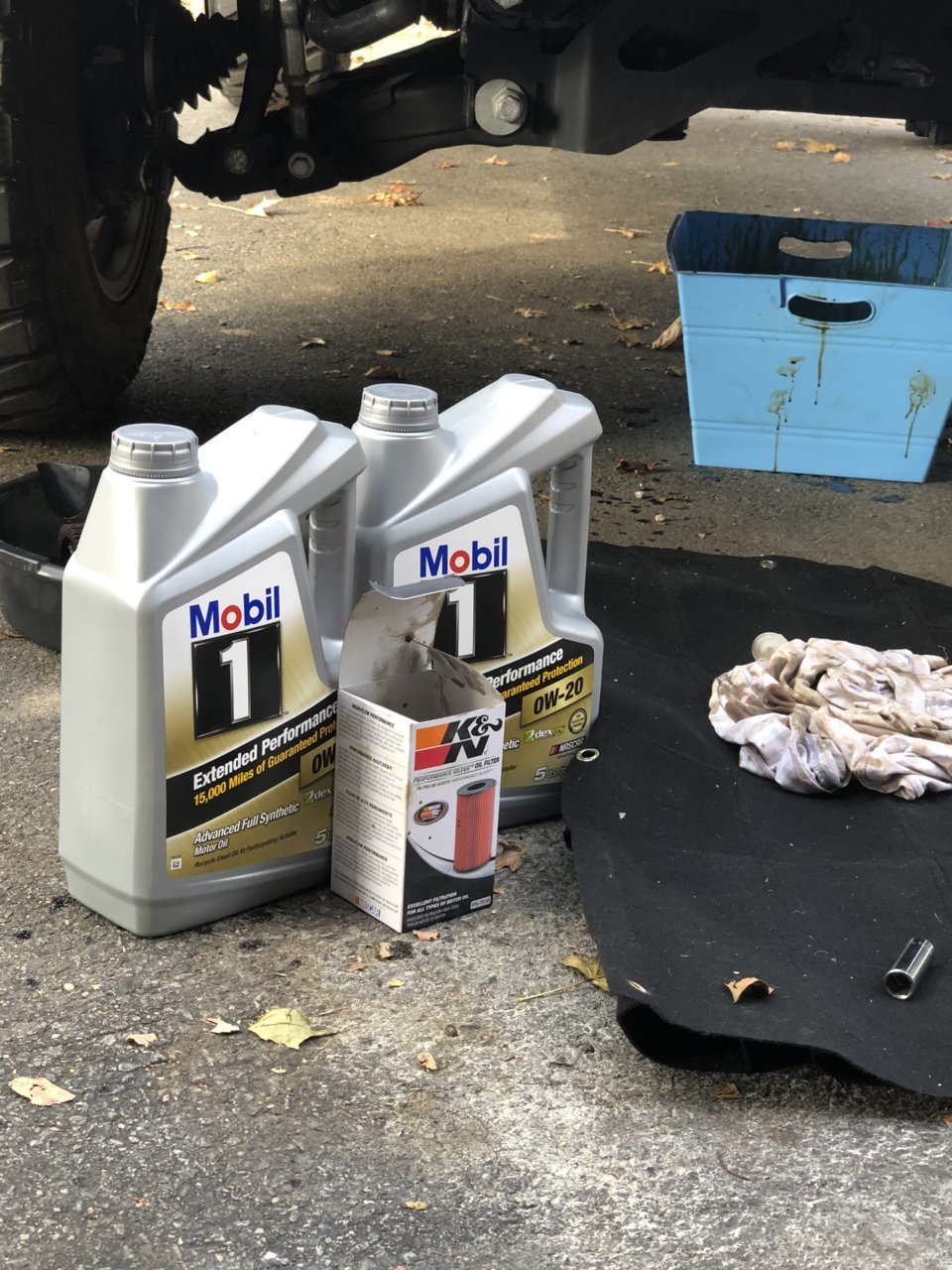

    2016 Tundra platinum
    Clifford Alarm, 7" BDS lift with Fox coil overs, 20x12 with -44 off set fuel Mavericks , 35" TOYO Open Country Tires , Bush Wacker pocket fender flare ,2" rear Leaf springs, Bull Bar,
  16. Nov 30, 2017 at 12:02 PM
    #46
    50,809
    How's that k&n oil filter ?
  17. Nov 30, 2017 at 12:04 PM
    #47
    CJ21
    CJ21 CJ-21
    Aug 21, 2016
    #4262
    979
    DELAWARE
    I like Seems to work well...K&N website $8 so I get 2 at a time anything over $10 is Free shipping.

    Little plastic comes in box with filter to drain filter..
