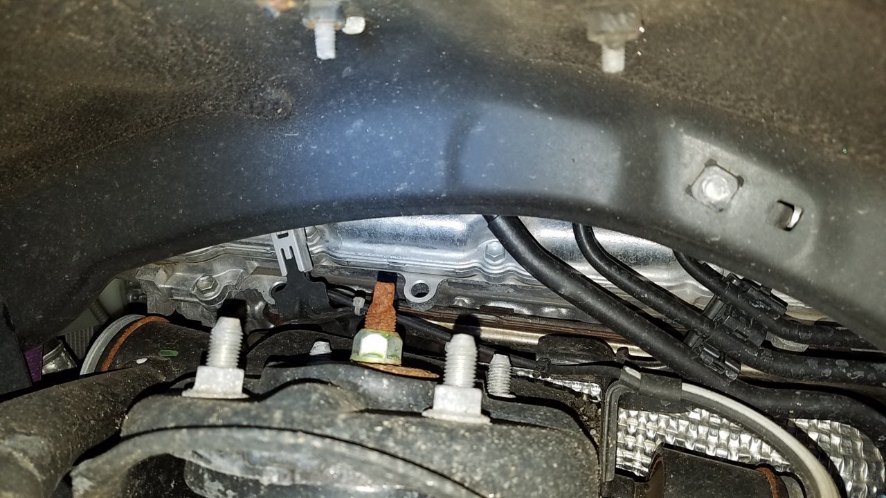

  13. Mar 21, 2018 at 8:35 AM
    Pudge
    Pudge [OP] Super Secret Elite Member #7
    Nov 8, 2016
    #5136
    9,498
    Sean
    CT
    2015 Blue Ribbon Platinum
    Driver side.
    I don't see any leaking here

  15. Mar 21, 2018 at 8:38 AM
    Pudge
    Nov 8, 2016
    #5136
    9,498
    Sean
    CT
    The tech noted it looked like it was coming somewhere in the middle of the engine. Dripping onto exhaust. I've never smelled oil burning, except today of course after I drove it off the lot, but whatever was on tgere burned off. Probably from the oil change today.
  16. Mar 21, 2018 at 8:46 AM
    15whtrd
    15whtrd Mr. Blonde
    Sep 20, 2015
    #1829
    9,387
    Sean
    SoCal
    It is easy to pour oil too fast and cause it to spill a little. It will immediately run down the side of the valve cover down onto the exhaust. I know from personal experience LOL
    Pudge[QUOTED][OP] likes this.
