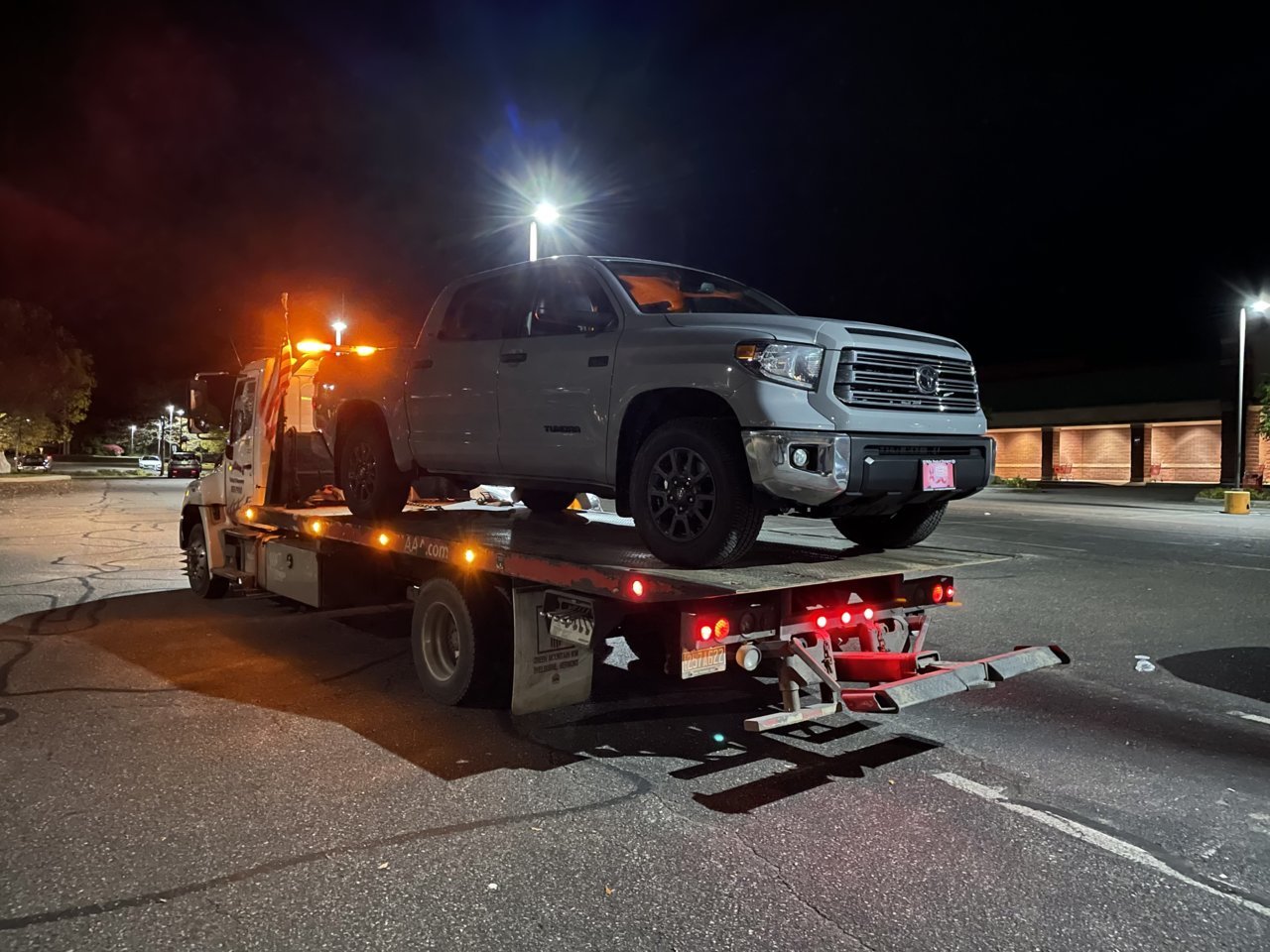

    I had it for two days, and took the wife out to dinner. While parking the truck, we heard a loud bang/pop from the front of the truck. It wasn’t gradual, just all of a sudden no power steering. It was all I could do to get the truck parked, it was that hard to steer. Engine ran fine, but no way I was going to try and drive it that way, not in town.
    I won’t get into Toyota “roadside” issues…. but get AAA.
    They said it blew out the seals in the rack and the fluid filled the boots. They ended up replacing the whole rack.
    249 miles on it at the time.

    Wow! Sorry that happened to you but while parking isn’t the worst possible time I guess… Do you know if it was an EZ one day fix or did it take forever to get it completed at the dealer? PS Good looking Cement Trail Edition
