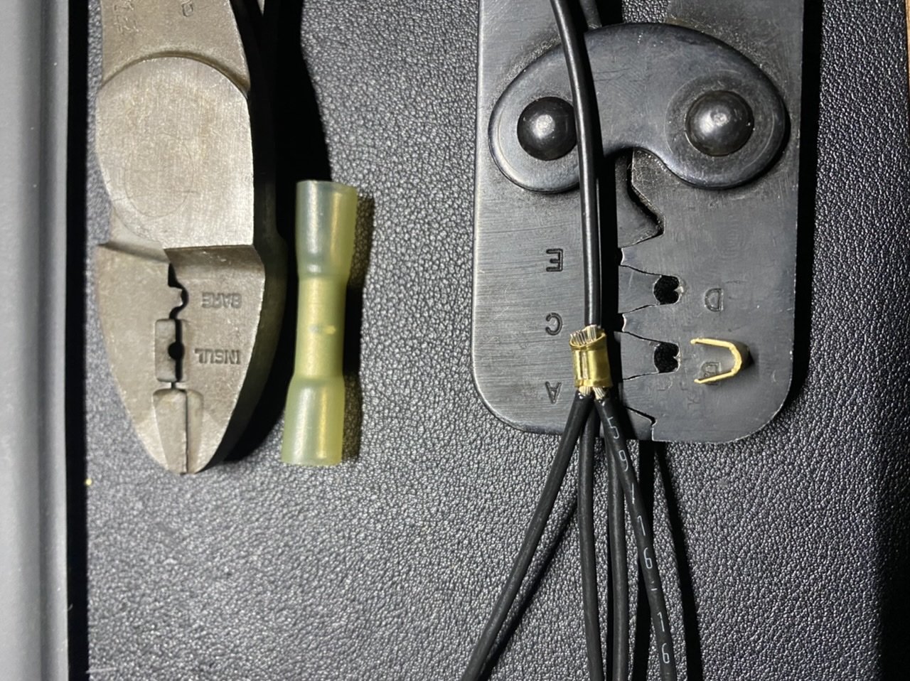

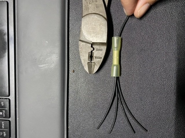

    I don’t keep many of these heat shrink butt splices as I am not a huge fan of those so just a mock up indeed, but for the open barrel splice that is a completed in-insulated termination, along with the tool die and an new Open barrel splice.

    Thanks! This is SUPER HELPFUL!!! Where were you when I was getto wiring my lights last time! My plan is to rewire my ditch lights since I may or may not have used a wire nut....

    Also, in a properly crimped termination, the wire will break before the termination point will…very much like a proper weld is stronger then the base material that is being welded, assumption being proper system parameters are in use (conductor, connector type, connector sizing, procedure and tooling)

    All I do for work is electrical wiring on commercial trucks. Everything is always butt splices with the exception of 6 gauge and above up to 4/0 then it is a compression crimper with lugs for power and grounding of the truck. The hand crimpers are tested twice a year too make sure they make a good strong crimp without crushing the wires. We have small torches to shrink the butt splices but when you only are doing a few a Bic lighter is more then enough heat. Myself, I would never use a Posi Tap do to its lack of weatherproofing. I have had to take out some of the splices that have been shrunk down and you will pull off the sheathing of the wire before the plastic of the butt splice.
