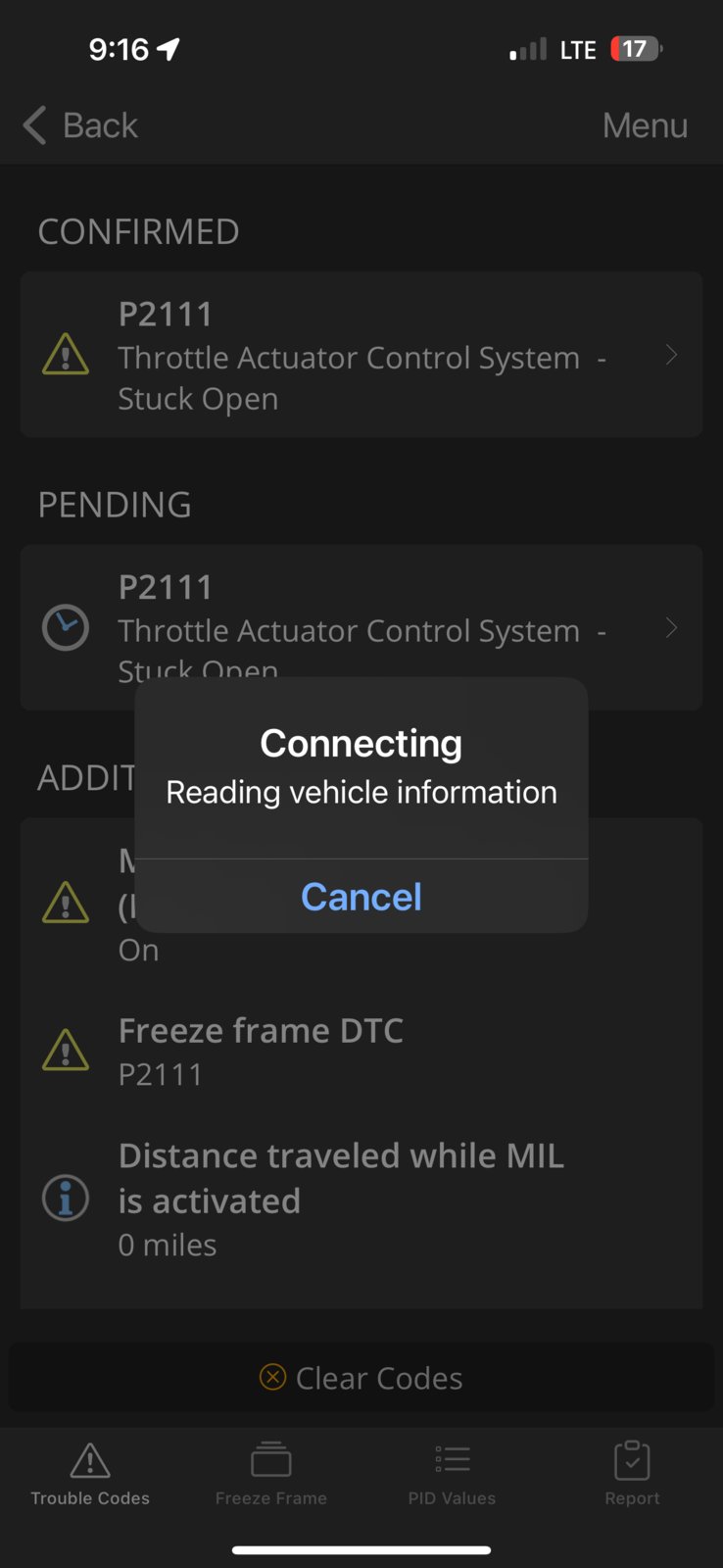

    I had a brain fart. It wasn't the check engine, but rather the maintenance required light. I haven't timed it, but it blinks for way too long.
    Also just went out to test to be sure we had the ABS sensor issue resolved which it does appear to be. I'll try all the low-speed test and then realized I should do a higher speed stop
    this time it was the check engine light as I was stopping. It went into safe/limp mode for the first time ever. P2111
    Had to clear the code with my OBD app to get out of safe mode. It did not come back on, but I also did not do another hard stop.

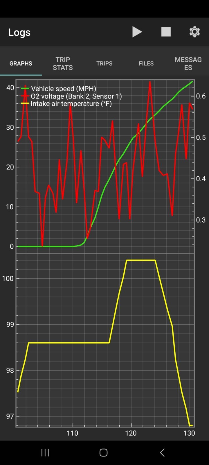

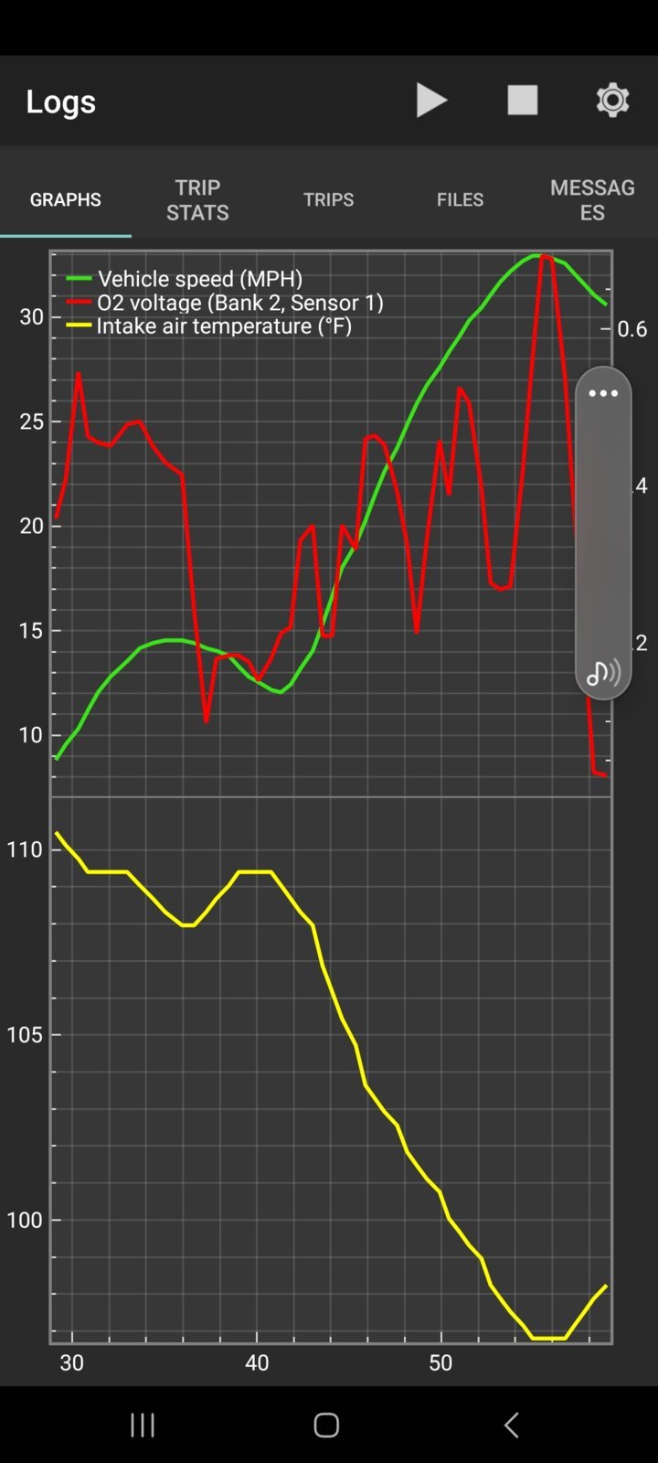

    Whats the countdown to your trip? Sounds like you pulled it off w shakedown time to spare.
    Fyi, i will dyno my 02 ( throw stock 265 tires on) , i will have a different set up ( x pipe, hidden tips) and not make the power you vtec guys make lol. And 0-60 in 6 SECONDS? , damn. Thats impressive, i may be getting old
    ..i remember looking on back of CAR AND DRIVER , low 7's=fast, 6= really fast, 5= i cant afford the insurance fast lol. Could anybody log their iat and post? It was 98* here and sitting on RT 97 IT WAS hitting 140* heat soak at dead stop. ( AC cranked , 2 mile long mess if idling cars)
    As soon as traffic clears us , the factory airbox w my crappy ram air mod gets it down to right around ambient. When i stick my hand in front left wheel well its cooking w fan blowing hot air off pass exhaust heat shield. Trying to figure out if my air box mod ( located next to pass headlight is helping or hurting) def lowers iat's above 40 mph. I have a stock box to swap in. But contrary to info on here, the truck does not feel like its breathing through straw anymore.

    6.1sec without VVTI or a tune. But it was like 50° out that morning.
    I monitor my IAT with my scan gauge. What app did you use to make that graph?
    My scanguage can't do that!
    With Volant intake, which has its own airbox, temps get really hot at idle with the headers. I've seen it hit 140° at a light before. But it's also like 100° in TX this summer.
    Once I get up to 60+ mph for a few minutes, it gets down within maybe 3° of ambient.
    I have plans for a hood scoop that would plumb into the top of the Volant box.

    Dont want to high jack thread. That graph is from OBDLINKmxpro . I stole a stock bottom half of airbox from a 01 SR5. IMO, YES , at low rpm the struck feels bottlenecked with stock airbox set up. So, i would disagree with the theory the stock air box is not a restriction. No hard data to back it up but it gets better fuel economy by about 2mpg and downshifts less. I dont need a dyno to know it works. I just use cap that " plugs" on to seal if I ever plan to nosedive it into deep water which i do not. I will say, people here are correct when they say our trucks dont like the K&N filters,
    Made my truck idle low until i switched back to oem.

    Yea you can see the correlation between sitting in traffic and getting truck up to speed pretty clearly.

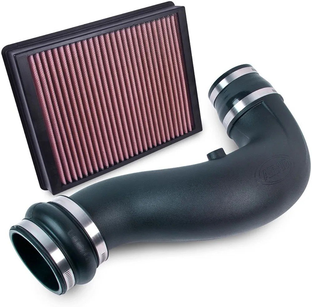

    Yeah cutting an extra hole in the air box is a good move for more air flow. On Tacoma World they use a deck plate from a boat to get the same effect as you and can close it when necessary. "Deck plate mod".
    I've seen references to a "stock airbox mod" but I haven't seen it myself. I suspect it's basically the same as what you did.
    Another similar mod I've personally used in the past is the "swiss cheese air box mod" on my Ranger.
    One last tidbit you can do for a better flow and a little noise is cut off all the baffles and resonators from the intake tube and seal them so it's smoother.
    I use the Airaid modular intake tube with stock air box on my 06. K&N also has a similar tube, I think it's called the "junior" or something.
