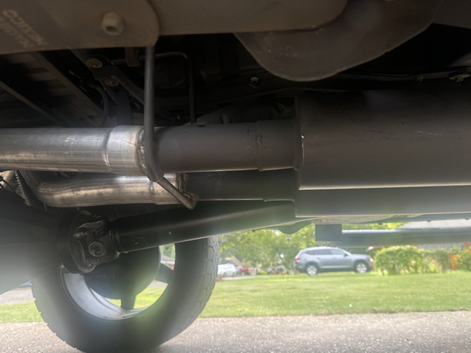

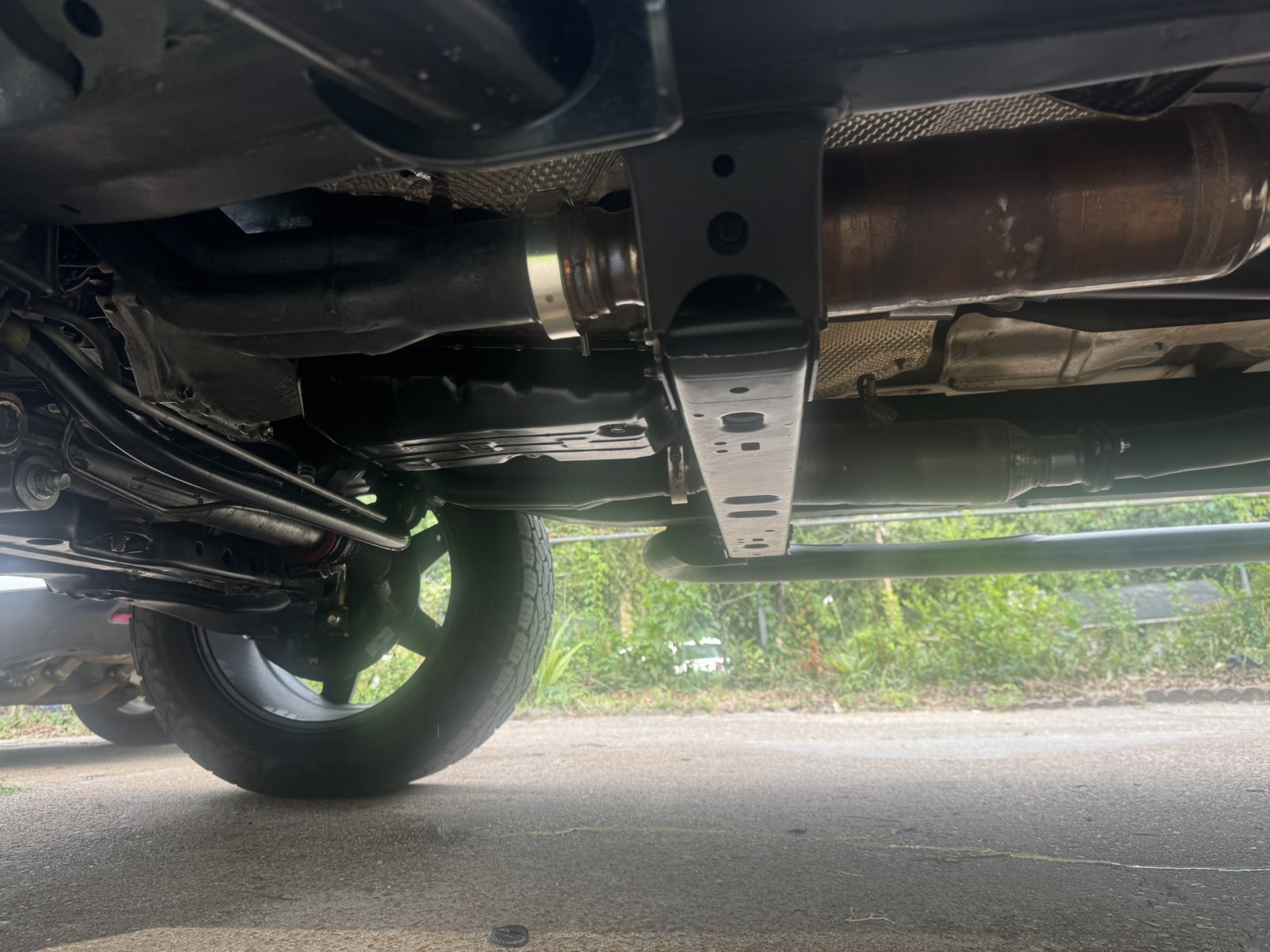

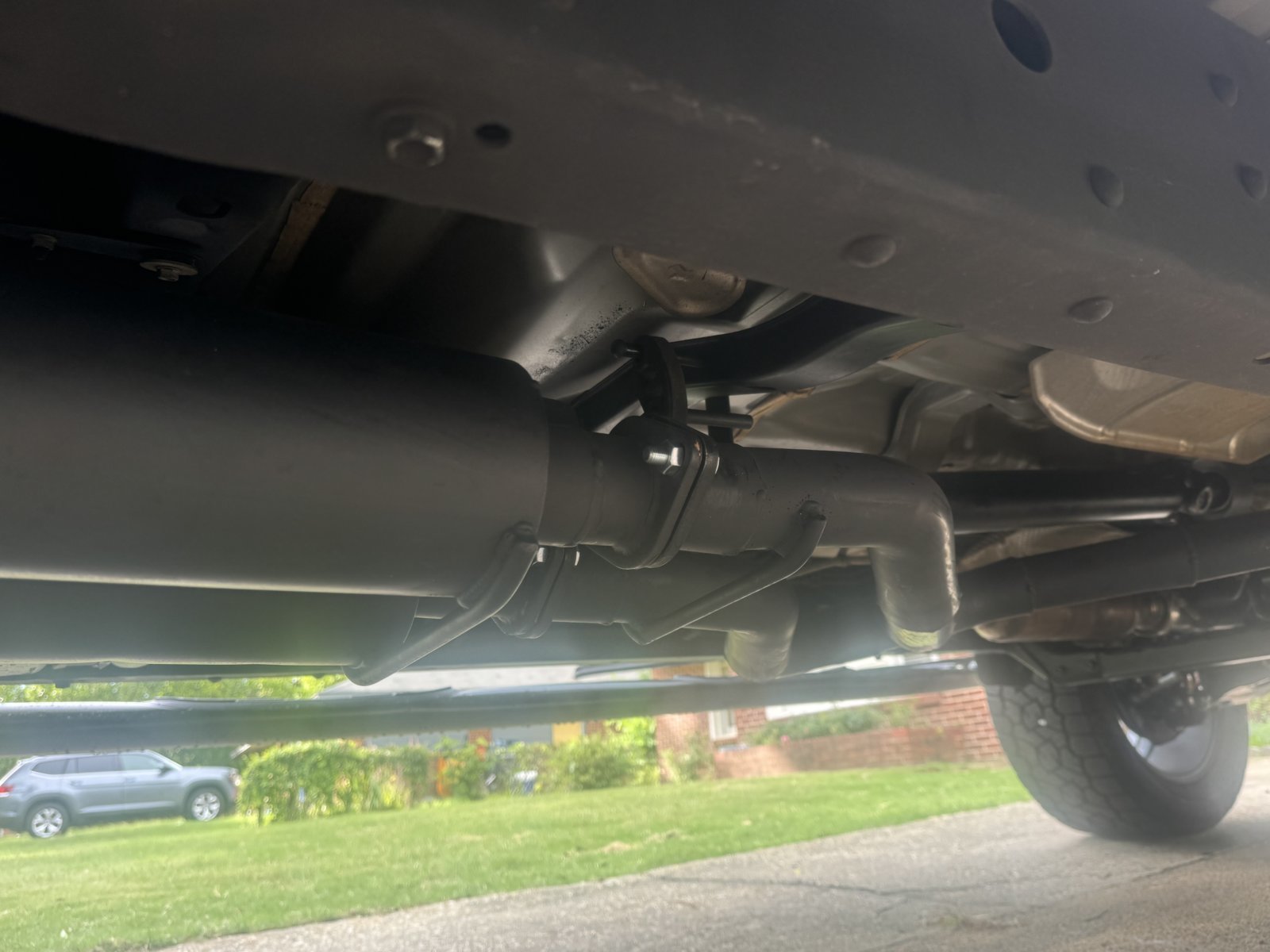

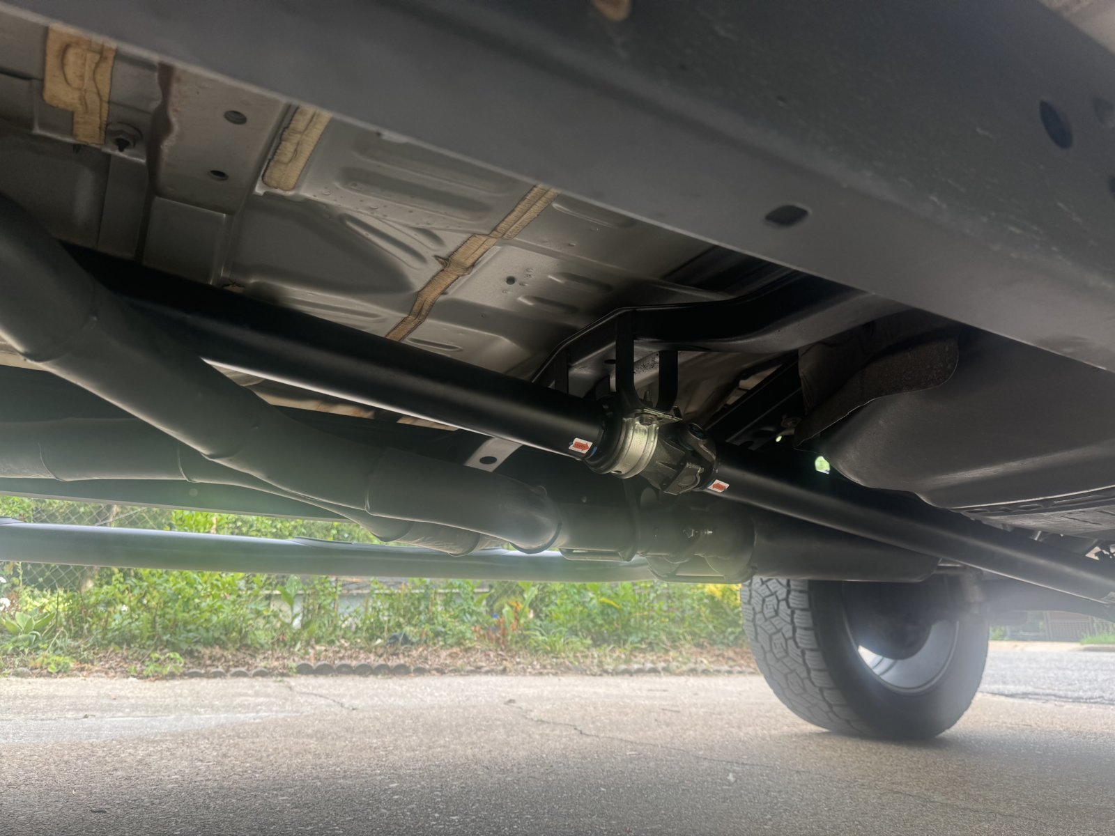

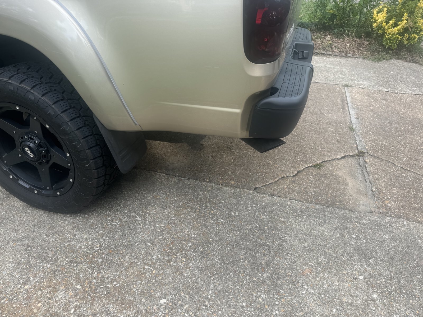

    not happy with this I told him to do it like the factory pipes, about a 45 degree angle behind the wheel - both driver and passenger sides, not at the bumper.
    Pissed about this. I told him this was to be a bolt on system. If there were issues to contact me. He didn't seem to want me to be up there watching him so I respected that. Then he inexplicably cut off the flanges on the rear side of the mufflers. I don't guess it matters as long as I'm content with this muffler and resonator. But damn

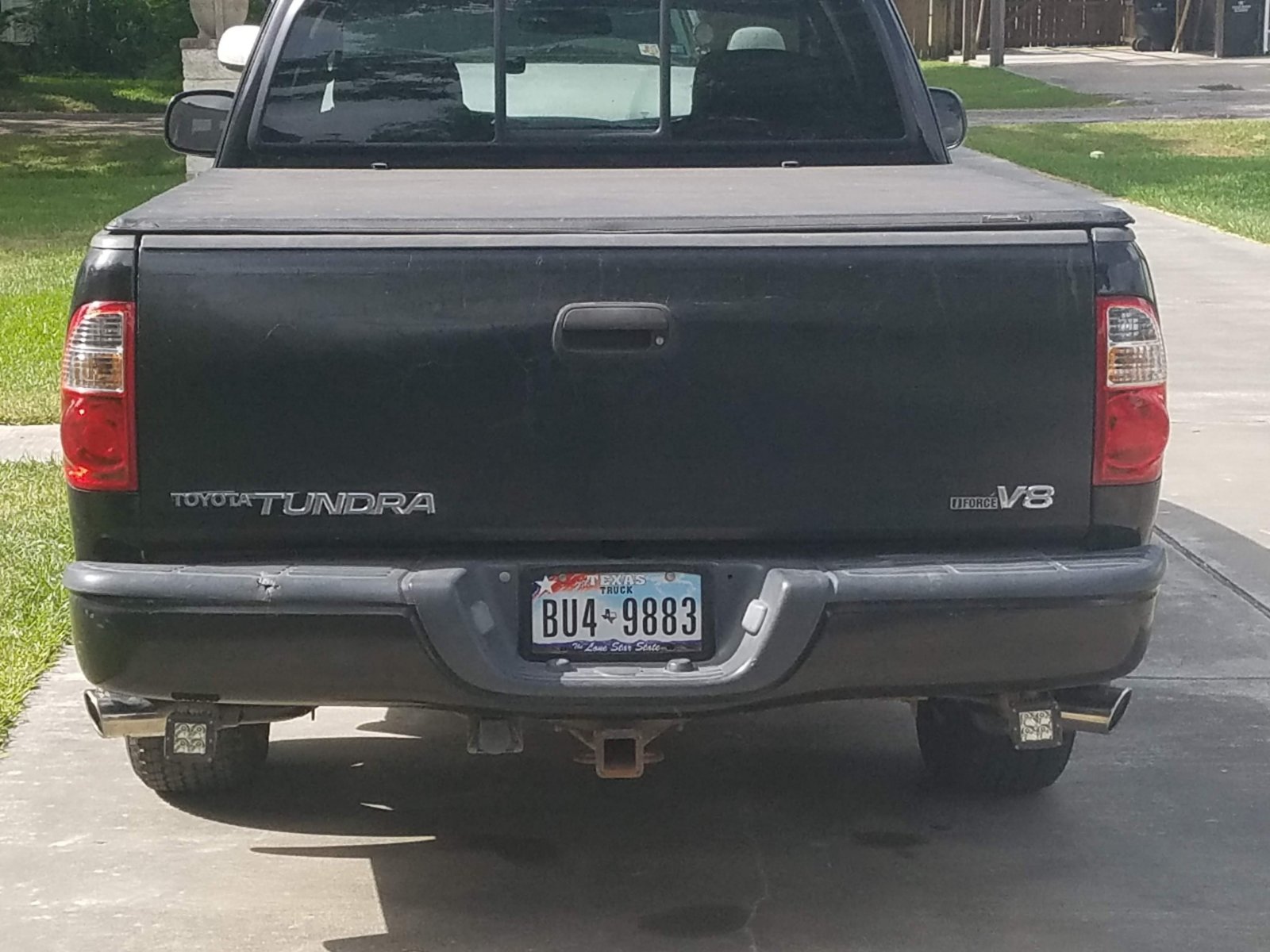

    I like the exhaust placement, but I may be a little bit biased.
    My 03
    Weagle[QUOTED][OP] likes this.

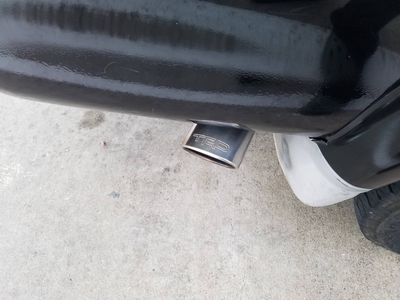

    Sounds like the way you want it done is actually how this truck came with the TRD catback. Let me see if I can find an old pic.
    I had to change my tail pipe placement, because I lowered the rear 4 inches and the tail pipes would have contacted the leaf springs.

    Really was just expecting it to be like my factory set up was on the passenger side, but with black tips and One on each side
    It may grow on me. I'll give it some time.

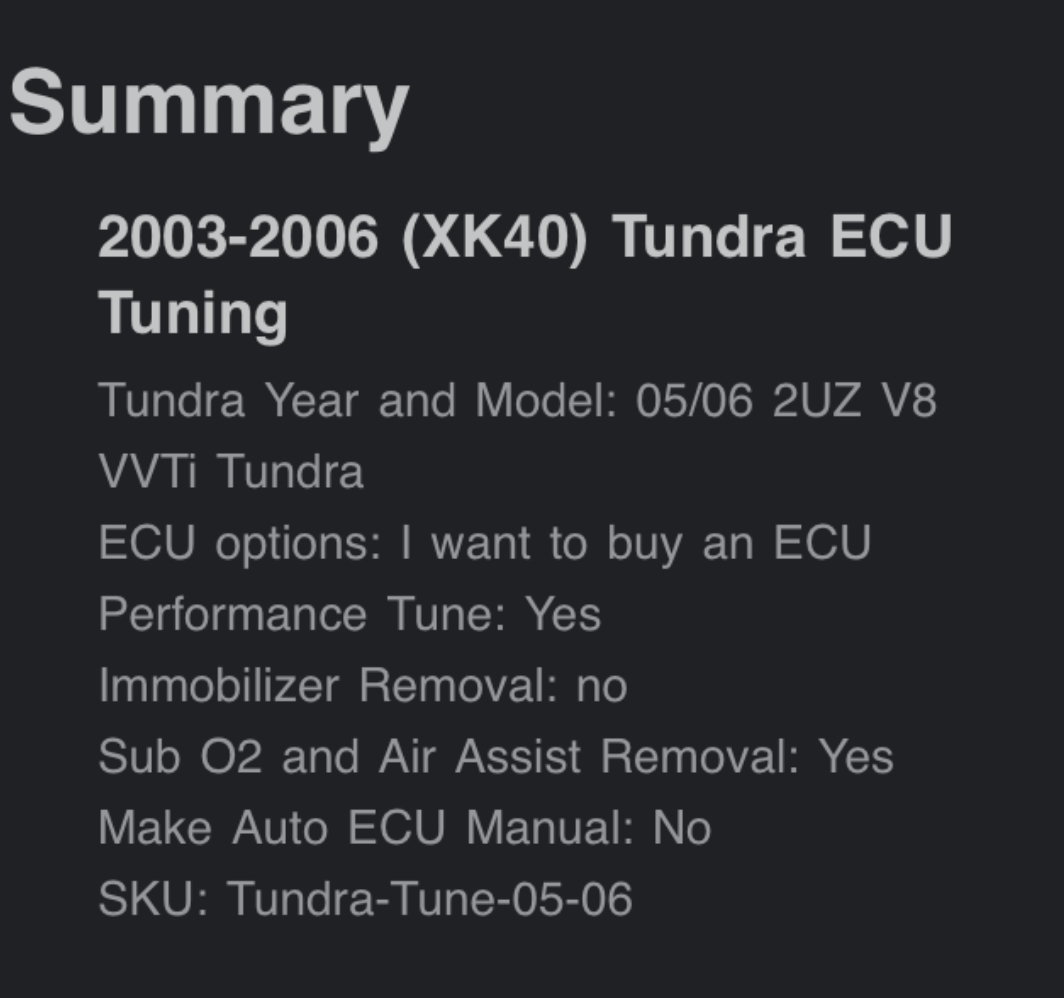

    @Weagle sorry if I already asked you this before, but did you pay for the immobilizer removal on your ECU?
    Weagle[OP] likes this.

    No, I was told it was not needed on mine
