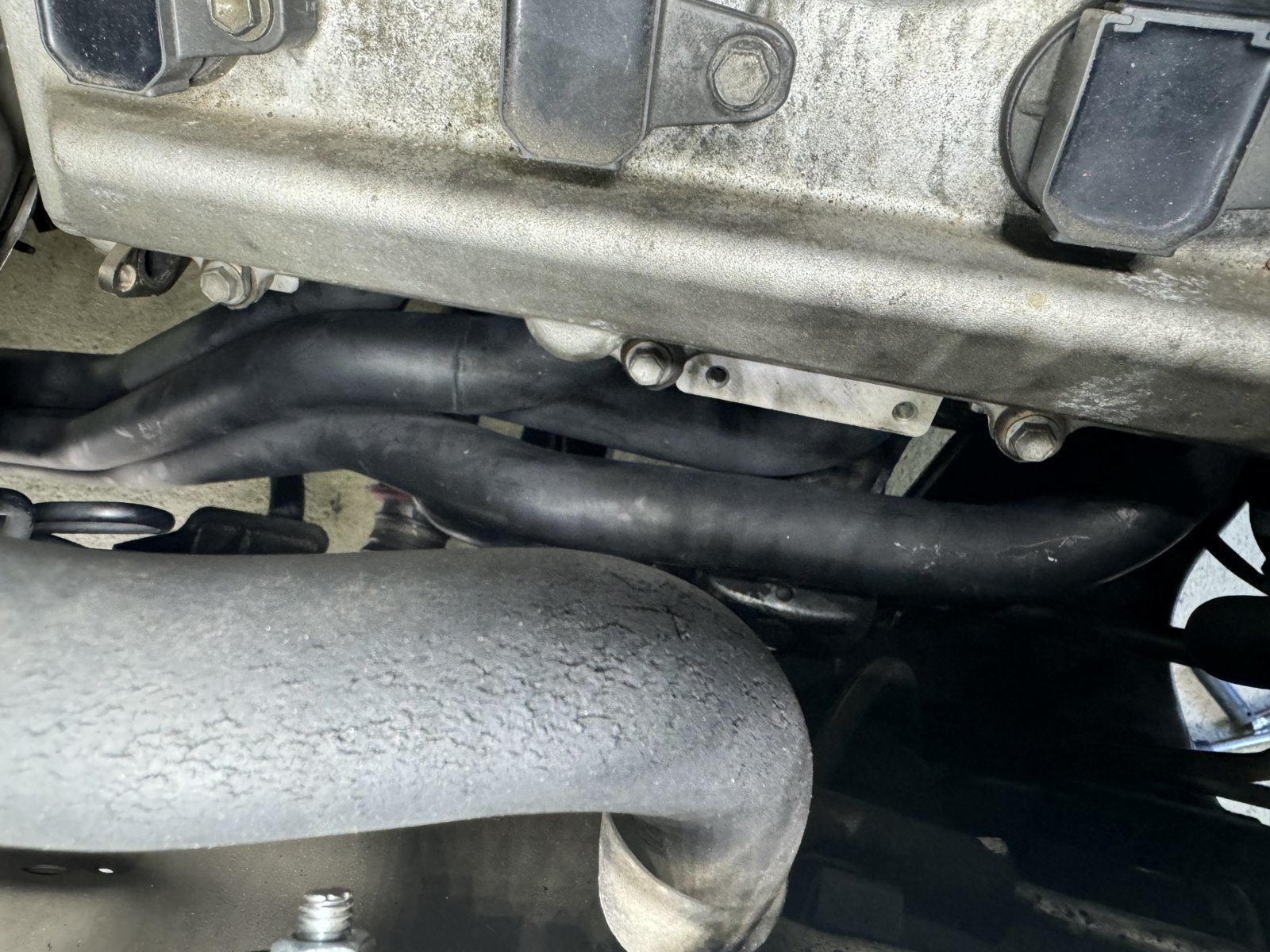

    Just pull my truck around to the front of my house. Man that things got a wonderful deep sound once it drops down to regular idle rpm's

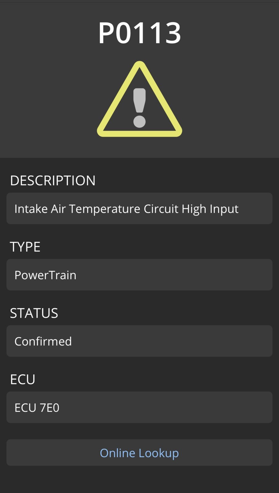

  23. Jul 9, 2024 at 1:40 PM
    #173
    Weagle
    Weagle [OP] I survived my timing belt change
    Sep 24, 2023
    #104402
    1,077
    Prattville, AL
    2006 Tundra SR5 DC 4.7 2WD LSD towing pkg
    Bilstein 5100's with 2883's - close to 2" Replacing the 2883's and going back to the bottom perch ASAP -mobile/apple play stereo with sub and backup cam -Power stop HD front calipers and rotors for towing -20" wheels with 32" tires (305/50's) Toyo AT 3's with no rubbing -Westin nerf bars -Detroit axle new (not rebuilt) steering rack with poly bushings, inner and outer TRE's -Suspension Maxx extended front sway bar links -Overland tuning - medium level -Power front leather seats and steering wheel from 06 Sequoia -fully de-chromed/blacked out trim -all light housings incl 3rd brake light and tag lights replaced with smoked lenses, LED where appropriate -mini projector headlights -fully rebuilt trans and new torque converter -new complete drive shaft with spicer u-joints and carrier bearing -all LED interior lights including backlighting -new lower window seals for all 4 doors -all new hardware and clips for tailgate Next: Dirty Deeds racing exhaust with LT headers, yellow box, 12 hole DD fuel injectors, redo or replace door panels

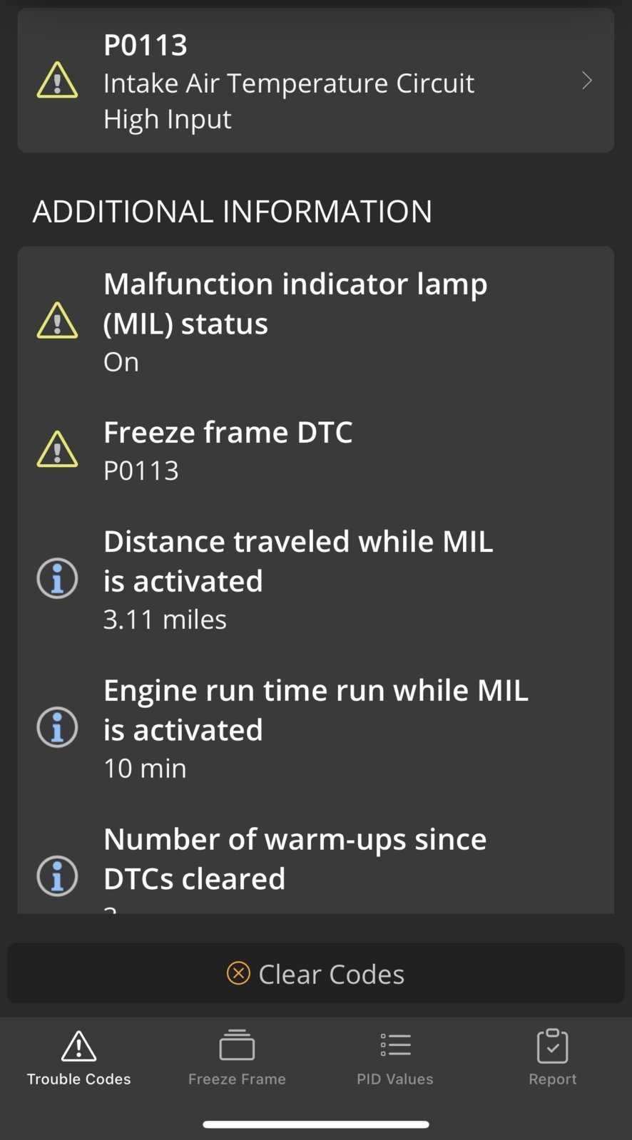

    The good news? I love the sound it is perfect. The muffler guy fell in love with the mufflers and the system.
    The downstream O2 sensors or too short, the extensions from Underdog Racing did not fit - not sure if they were for Upstream only
    and I'm getting a P0113 with the engine light on the check into flashing occasionally
    I don't see anything to indicate that would be related to the downstream O2 sensor. My harness is bad for the upstream O2 sensor.
    also getting a rough idle, which is one of the symptoms for that code apparently
    Keep in mind this has a different ECU than my stock before the header upgrade. the exact same part number that has been programmed for the headers and performance

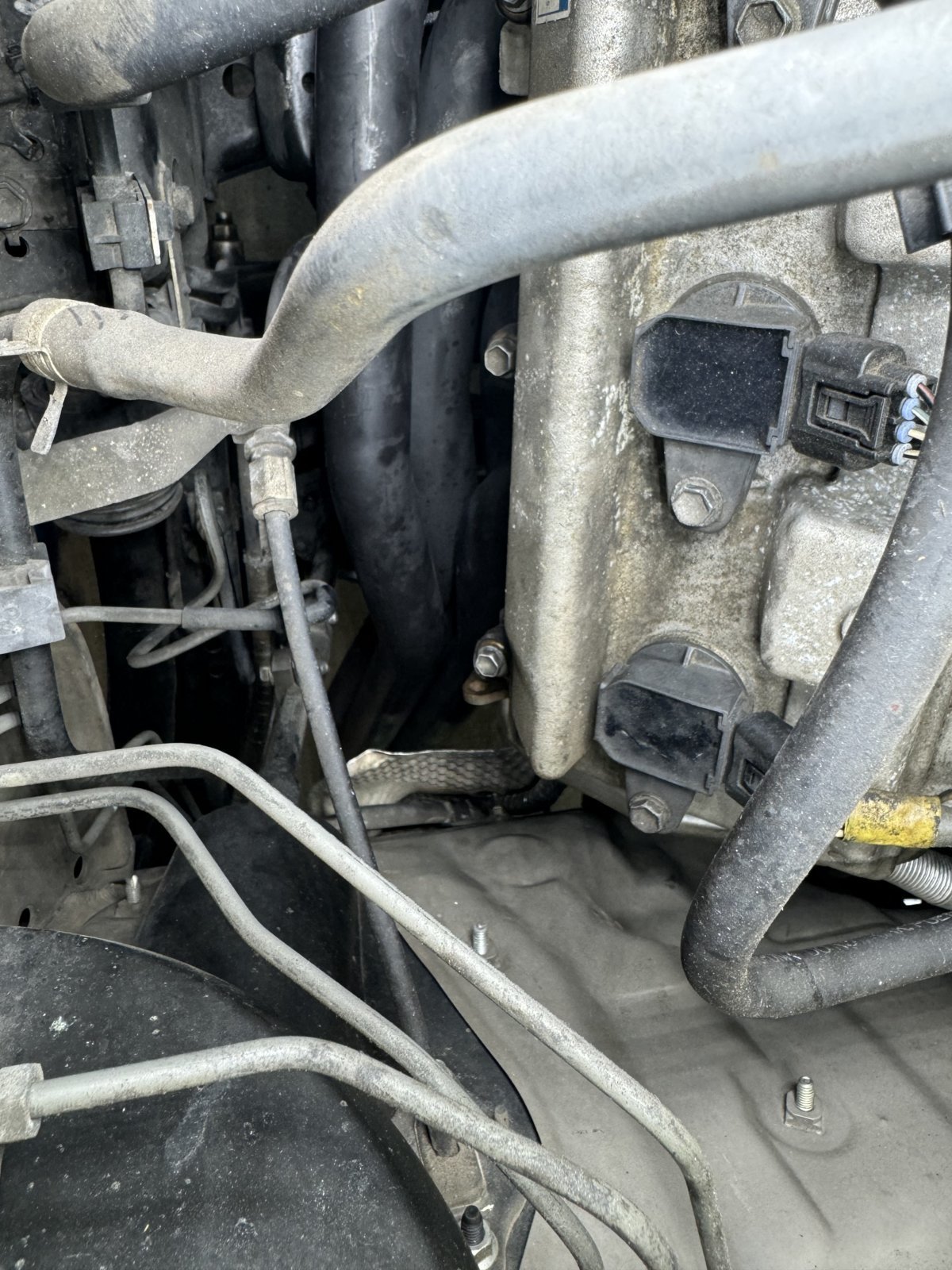

  24. Jul 9, 2024 at 1:57 PM
    #174
    Weagle
    Sep 24, 2023
    #104402
    1,077
    Prattville, AL
    Was simply a vacuum tube that feeds right by the mass airflow sensor
    All seems to be good now
    Panic mode averted
