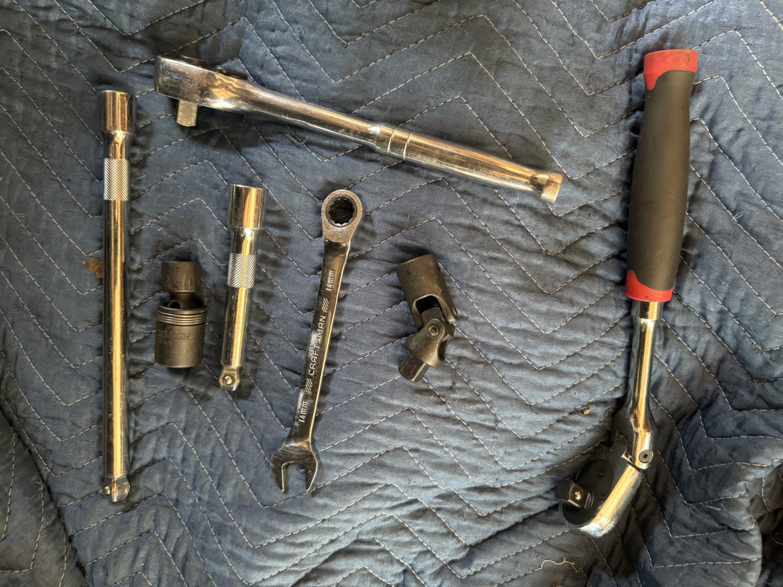

    I did have to use a few more swivels installing the header. 14 mm socket and ratchet wrench
    this is every tool I needed to install the header (only) on the driver side. The swivel headed ratchet wrench on the far right I only needed to remove the old exhaust manifold.
    The same was true for installing the driver side header and removing the exhaust manifold. All of the top nuts I accessed through the access behind the two splash guards that I removed
    all the bottom nuts were access from the bottom
    One good thing about using an engine hoist, it was really easy to make slight adjustments to the height for easier access for the manifold/header in all of these tight spots

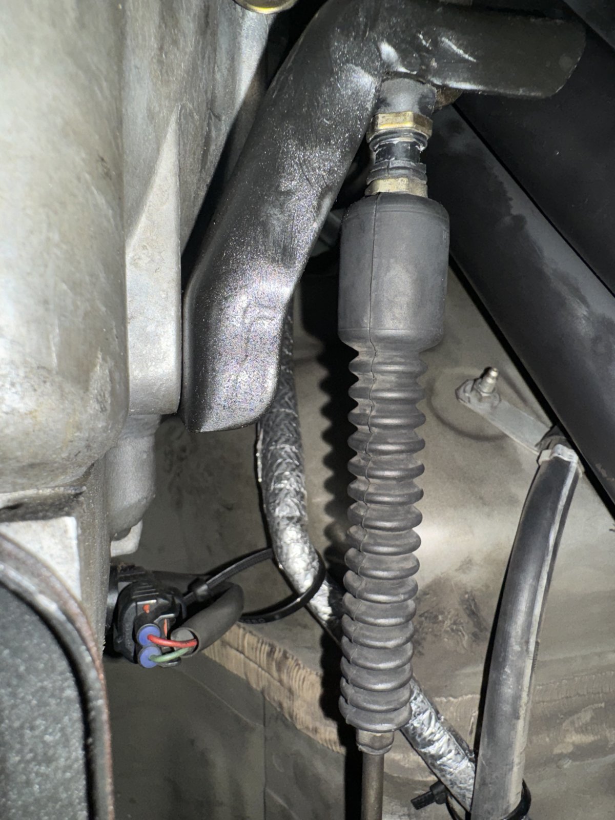

    topside of driver header installed - still have motor mount, including the cable attachment to secure and lower that side of the engine
    That's a little anti-seize I rubbed off on the header accidentally
  9. Jul 2, 2024 at 12:49 PM
    #129
    Weagle
    Weagle [OP] I survived my timing belt change
    Sep 24, 2023
    #104402
    1,077
    Prattville, AL
    2006 Tundra SR5 DC 4.7 2WD LSD towing pkg
    Bilstein 5100's with 2883's - close to 2" Replacing the 2883's and going back to the bottom perch ASAP -mobile/apple play stereo with sub and backup cam -Power stop HD front calipers and rotors for towing -20" wheels with 32" tires (305/50's) Toyo AT 3's with no rubbing -Westin nerf bars -Detroit axle new (not rebuilt) steering rack with poly bushings, inner and outer TRE's -Suspension Maxx extended front sway bar links -Overland tuning - medium level -Power front leather seats and steering wheel from 06 Sequoia -fully de-chromed/blacked out trim -all light housings incl 3rd brake light and tag lights replaced with smoked lenses, LED where appropriate -mini projector headlights -fully rebuilt trans and new torque converter -new complete drive shaft with spicer u-joints and carrier bearing -all LED interior lights including backlighting -new lower window seals for all 4 doors -all new hardware and clips for tailgate Next: Dirty Deeds racing exhaust with LT headers, yellow box, 12 hole DD fuel injectors, redo or replace door panels

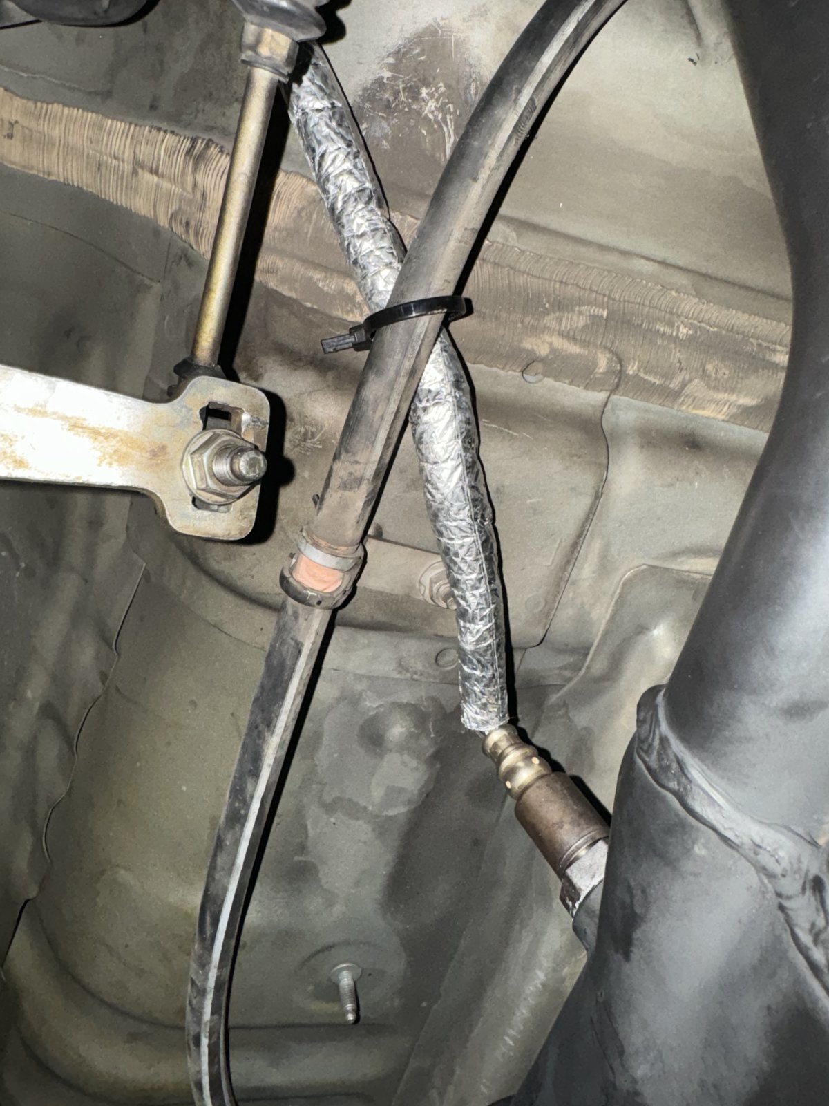

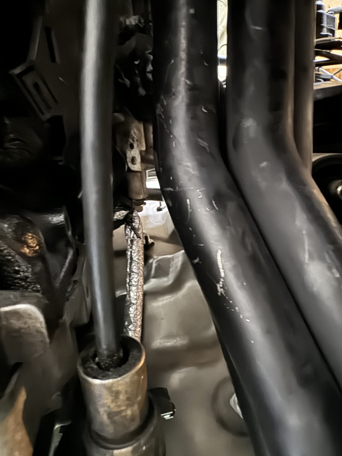

    I followed Keith's recommendations. I spliced, soldered, covered with heat shrink, and then with heat reflective conduit
    from the collector
    EDIT: later changed harness route to behind heat shield (see below)
    Past the transmission shift cable, and the parking brake cable. That zip tie is purposely loose
    this zip tie is also purposely loose but the O2 sensor harness on this can't get any closer to the header

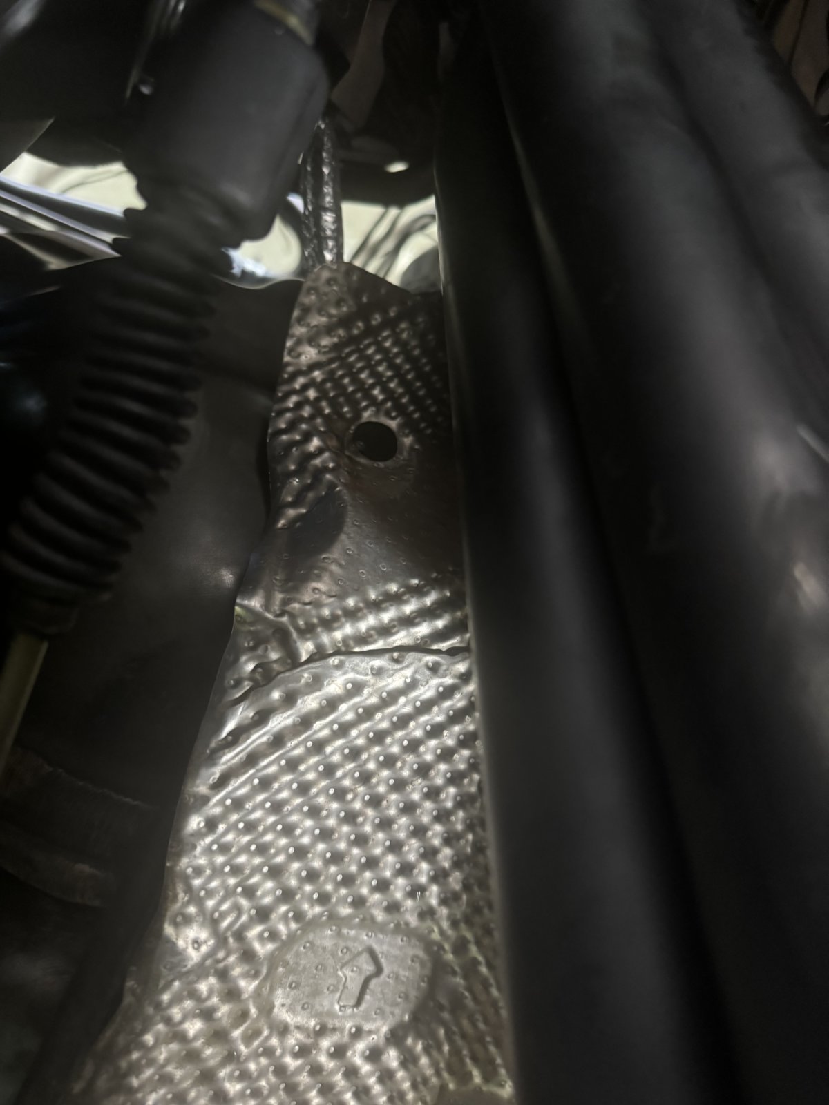

    EDIT:
    I rerouted the extended O2 sensor harness behind the heat shield. Did not like the zip tying it to one of the other wiring harnesses. The heat shield was perfect. I bent the heat shield slightly toward the cab on one side so I didn't have to zip tie to the other wiring harness which was poor form.
    Did not like:
    And last, the header from underneath without the motor mount installed
    i'll touch up with the same paint Keith used once I'm done

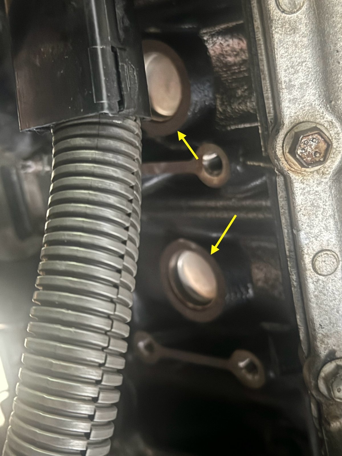

    Is rust around the flanges (??? Flat surface just outside the freeze plugs on the engine block) normal? Seems like there's some very slight seepage. Sprayed it with WD-40 so it's not quite as obvious now

    #131
    455h0le_dachshund
    Nov 21, 2023
    #107257
    8,443
    Rev. Hotdog
    TX...big surprise
    I mean you live in the south, surface rust happens with the humidity and can be worse if you live near the coast. But it's usually not a big deal. My bare steel BFF sliders sat in my garage for two weeks before I could install and paint em and got surface rust on em from the humidity.

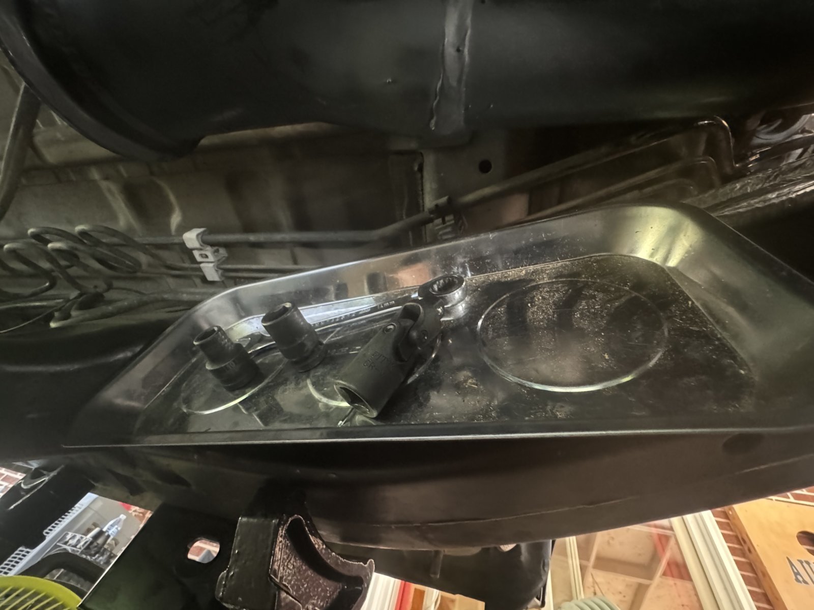

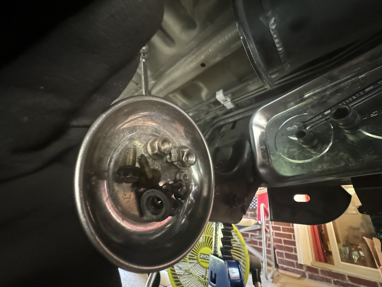

    Found a convenient use for these magnetic trays from hobo freight when you're on your back under your truck

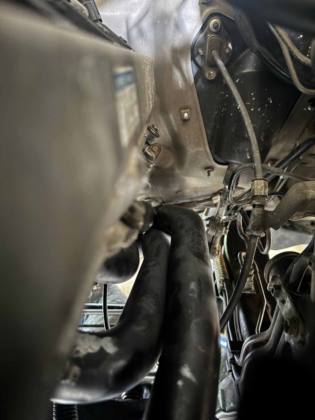

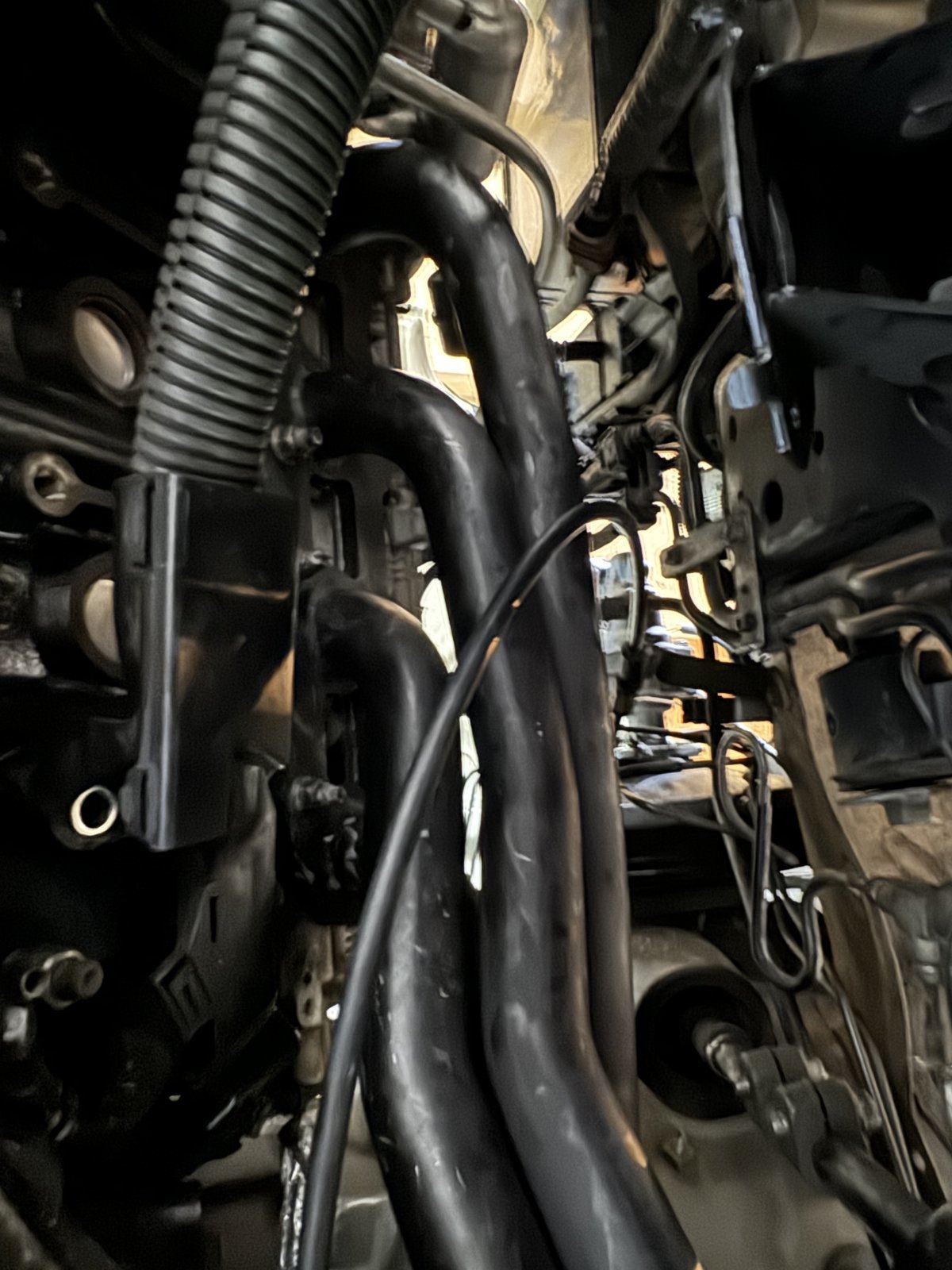

    Passenger side is much smoother after doing the driver side
    after bumbling and fumbling on the driver side, I found the correct o2/header install sequence to be:
    Install o2 harness in header bung
    place header unbolted as though you are ready to bolt on
    Route o2 harness behind the catalytic converter heat shield and then secure the heat shield
    My choice was to bend the edge of that heat shield so I did not have to secure my modified harness until i was close to the other connector near the engine. Harness is now protected and very secure
    plug-in the O2 sensor harness
    bolt on the header
    also worth noting. I didn't have an extra pair of eyes to keep an eye as I jacked each side of the engine up. On the passenger side, I jammed the O2 sensor into the firewall. This is most likely why I could not get the O2 sensor out. It seemed to be cross threaded.
    No big deal on the downstream O2 sensors, but for the upstream, even though they're twice as much as the downstream, ideal time to replace with Denso while you're in there, which is the OEM part. But again, if you use the extended harness instead of slicing and soldering it's just as quick and easy as replacing the downstream sensors
    A bit tacky, but effective:
    there was an access hole to another nut (dont recall what it was to) right where the O2 sensor connects. I ran the harness through that hole and used needle nose pliers to bend that hole so the sharp edge would not contact/cut the O2 harness
    Just read another thread where shifty and others adamantly said to never ever cut a wiring harness. Guess I've broken that rule twice now with my power seats and now the o2 harnesses. However, this is the accessory side and not the truck side. It's not like cutting the factory stereo wiring harness
    P. S. My right hand has never hurt so bad. Good thing my lady friend was willing to massage my hand lol. It is still killing me this morning. Just seems like almost every nut and bolt is in such a tight spot. Nothing impossible but just tight, challenging, and slow going

    @455h0le_dachshund @FrenchToasty @BluegrapeVr6
    Guys, did you even need an extension on the passenger side? Maybe mine is different because it's 2WD
    I didn't realize when I disconnected it that it appears the passenger side is routed over the transmission from the other side. And it appears the upstream harness comes out right where the upstream O2 sensor will now be located.
    it looks like if you disconnect the upstream plug from the bracket, it comes directly down toward the new location of the upstream O2 sensor
    Orange is upstream connector, yellow is downstream
  29. Jul 5, 2024 at 8:07 AM
    #149
    FrenchToasty
    Sep 15, 2019
    #36156
    18,696
    Mo
    The SoAz….. big surprise
    Bone stock
    I believe I only used one correct, I think I sent the other one to Dan
