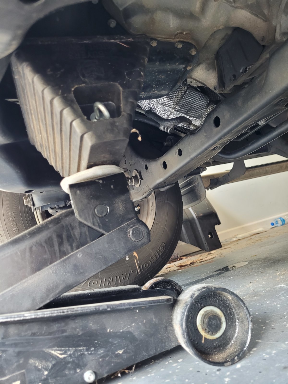

    Thanks That's different I like it. I also like using a 2 x 6 to spread out the weight.
    I guess I should've worded my question better
    we are preached to, and we preach to others about safety and working around or under your car if it is jacked up - be sure to use jack stands.
    Yet in this situation where our hands are very vulnerable, we just overlook it and only support the engine by a jack?

    Slow and steady. I like to lift it to where i need it then take a few steps back listen for it creaking. Maybe gently shake truck, have 2nd man there and seriosly rubing tubing to stop bleeding w 8/10 flat head to tighten. Know the clisesy fire department # , im going to try to due mine somewhere where i can use my come a long to be a back up. Something w some exposed structural steel

    I firmly support that reasoning. That being said ,OSHA violations make the day go quicker.
    If I were leaving both engine mounts undone for any extended amount of time I'd want something mechanical to hold it.
    When I did my headers I only removed one mount at a time. And reinstalled the engine mount if I was done for the day. So realistically, you're only depending on a hydraulic jack for a few hours.

    Do you have any friends that own an engine hoist? I'd ask around and see, or you may buy one from Harbor Freight then sell when you're done (or keep it for future projects)

    If I have to lift the motor I put a 2x6 under a amall piece of plywood under the oil pan.

    I just wasn't comfortable so I got a hoist. It was worth it for my peace of mind, even though the legs get in the way a bit The other way, I'm sure the Jack would've gotten in the way too
    I thought the same thing about buying one from Harbor freight but one of the local rentals had the same One Harbor freight sells for $100 for a week

    Great! I think that was the best and safest option. Yes, legs are in the way and you have to maneuver around them, but if you ever need to lift an engine, support an engine, or lift other heavy objects into your truck (I've used mine to lift transmissions into my truck bed) you've got a hoist for that now.

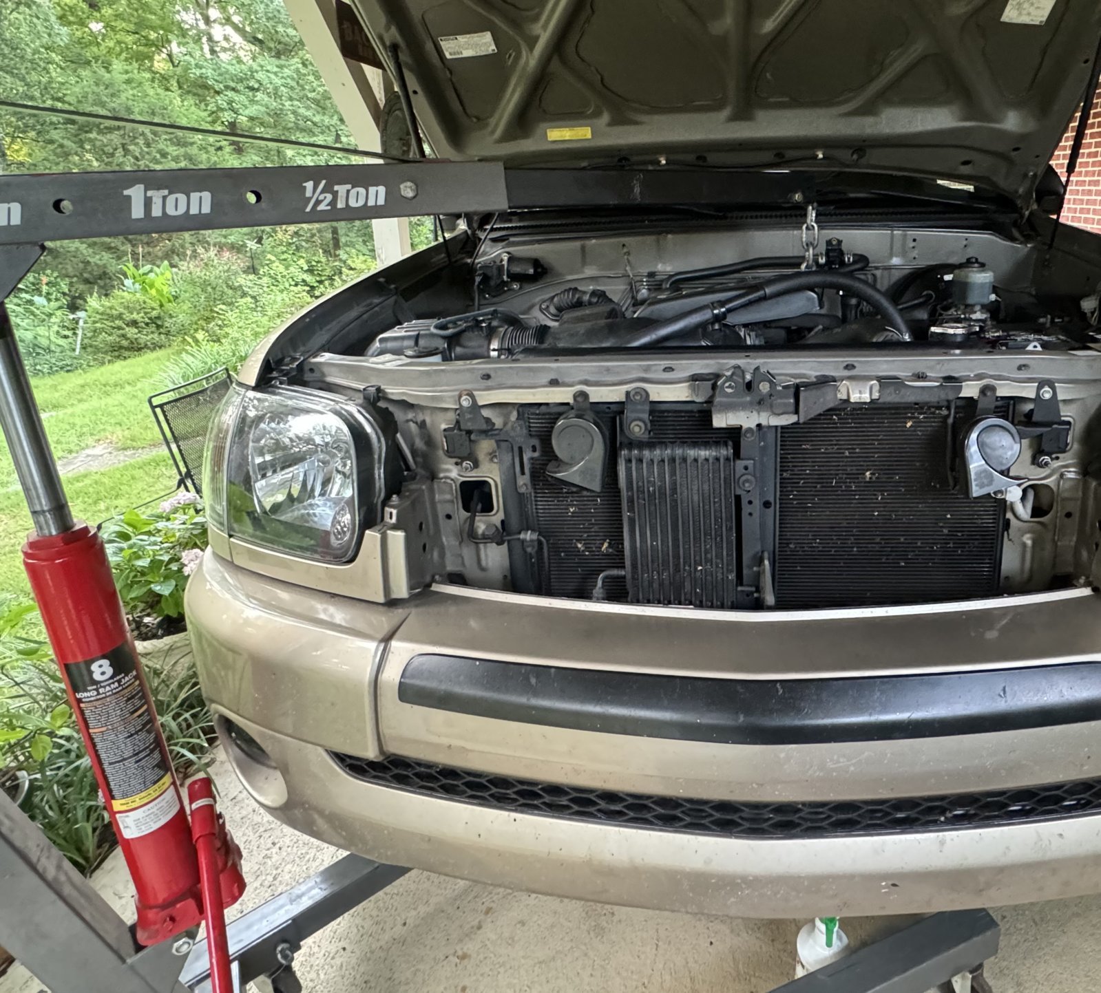

    They really haven't been in the way as much as I thought. This one has an adjustable boom And even at its furthest extension it supports a ton, which is ample for this project. Helps keep the legs out of the way
    and then you can easily adjust the height of the engine side where you're working as needed
    already have the top 4, now all 8 driver's side manifold nuts off
    I pictured of having a lot of scrapes on my arms and my neck hurting. Nope but my hands esp thumb is fatigued

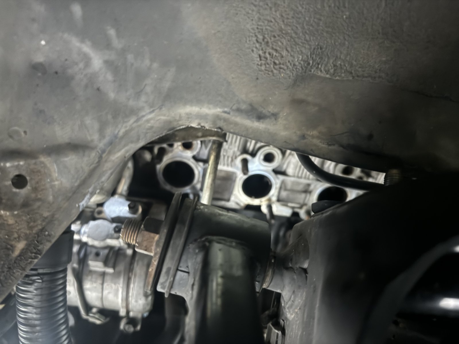

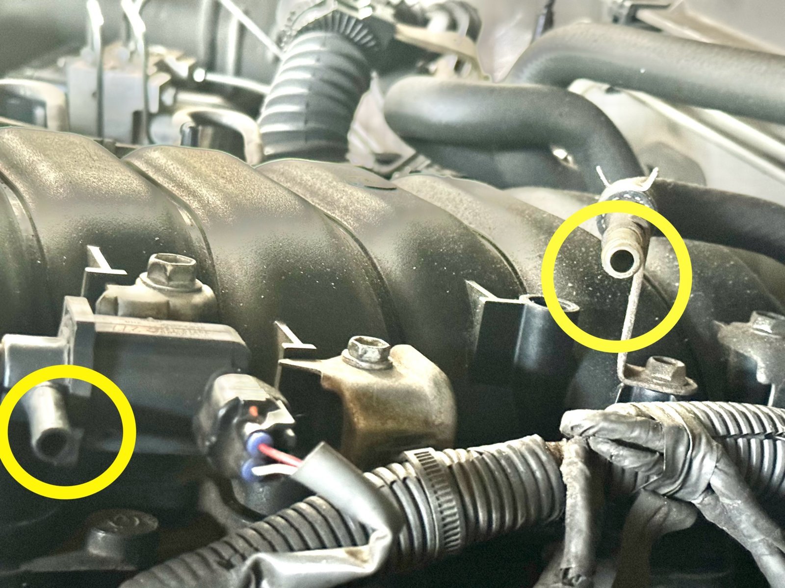

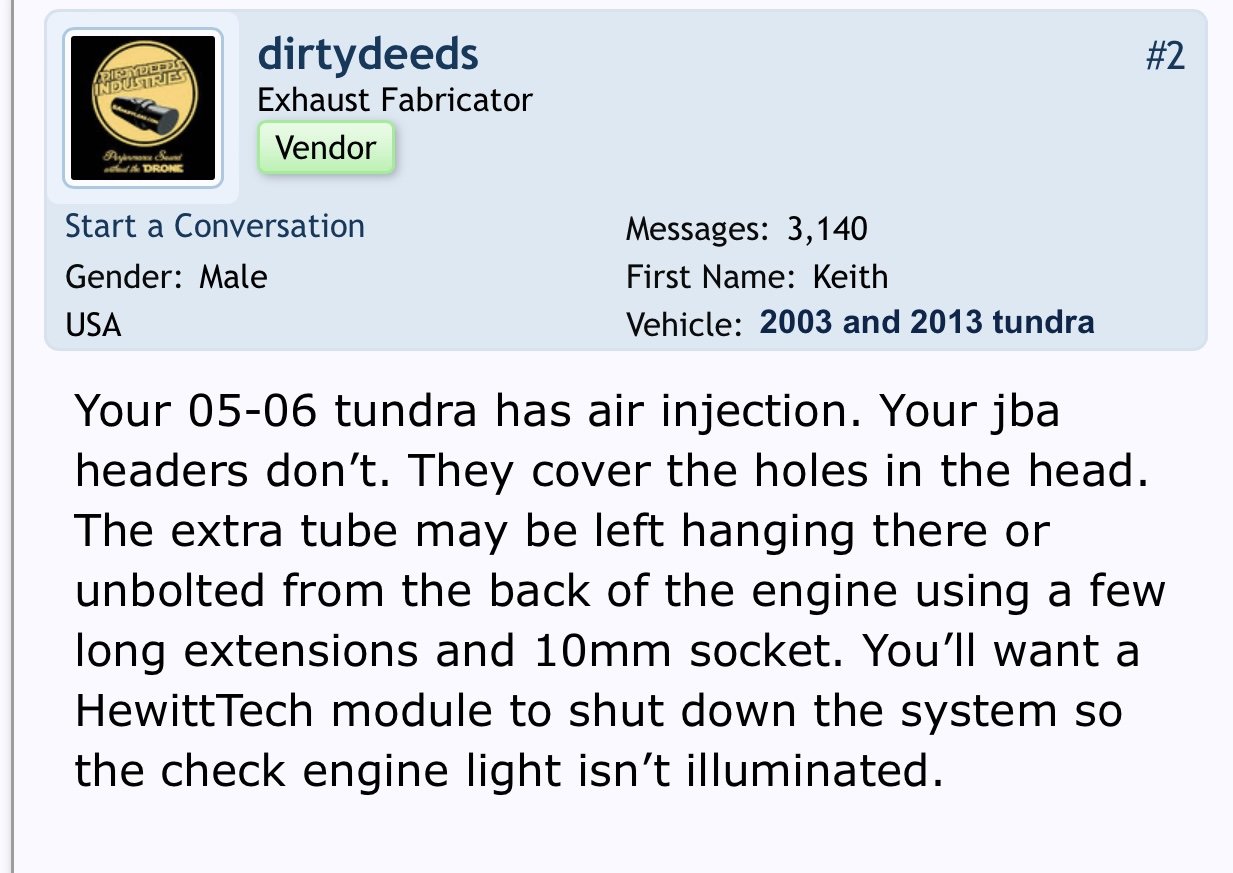

    EDIT:

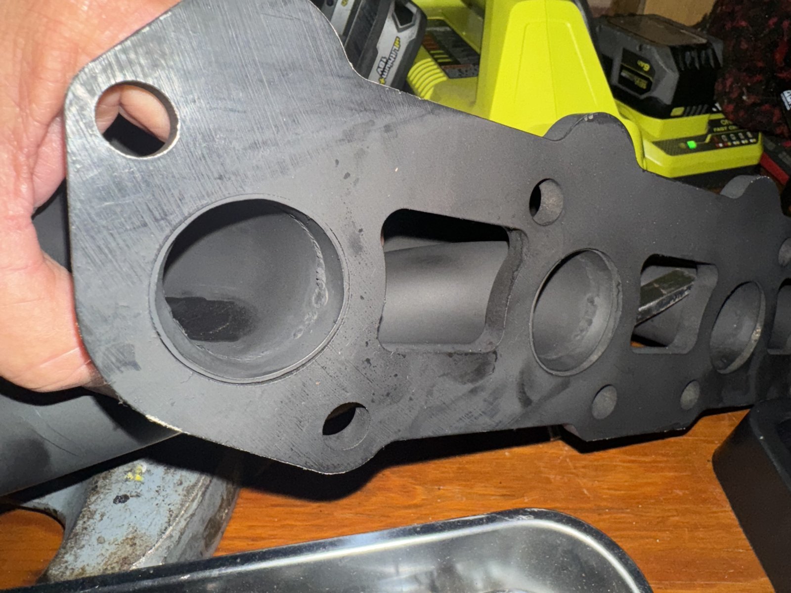

    after a call with Keith just now, I finally understand. He told me previously the headers would throw codes without one of a few possible modifications, but I didn't realize it was from SAIS and because his headers block off the ports by design
    so I chose the ECU programmed by The guy Keith recommended/Quantum Auto Tuning. This tune, of course, improves performance, and it is also designed for the headers thereby eliminating SAIS codes
    so I can just remove these tubes or pipes for the SAIS and get them out-of-the-way. Sounds like this also averts the issues in the future where many opt for the Hewitt bypass with block off plates
    Plodding along - now I've got the manifold off. Looks pretty clean for 312,000 miles
    Driver front:
    Driver rear:
    Orig Post:

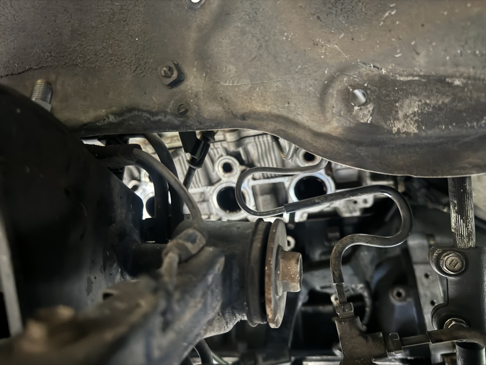

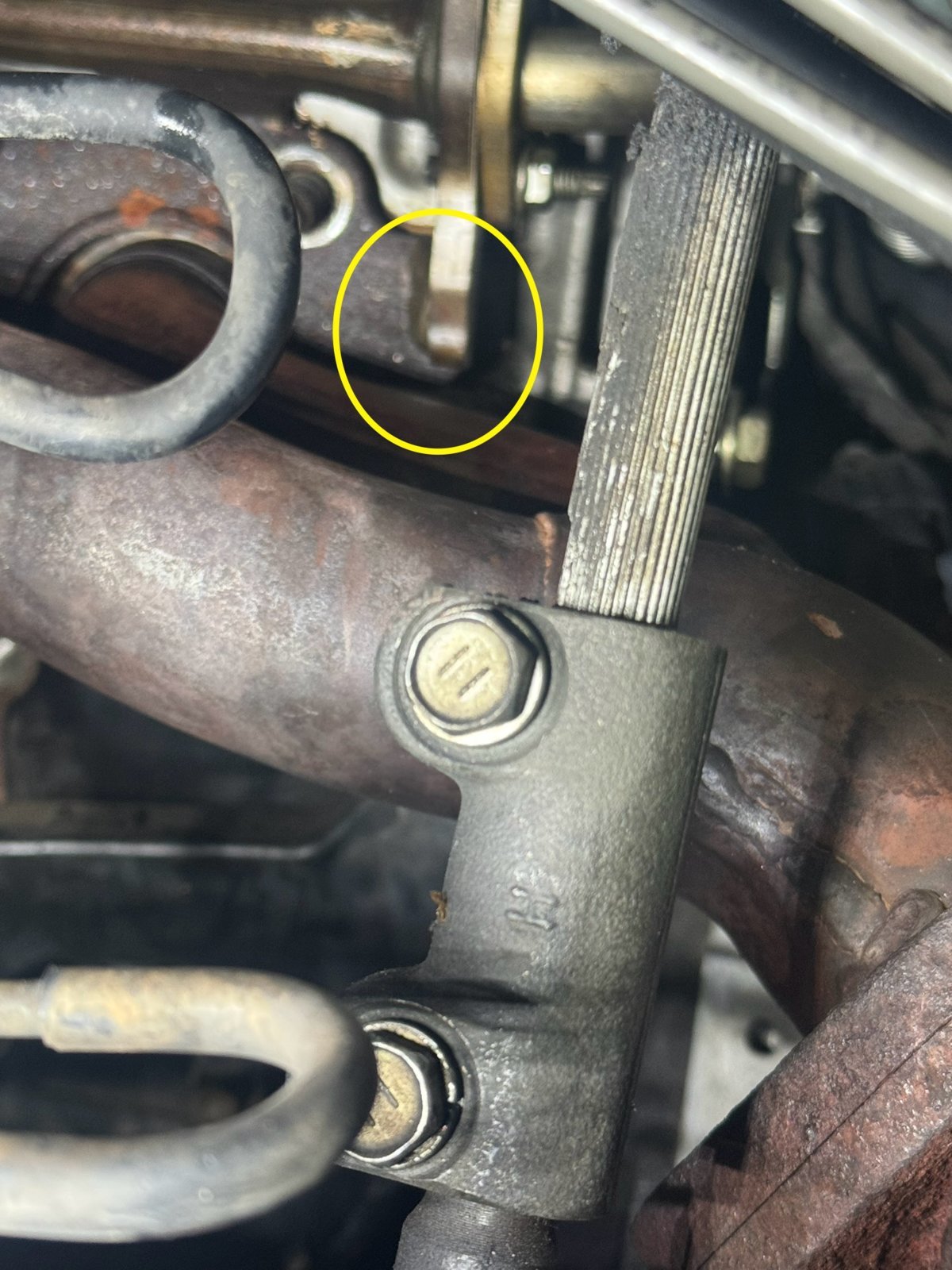

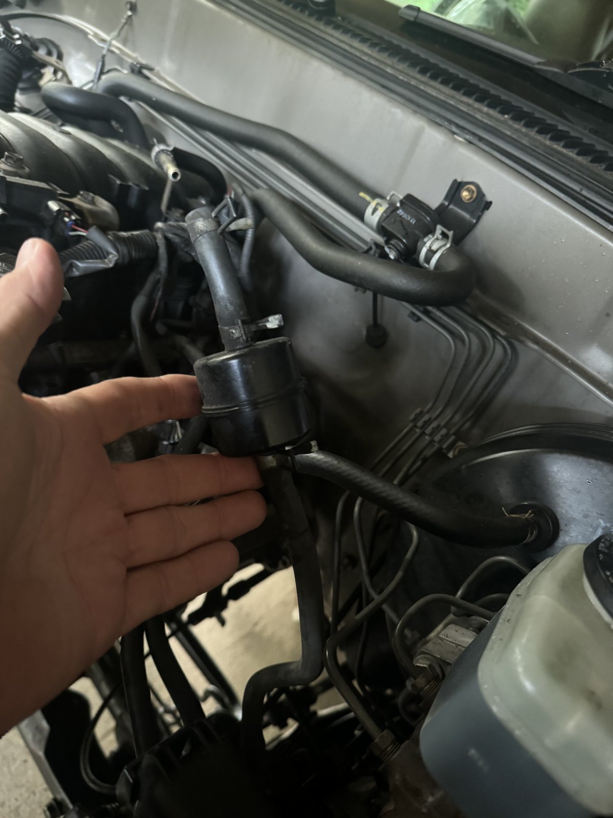

    I have all the exhaust manifold nuts removed on the driver side, but can't the manifold off due to this clip (?) / part of SAIS at the end of the manifold
    EDIT: there was no clip. It was where the SAIS tubes connected with flange joints - was hard discern from my view
    10 mm bolt doesn't have enough clearance (edit has just enough clearance but good luck getting to it much less putting it back) for any of my sockets and you don't have enough room for an open ended wrench
    Edit: Keith's headers by design block off the ports without the need for the block-off plates so I will be without the tubing.
    Orig: wish I had known about this upfront that's part my fault for not knowing about SAIS. Would've loved to just put the block off plates and removed & bypassed this whole system

    I was uncomfortable with the various suggestions for jacking the engine one side at a time so I used an engine hoist. Admittedly I'm a bit skittish about such things and everyone else seem to do it without this, but if somebody could screw it up it would be me so it just wasn't worth risking my hands and arms. Well worth it for my peace of mind
    I watched countless videos, but they weren't exactly my scenario and setup. Some of them were without SAIS, so didn't have the heat shield over the manifold or the SAIS tubes, some were 2ndGEN. Some skipped over some of the details that related to mine.
    I've been able to do it all by myself, but another pair of eyes would've helped while jacking the motor
    The latest version of DirtyDeeds headers for a 1stGen 4.7 block off the ports for the SAIS tubes. Therefore, you have to address the codes that it will throw up. Keith recommended the ECU mod from quantum auto tuning in California. This has the advantage of giving you the performance tuning as well as eliminating any SAIS related codes in the future. But I live in a state where I don't have to worry about emissions compliance And the SAIS has minimal impact on emissions just for a few seconds under certain conditions when you start the engine. You will also probably not get codes indicating that your converters are beginning to fail and/or causing performance issues
    when I did pre-douse the exhaust manifold nuts with PB blaster, I couldn't get to all of them until the day before. But all came off relatively easily with a few light-moderate bumps of the wrench
    I did have to remove the motor mounts and lift the motor on one side.

    I saw several references to disconnecting the driveshaft from the transmission, but Keith didn't feel that was necessary and therefore, I didn't do it. That might've only been for 2ndGen tundras

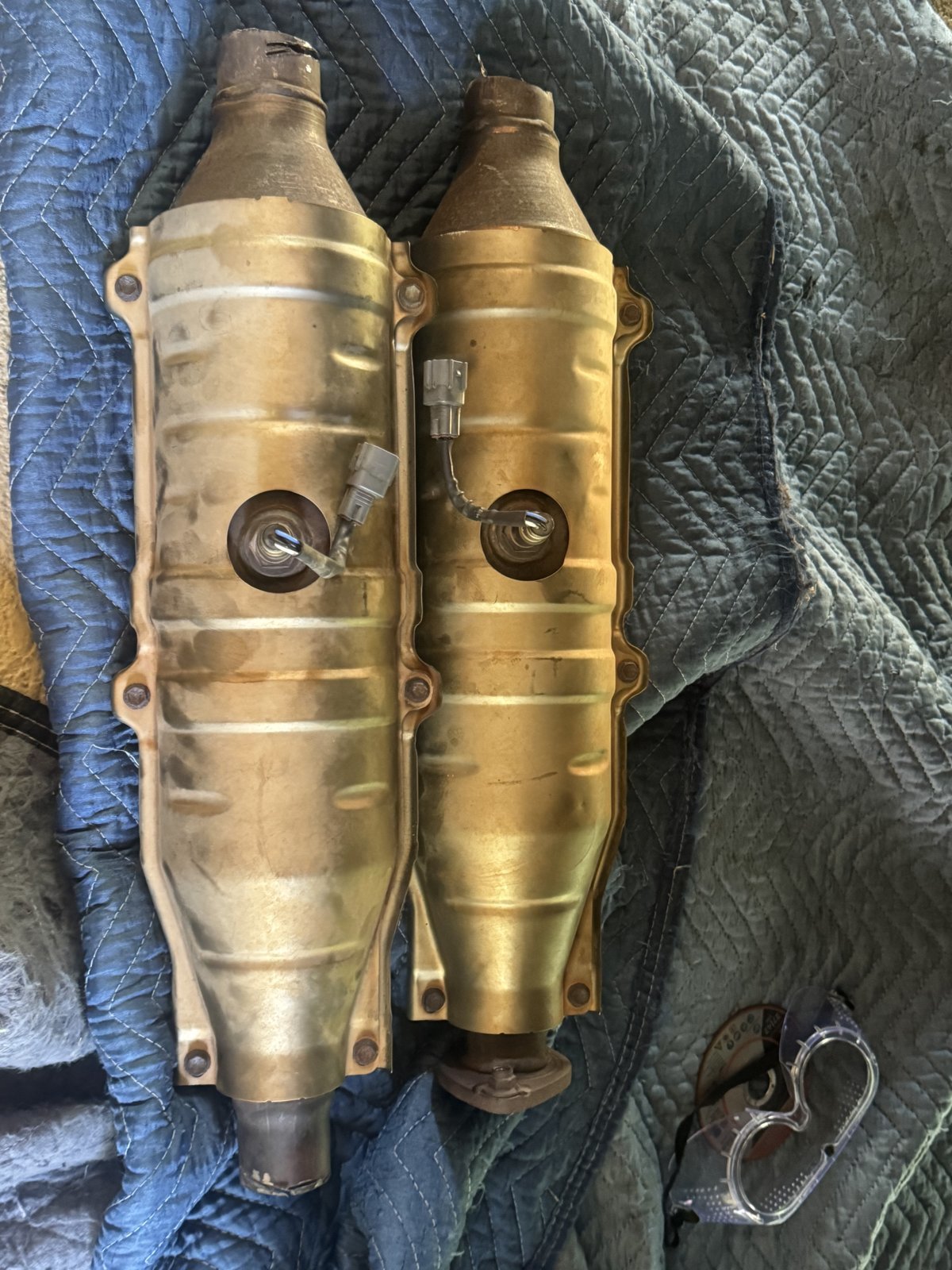

    I cut my catalytic converters so I could send them to Keith in order him to modify them by enlarging the entrances and exits and maintaining it as a bolt on system

    I am using Keith's recommended option to extend O2 wiring harness for the headers by splicing with the same color & gauge wires to extend approx 2 feet, soldering the wires, covering with heat shrink, wrapping with electrical tape, then heat reflective conduit, and routing / securing as far away from the header and exhaust as possible
    i'm sure I could've fabricated a plate to block off/seal the remaining SAIS tubes but I just ordered the block off plates from Hewitt. I don't feel like tinkering and redoing it so i'm taking off the tubes and doing it at what I believe is the pump as @Riverdale21 did in his installation here: https://www.tundras.com/posts/2496638.

    SAIS removal
    edit:
    hewitt bypass instructions didnt help. Since their plates are inserted between the rubes with all of the tubes in place, it's not the same situation as I have here where I am removing/losing the tubes on the exhaust manifolds

    i'm trying to read up on this, but it's always so damn hard to find just the right scenario. I'm not using a bypass kit, but I am removing the tubes that feed air by the manifold into exhaust ports
    So the ECU mod handles the codes/check engine situation
    the DD headers block off the ports where it would inject air briefly during start up if the conditions are met
    The tubes that feed the air into the exhaust port will no longer be present. But those tubes connected to another tube behind the engine, which I'm sure leads to the air pump.
    what I'm researching is if I have to do anything further??? I don't see how I can get to the back of the engine and remove all of that system, but those tubes will be open and exposed If I don't do something

    I should've read your post first. I'm glad to see how you did that because I didn't want those pipes just dangling.
    I just couldn't see back there well because I've got The driver side of the Engine jacked up and it's also tilting back toward the firewall
    Anyway, thanks. Great info.

    Once you get the pipe off the pump you can use the flange to trace and make a plate.
    I should have chimed in earlier this morning to answer your questions but you tagged Keith, and I didn't want to step on his toes.
    I'm not familiar with the chip you're using, I would imagine tuners have the ability to bypass SAIS systems. When I installed headers I had the Hewitt kit. But the other issues you outlined, I'm glad you were able to get answers from Keith.
    In the thread I linked, the first post shows the difference between VVTI and non-VVTI headers. Also shows how Dirty Deeds works around the SAIS ports on the head.

    He does it differently now. Now he blocks off the port
    that was also part of the confusion. Many have evolved over time and there's so many different versions

    While I was fresh and rested this morning, I went back through and updated post # 105 with the key points I remembered while removing the more challenging driver's exhaust manifold.
    Some but not all were referenced in the numerous videos I watched and other various recommendations I received. A few things others recommended or did in their installation I found unnecessary in mine

    I didn't even plate mine off. Not necessary with the bypass and these headers. I imagine turn off the SAIS with a tune would be the same as far as not needing the plates.
