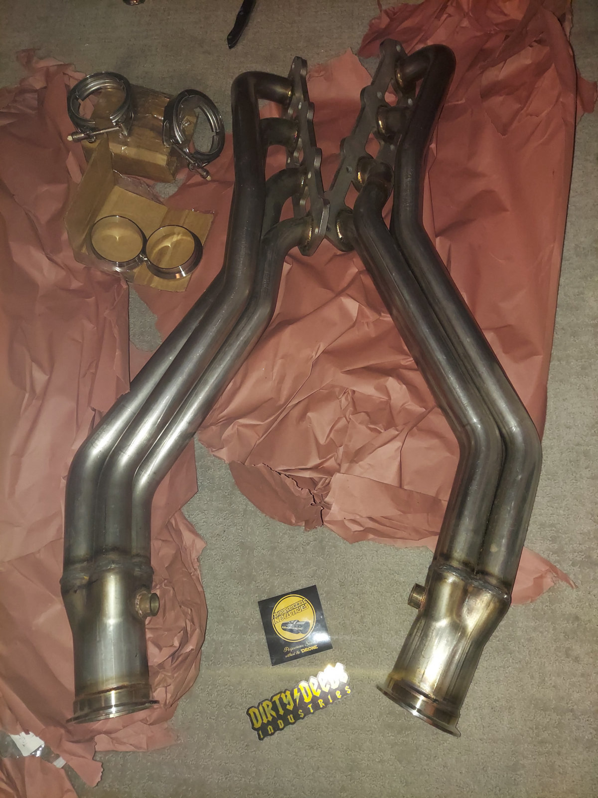

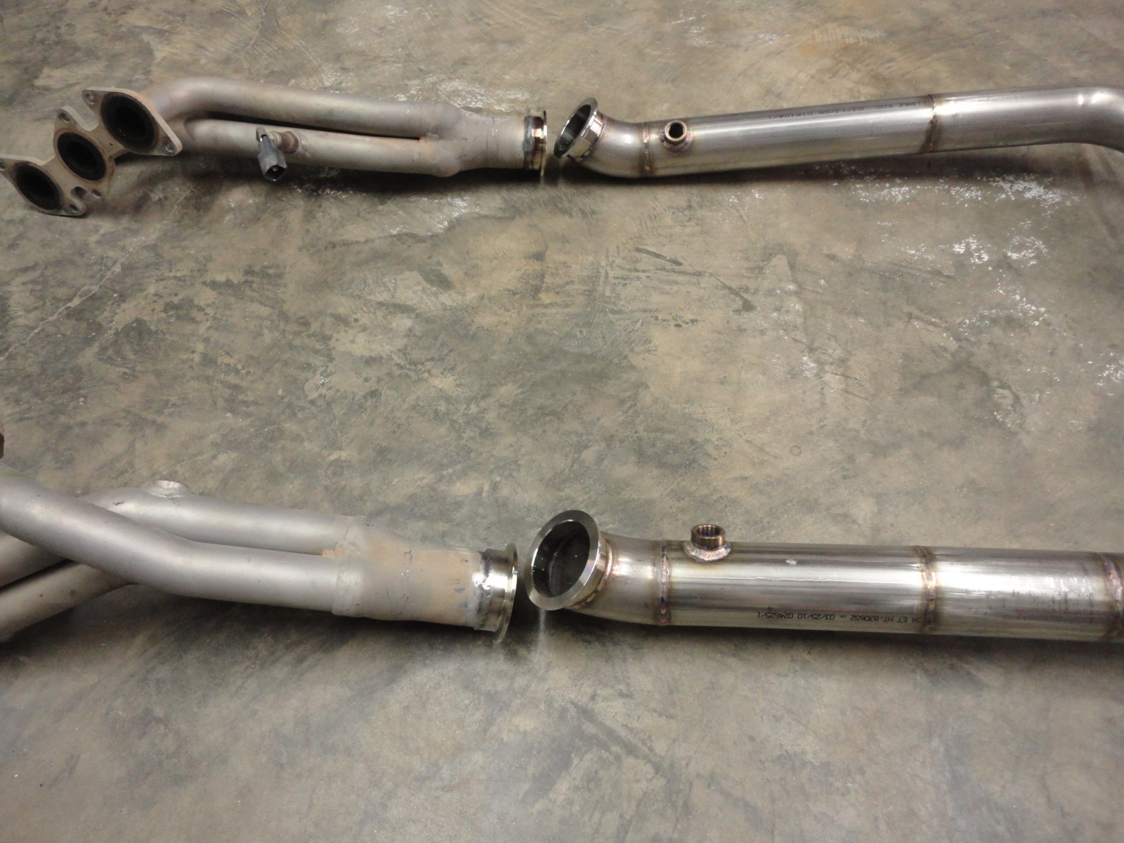

    Damn what kind of Gaskets are those?
    Non -hi temp painted for comparison:

    02's bungs seem to have different depth.

    And are you v-banding off road pipes or end of cats like im doing?

    Thay is a nice y-pipe exhaust. These headers could prob be done in 12 hours. But , if doable why not spread that over 3 days, and above is correct, getting ĝood fabricator to cut angled slice for turn, take to sander, debur, mock, tack, seal +back-puge then weld and move onto next pie cut. Yup , a nice exhaust can easily take another 10 hours. Then you have extending O2's, heat protection, tuning, which in my case w be w adjustments to hatdware. I mean its 100% worth it if you like this stuff like we do.
    But to anyone else.....they think we are insane since any gm w 6.1 or ecoboost will still blow our doors off. But they dont have a all time classic mid-size truck that sell for 20k , 20+ years later when mint. They have already been recycled ( certainly not saying yotas dont rust lol) just saying a clean example is much more rare. ...lifted ford/,gm I dont even turn my head unless its a old ramcharger or CK

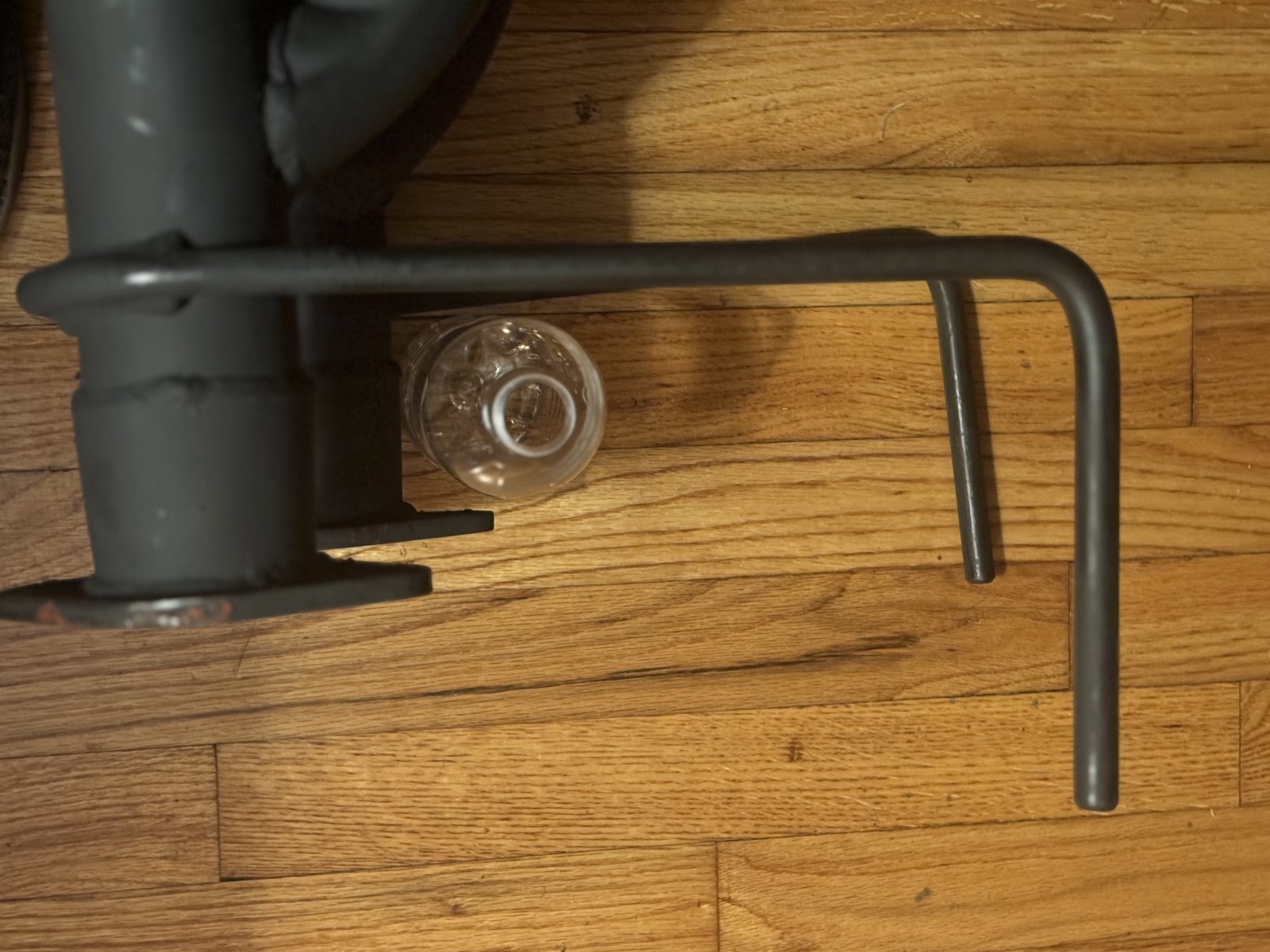

    Bilstein 5100's with 2883's - close to 2" Replacing the 2883's and going back to the bottom perch ASAP -mobile/apple play stereo with sub and backup cam -Power stop HD front calipers and rotors for towing -20" wheels with 32" tires (305/50's) Toyo AT 3's with no rubbing -Westin nerf bars -Detroit axle new (not rebuilt) steering rack with poly bushings, inner and outer TRE's -Suspension Maxx extended front sway bar links -Overland tuning - medium level -Power front leather seats and steering wheel from 06 Sequoia -fully de-chromed/blacked out trim -all light housings incl 3rd brake light and tag lights replaced with smoked lenses, LED where appropriate -mini projector headlights -fully rebuilt trans and new torque converter -new complete drive shaft with spicer u-joints and carrier bearing -all LED interior lights including backlighting -new lower window seals for all 4 doors -all new hardware and clips for tailgate Next: Dirty Deeds racing exhaust with LT headers, yellow box, 12 hole DD fuel injectors, redo or replace door panels

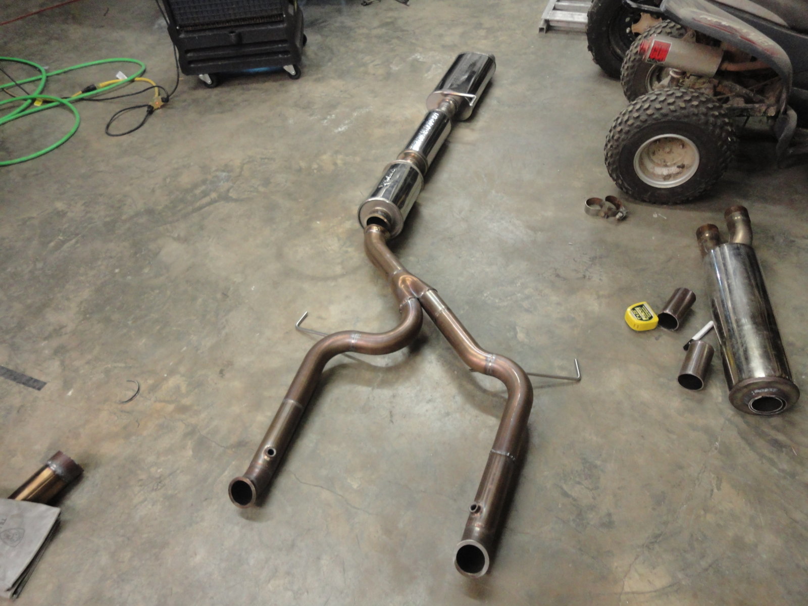

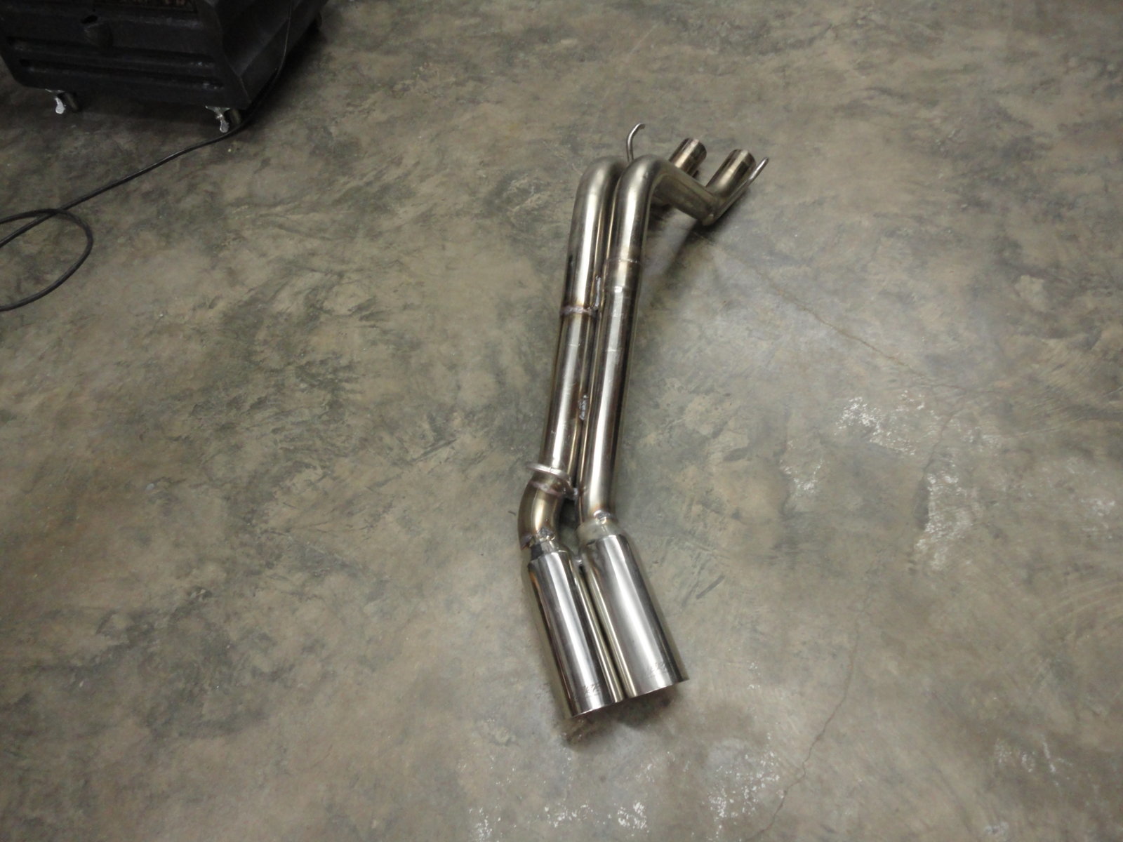

    They came from Keith with the headers and racing exhaust. I just didn't get the tailpipes.
  16. Jun 20, 2024 at 5:50 AM
    #76
    badass03taco
    badass03taco New Member
    Mar 8, 2024

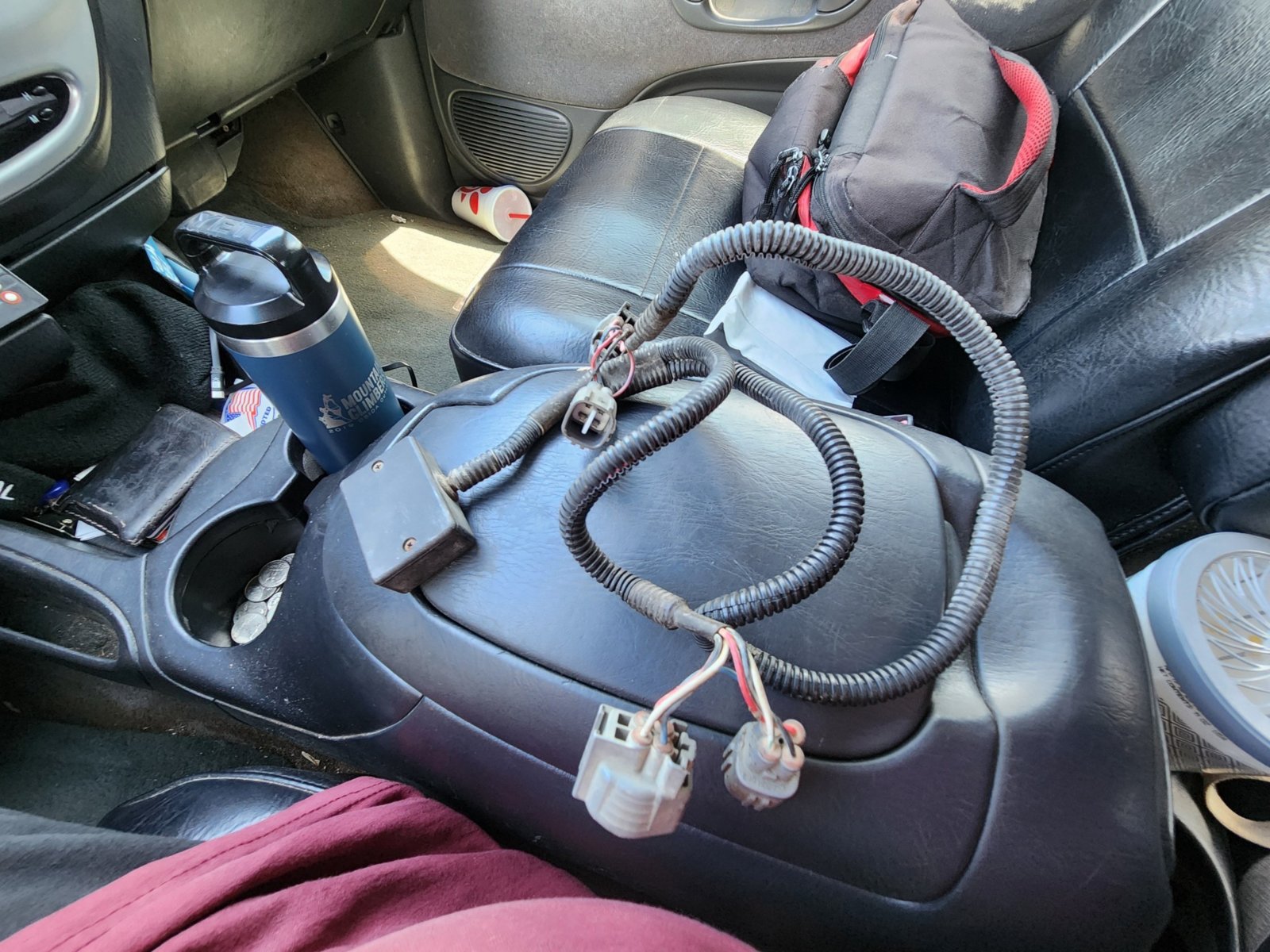

    I was reading over the instructions and it only said to follow the manufacturers recommendations.
    I assume inside the engine bay?
    Edited to add I just saw this video and yes, that's where they put it. Since it is adjustable I'm surprised it is an inch short
    I'm sure you gained some performance.
    I'm really puzzled by Keith's exhaust. I'm sure I'll see why it is this low when I get it mounted but still, wow it's hard for me to imagine how low this is going to hang.
    The water bottle is for a size reference

    I like the wood floors.
    Yeah let’s see how low it hangs.
  26. Jun 25, 2024 at 10:14 PM
