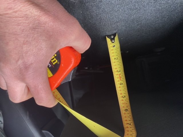

    I just measured again, shims are more like 3/4”. Under the seat back to the jack mount is 6” to where it will touch upholstery. Front edge is now 7.5”. Not sure if pic helps but here ya go

  23. Apr 11, 2021 at 7:44 AM
    #203
    Barrett50
    Barrett50 New Member
    Dec 15, 2020
    #56214
    1,231
    Barrett
    Wisco
    2015 DC silver
    Upside down again sorry. Raining out.
