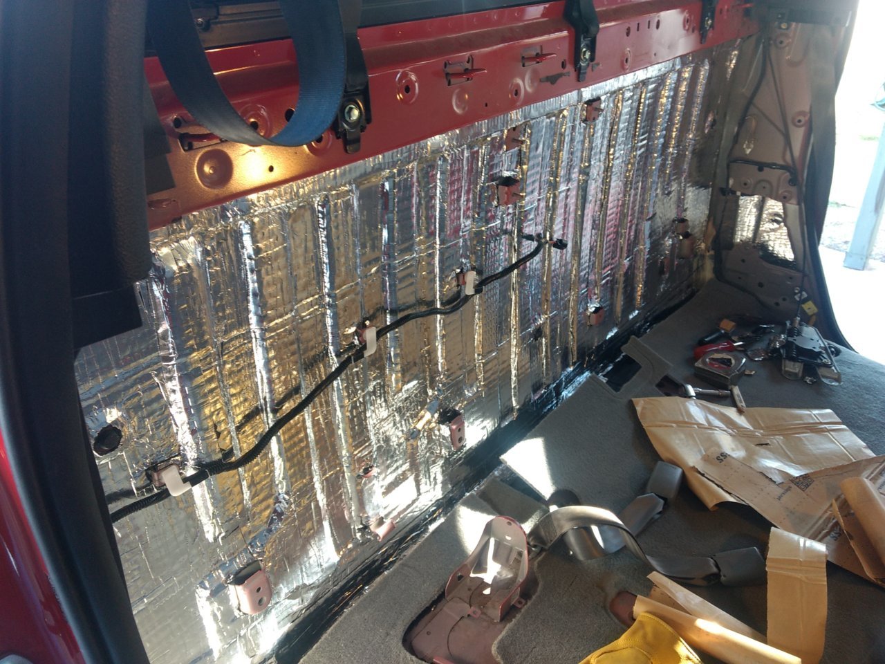

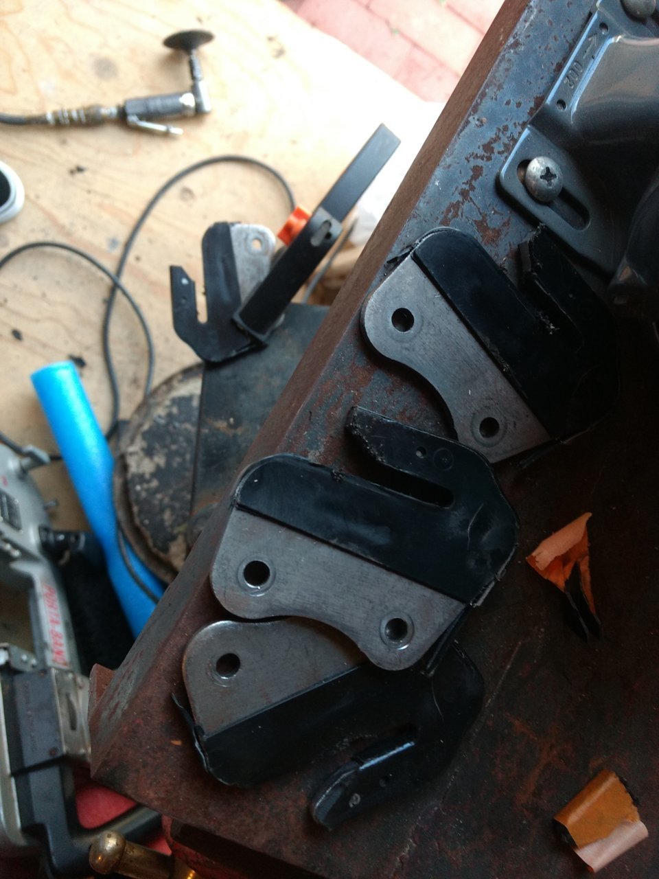

    Had to remove my seat to replace a cable for my sliding back window so, I figured this was as good a time as any to do this mod.
    Getting the brackets off was made a bit easier with this 1/4 drive flex shaft.
    Used my Porta-Band to make the cuts then touched everything up with the angle grinder and sanding arbor.
    Another thing I did when I had everything tore apart was insulate the crap out of the back wall. Had a lot of road noise coming from there and this absolutely killed it.
    tyr0981, Wiesy442, 619Tundra and 3 others like this.

    What did you use to insulate the rear wall?
  19. Jan 16, 2019 at 5:53 PM
    #79
    Taco-Blender
    Taco-Blender Old Guys Rule
    Sep 17, 2017
    #9710
    1,798
    AZ
    2010 DC 4x4
    Sorry, got called to dinner in the middle of editing the post. It's fixed now.
    Sound deadener and heavy foil backed insulation glued to the curtain.
