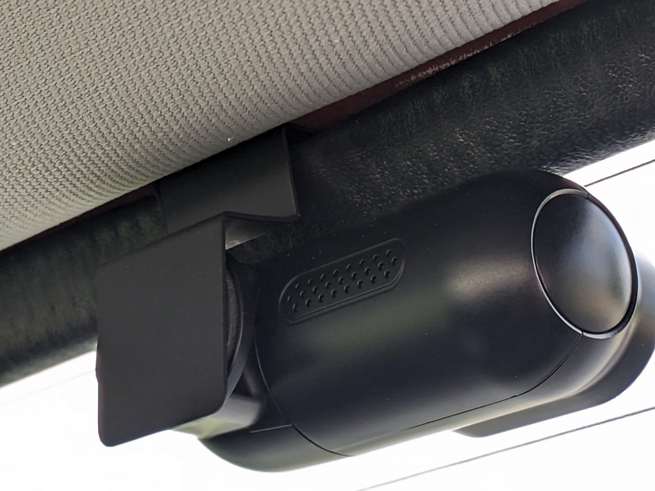

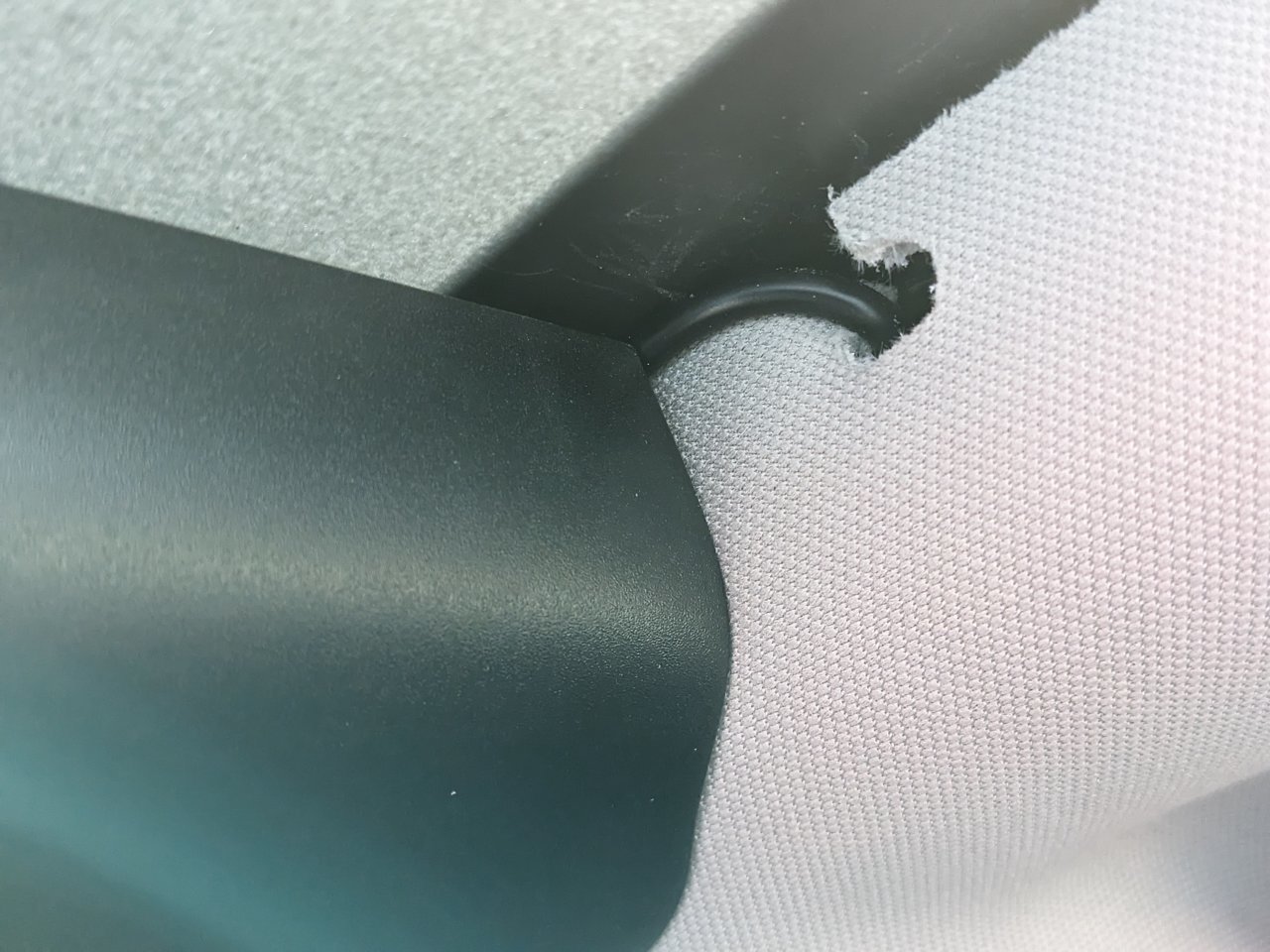

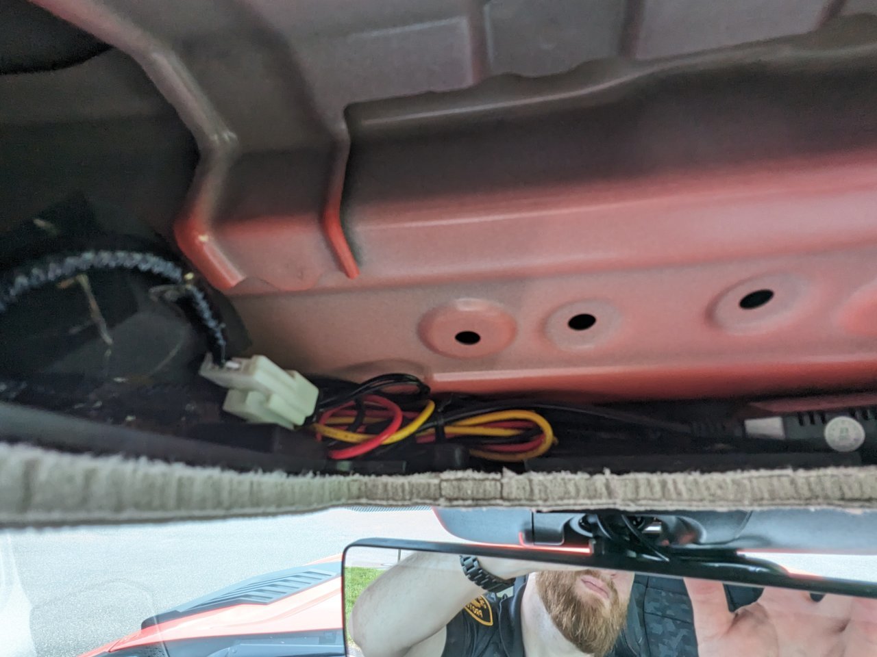

    Took a few pics on how I set mine up, hopefully it helps.
    Pull this down and towards you to get access.
    After creating a little harness like I posted earlier, you can plug it into the available plug and tuck it up under the headliner. Towards the mirror is a hole you can push your wires through to plug the dash cam into.
    To connect the rear camera, you can guide the wire out from under the headliner up towards the passenger side of the rear view mirror and out towards a premade hole. I then tucked the wire between the headliner and the A, B, and C pillars towards the rear window.
    For the rear camera I bought this short length bracket and tucked it under the weatherstripping for the rear window.

    what's the correct name for that 5 pin female connector? I'm gonna install my camera this week and thinking I will build the connector instead of tapping into the wires for a clean installation but I don't know exactly what is the correct form factor of that connector

    The actual name for the 5 pin plug? No idea.
    I just eyeballed it online and ordered the Subaru harness, didn't want to figure out how to build it.
