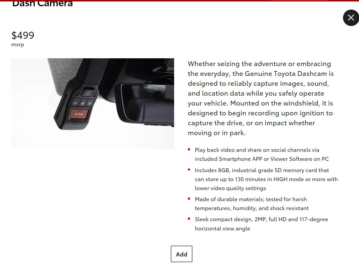

    It needed a storage card. They didn't tell me that.

    it should have came with a 8gb card, even says so on the accessory page

    I put an oem camera in my truck.... 3 and change for the unit. Install wasnt too bad.
    Had to print out a template for the sticker etc. Took about a hour to install and thats with taking my time with fitment etc.

    @ColumbiaGorge
    I'm about to install the same camera. Did you take the cover off the rear view mirror or just fish it through? It looks like a jigsaw puzzle to me and I don't want to break it or not have it re-installed correctly. That plastic around the mirror is probably $200 knowing them.
  12. Feb 29, 2024 at 8:31 PM
    #72
    ColumbiaGorge
    ColumbiaGorge New Member
    Nov 13, 2018
    #21691
    129
    Joe
    Columbia Gorge
    24 Limited
    You have to pull down the sunglasses holder/dome light piece is all. Pull from front to back. It does feel like it’ll break. Just go slow and work around it. From there, you can plug the adapter in and fish the wire down by the mirror. No need to pull the mirror cover off. Good luck! If you need help I’m happy to make a (crappy) video tomorrow
