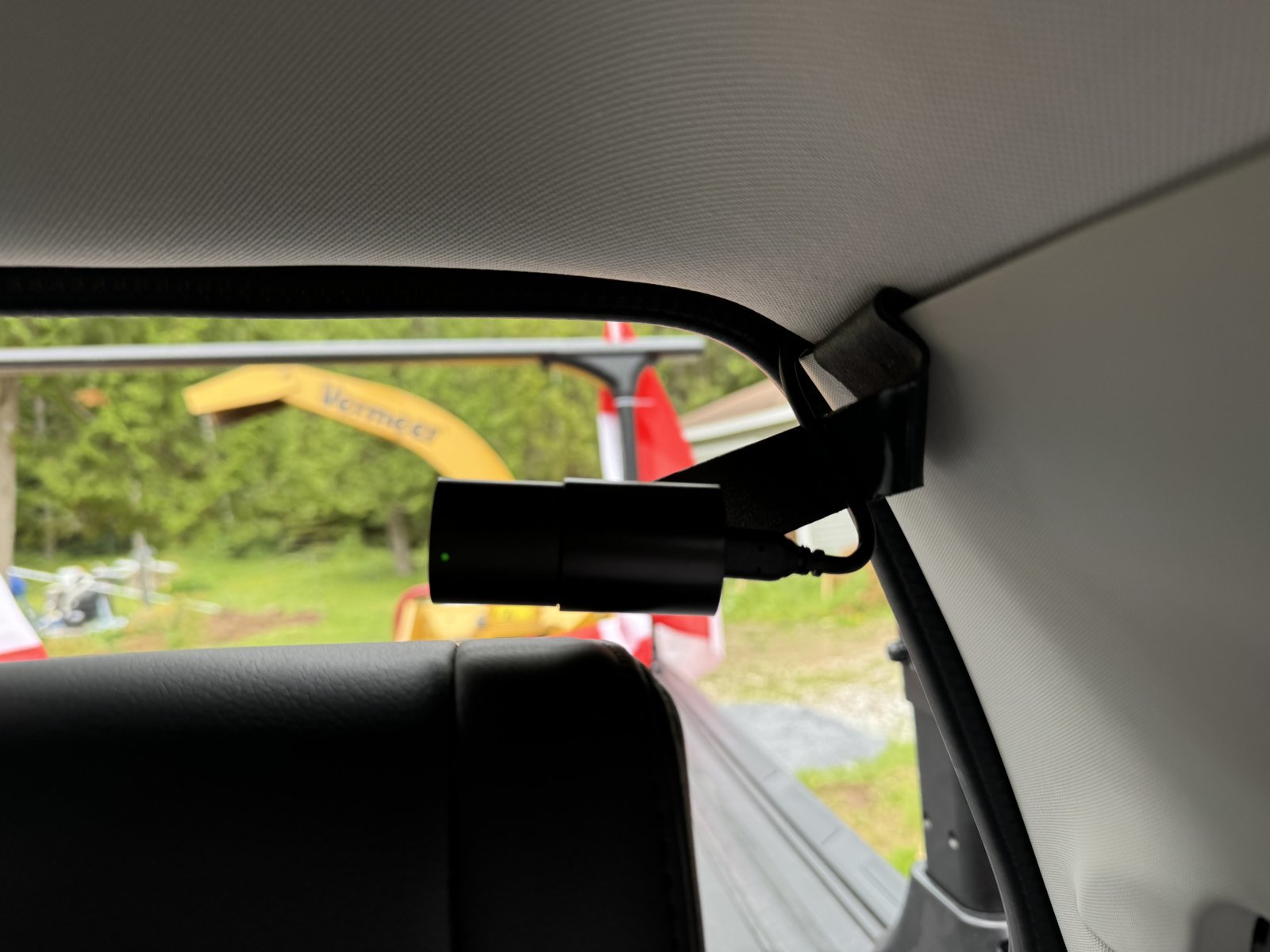

    rear.
    Mounted behind rear headrest on a mount clipped onto the trim. I made this by folding a piece of thermoplastic. This way the window still works.

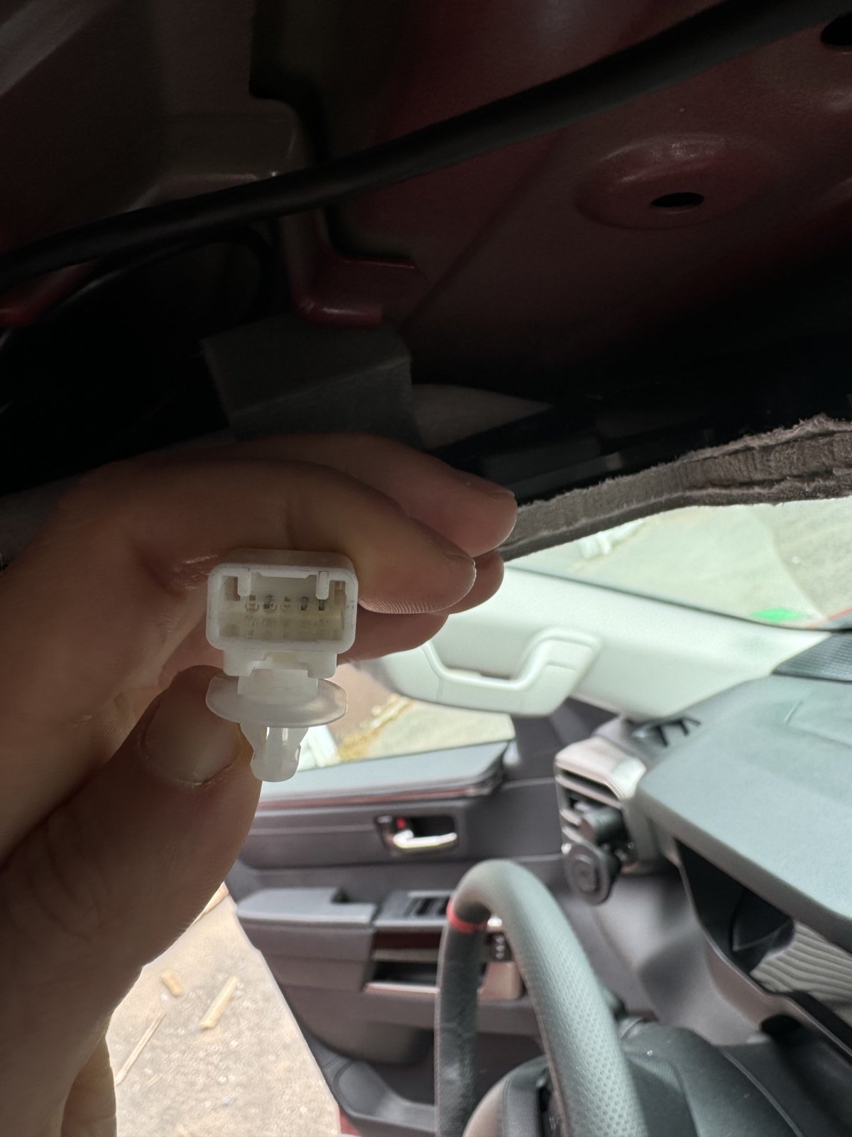

    wire was easy to run from front to back up through the hole by the rear view mirror then past the sunglass holder which pulls down (with an uncomfortable amount of force). Gentle pull on the headliner by the sun roof gives loads of space then pushed an old bicycle brake cable housing up from the dismantled rear to pull it through the last bit.
    next I’m going to hook the vantrue power supply to the spare plug up by the sunglasses holder and I’ll let you know it that works. IMG_5249.jpg IMG_5246.jpg

    IIRC they will but it costs much more than the part. I’ll probably take you up on that offer at some point though. The thermoplastic is surprisingly easy though. Cheaper than a 3d printer too.
