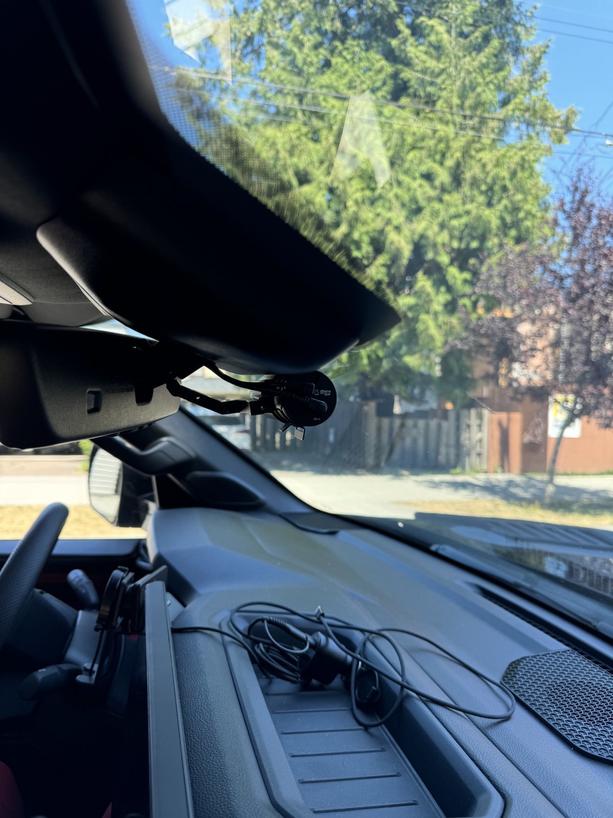

    I am not in south texas, but install is relatively easy. Here is how I did mine
    Parts & tools:
    Step 1: Unbox and Test Dashcam / Set out Tools
    Before any installation, unbox and test the dashcam. Make sure that it records from both channels, there are no camera issues, bluetooth and all other features work. Nothing worse than getting all the way through the install, just to find out that the camera is not working. Also a good idea, set out everything you will use for the install. Here are the tools (minus the heat shrink & heat gun) that I used.
    Step 2: Remove Front Dome Light Console
    This is much easier than I expected it to be. There are 2 red push clips in the front (towards the windshield) and 2 retaining posts in the back. To take it out, open the sunglass holder, and hold the inside while pulling firmly down. Otherwise, use a trim tool under the edge and pull it down. Be careful not to push against the headliner, because you will damage it, and always pull the front (windshield side) down first. Once the red clips pop out, angle the front down out of the cavity and slide the back retaining posts out. The console will drop out.
    Step 3: Run the Rear Camera Wire
    This was the hardest part of the install. Please note, I am not a mechanic, nor am I a professional installer. Using the cable snake, I first tried a single run from the back edge of the headliner, by the rear window, around the moonroof, and into the dome light cavity. Naturally, that failed.
    The best was I figured out to do this was take it step by step. I routed the wire in the following order: Dome light cavity -> driver's door -> rear driver side door -> rear dome light cavity -> out the rear window headliner.
    Following this pattern, first step is to remove the weather stripping on the driver's door. Very easy, just grab and pull - there is no adhesive, just a groove that affixes it to the seam weld and holds the headliner. This will expose the top of the headliner, and airbag.
    Run the wire fish above the airbag, and into the front dome light cavity. Once you can see the end of the wire fish, pull it through and use tape (electrical or painters) to tie the USB-C cable to the fish. Then, simply pull the fish out.
    Once the wire is at the driver's side door, it is very simple to get it over the passenger side door. Pull the weather stripping down further, and do the same for the rear passenger side door. Just like you already have, run the wire fish through, starting at the rear door and into the front door. Affix the cable to the fish, and pull through.
    Now, you will have to get from the rear dome light to the rear door. This rear dome light has 4 spring metal tabs that are grooved to press against the headliner/mounting points in the roof. In order to remove this, you need to gently pull down on the rear dome light, by sliding a trim tool under the outer lip and using it as a lever to create space, then sliding another trim tool into the space and pushing upwards and inwards on each spring metal tab until the headliner is out of the groove, and free of the clip. Once all tabs are moved up, the rear dome light will drop freely with no resistance.
    I wasn't able to get the fish into this cavity and through to the rear door. I ended up going from the rear door into the rear dome light cavity, taping the wire to the fish at the rear door, and pushing it further into the cavity instead of pulling. A little tricky, because the tape liked to slide along the smooth metal fish, but it worked.
    Now that your cable is at the rear dome light, you just need to get it to poke out of the rear headliner. Toyota made a very inconvenient ridge near the back, the best way I was able to do this was using a trim tool to lever down on the headliner, running the fish in at an angle just to get around the ridge, then straighten it out to get into the rear dome light cavity. I wasn't able to get a good picture of this, since it already takes 3 hands, but this is how to push down on the headliner. NOTE: I do not suggest removing the rear window weather stripping. (1) you don't need to and (2) it is glued on, and you may damage it, but at a minimum will need to re-glue it.
    Once your wire is poking out of the back headliner, you have completed this step.
    Step 4: Locate and Attach the Dongar Connector
    The connector you are looking for is located on the driver's side of the front dome light cavity, and held in place by a small plastic clip.
    Slide the connector forward to free it, and drop it out of the cavity. Plug in the male end of the Dongar connector into the truck, and clip the Dongar female plug back into the retaining clip to avoid rattle.
    Plug the USB-A end of the dashcam power cable into the Dongar microcontroller. Optionally, heat shrink this connection to prevent accidental disconnection.
    Run both your dashcam power cable and the rear camera connection cable through the front lip of the headliner and onto the windshield. Then, zip tie your excess cable and tuck it into the cavity to prevent rattle and keep everything organized.
    Step 5: Finish Install
    With your wires exposed, front and back, push both dome lights back into the roof cavities. I recommend using the attached static stickers on your windshield, especially if you have tint, rather than mounting your dashcam directly to the glass/film. Make sure to clean the area with isopropyl alcohol (which is tint safe) first, and do not get trapped air bubbles when applying the static sticker. Follow the rest of the Viofo install instructions in regards to securing the cam with 3M tape and powering it up.
    Mounting the Rear Dashcam
    There are a lot of options for mounting a rear dashcam, but I didn't like any of them. I ended up fabricating my own bracket, which is basically a magnet on a spacer, with a slope that matches the *very annoying* ridge that Toyota has added near the rear window. I understand that this is not the most practical for most people, but there are commercial options out there. Pics of the one that I made.
    Hope this helps! Good luck with the install.
