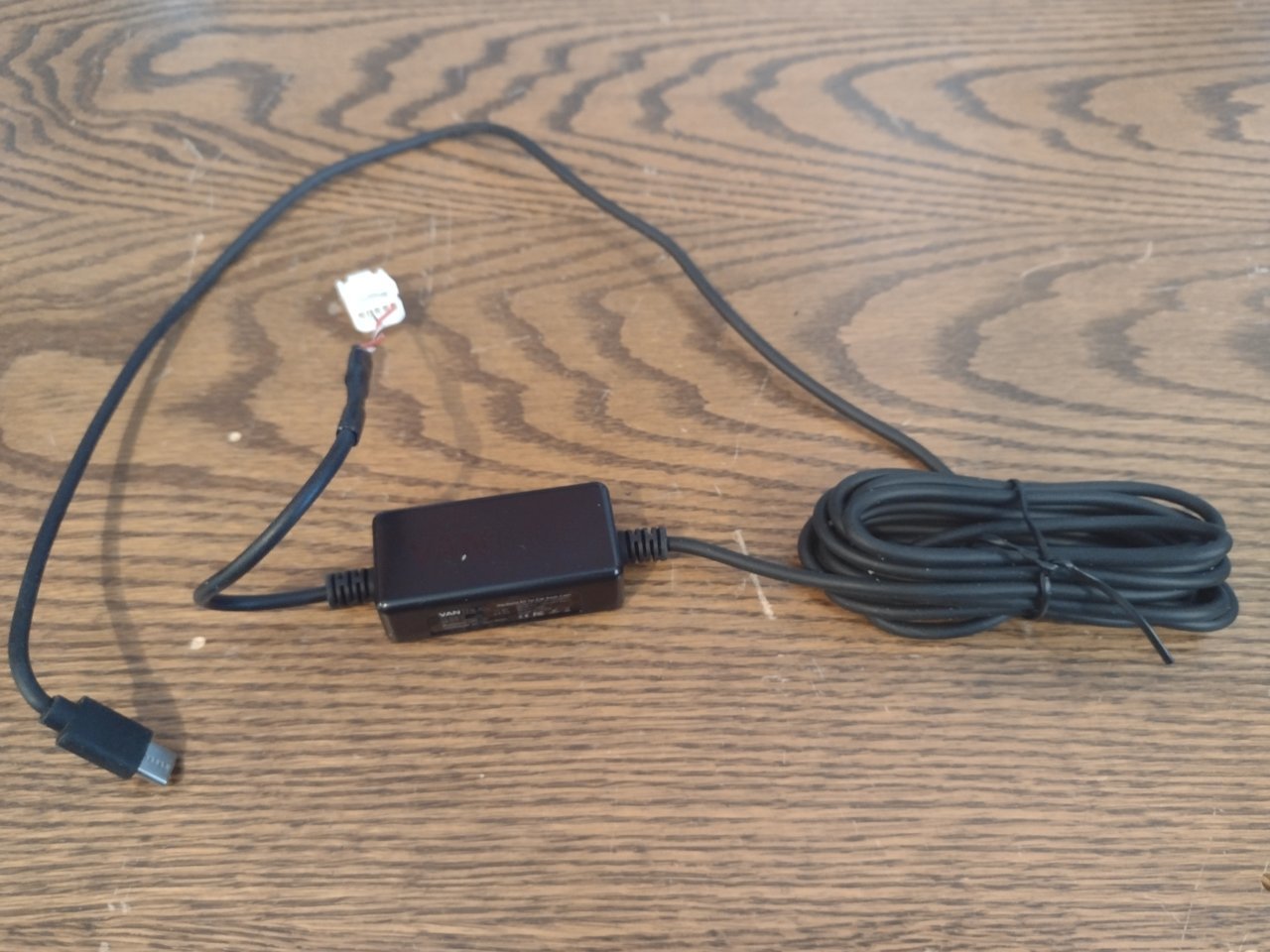

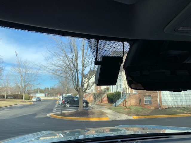

    Got it done today after all. My Viofo came with that USB A-C cable buried in the box. But I ended up not using it because it also came with a cigarette lighter power adapter with another long (like 3 or 4 feet) USB A-C cable with a nice 90 degree USB C male plug end. So, I simply cut that and solder spliced it to be about 12" long. This cable drops straight out of the headliner and the 90 degree keeps excess exposed cable to a minimum. I mounted the cam like my last Viofo in the Tacoma, on the driver's side adhered to the tint dot area with the cam as high up as it can go with the lens looking out just under the dot field. I mount these just far enough to the left of the mirror so I can still slip the cam off its mount to the right when I want to pull out the SD card.
    The Dongar I have does indeed supply ACC switched 12V and the cam comes on and shuts off with the ignition. Connected wifi, went into the app and set the time zone, resolution, etc. I haven't messed with the rear cam yet. Running that cable is going to be a bit of a PITA, at least around the B pillar, I am afraid. Otherwise, I believe it will mostly just tuck into the headliner edge. Another day...

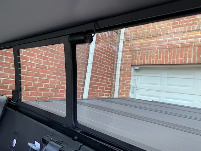

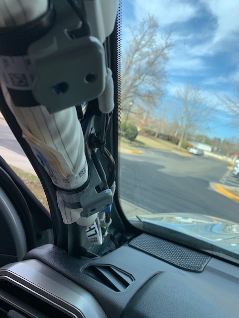

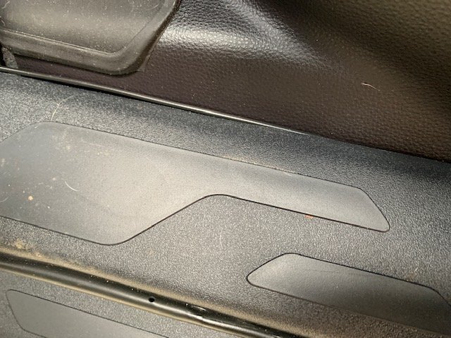

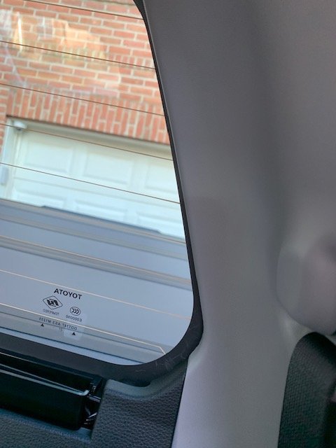

    I got around to installing the rear Viofo cam today and it was easy once my Tacoma memories came back. And the Tundra trim is assembled just like the Tacoma so that helped. First and foremost DO NOT try to run the cable across and through the headliner. Not necessary.
    1. Mount the cam and run the cable into the channel above. Tuck it into the edge of the headliner.
    2. Tuck the cable under the panels. The top of the black rear panel pops open easily to get you started. Run the cable down towards the floor. I didn't tuck it in all the way down because the seat is in the way. Not really necessary here anyway.

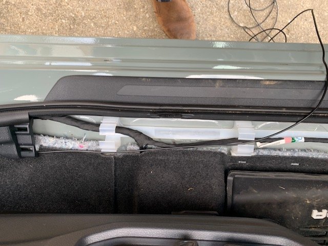

    3. Run the cable forward under the floor sill plates. They pop off easily but really not necessary.
    4. Front sill plate removed for illustration and to remove the kick panel.
    5. I removed the kick panel to get better access to the edge of the panels. Probably not necessary. To remove it pull the plastic knob in the footwell off, then pull the panel to the rear. Run the cable up under the edge of the weather seal.

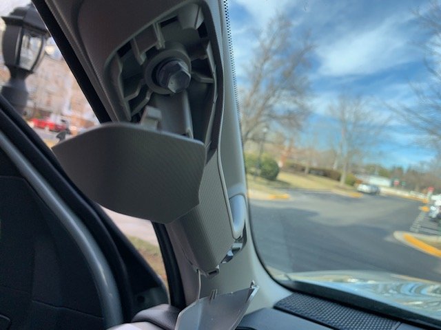

    6. Pop the little caps off the grab handle to access the two 10mm bolts. Remove those and remove the handle. Mine had a lot of blue LocTite.
    7. Pop off the pillar trim by pulling it to right and rear. Run the cable along the other wire bundles. Zip tie them on.
    8. Run the cable under the edge of the headliner over to your cam, then make some loops of the excess and tuck them under the headliner by the pillar.
    9. Reinstall the pillar trim, grab handle and other pieces you removed. Done.

    Thanks for the pics @raylo !! This is exactly what I pictured doing in my tundra. I've done it the exact same way in my other cars, but I was hesitant to start on the tundra because I've yet to see someone post about the process to remove trim panels in the rear cab area.
    The rear window in mine rolls down, so I'm gonna have to get the little trim piece you stick under the headliner to get a surface to attach the rear camera.

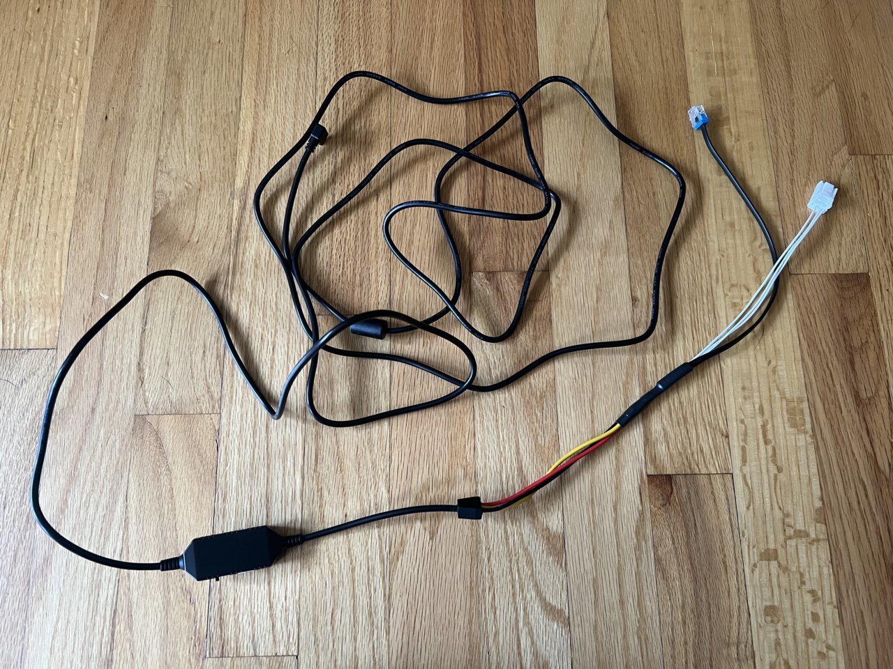

    @Maharisc I've been meaning to ask you since you were the first person here who shared the DIY wiring with the 5-pin connector - since there are the ground, accessory, and constant power wires in the dome light cavity, could we tap directly into those for hardwire kits that normally require taps into fuse boxes? I'm going with the 3-wire hardwire kits in order to utilize the parking mode function as well as set voltage limits to minimize battery drain. If there is enough space within the cavity, that might be more convenient than running wires to the fuse box and using clunky add-a-circuit taps like I did with my other cars.
    Viofo hardwire kit with three wires (ground, accessory, constant power):

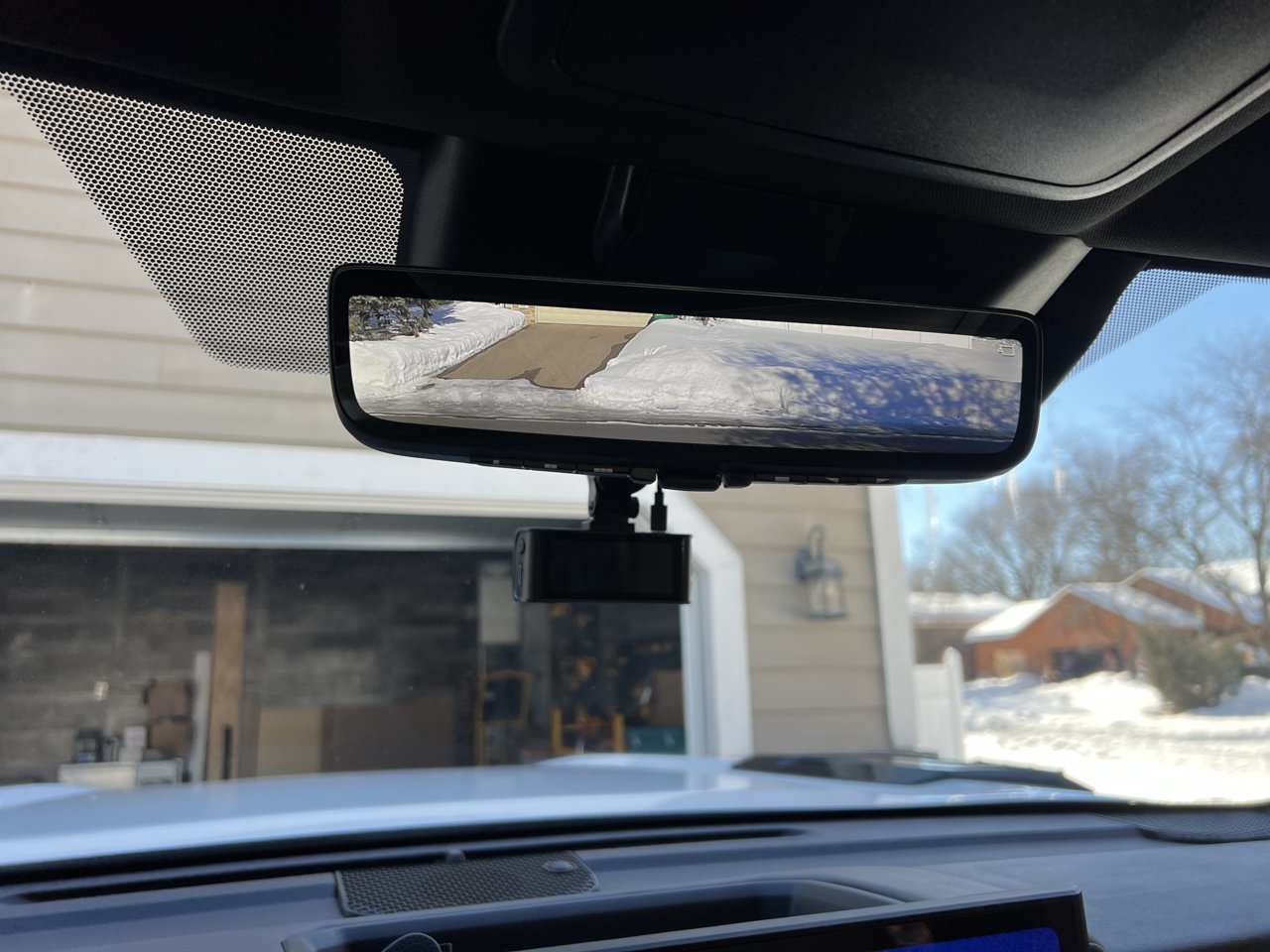

    I made this that plugs into the factory dash cam harness. It has the USB-C for my dash cam and the other one is for my radar detector.

    Nicely done!! Looks very clean too! Looks like the Viofo hardwire kit? Do you plan on documenting the install with pics?

    It is the Viofo hardwire kit. I installed it weeks ago and didn't take pics unfortunately. I just followed the instructions for the factory webcam for dropping the front part of the headliner.
