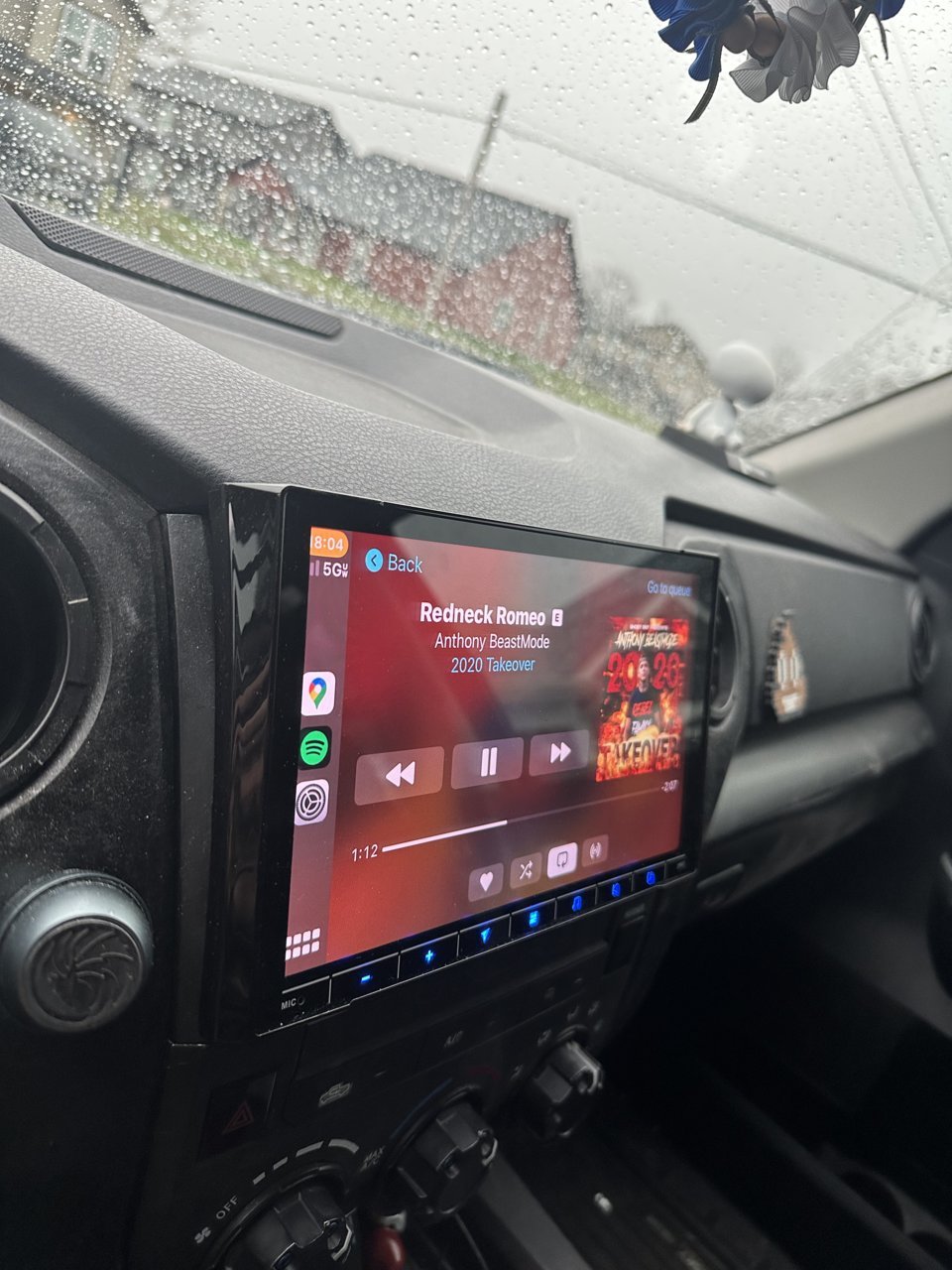

    I am interested to see some pictures of this new model of head unit installed. This is by far the best looking option if the photos on the Dasaita site are accurate.

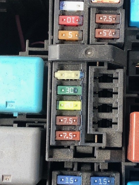

  13. Mar 21, 2023 at 9:13 AM
    #43
    1lowlife
    1lowlife New Member
    May 4, 2016
    #3296
    11,251
    DADA
    THE GREAT STATE OF TEXAS
    2014 MGM DC SR5

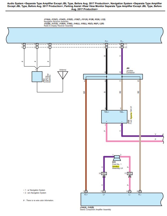

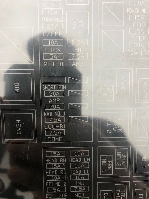

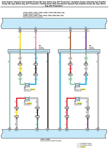

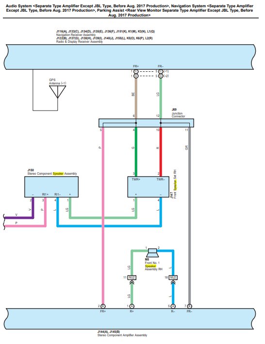

    DId you get this working?
    I'm a little confused about what you have and haven't done.
    There is indeed a fuse for your OEM amp under the hood and it sounds like it's blown.
    My 2014;
    The reason you hear the dash speakers are that they are directly powered by the HU.
    The door speakers go thru the under seat amp.
    It sure sounds like that amp isn't getting power.
    Keep in mind you don't have a rear speaker #2 because you have a double cab
    If you had a crewmax you'd be hearing the tweeters in the rear doors, as they are also powered by the HU...
    upload_2023-3-21_11-10-3.jpgupload_2023-3-21_11-10-23.jpgScreenshot_2023-03-21_111644_7d3cb8dde1bdb0254d33f0a5ca100266dd2f4094.jpg
    As @MedCityMoto suggested, you could certainly bypass your OEM amp using the adapter posted earlier.
    Just connect the speaker wiring output from the HU to the input of the door speaker wiring under the front seat.
    This might help you with that bypass.
    J144 (Smaller factory amp harness) 7 wires
    Pin 1 - Front Right Output to Speaker (+) - Light Green
    Pin 2 - Front Left Output to Speaker (+) - Violet
    Pin 3 - Accessory/Switched 12v [Remote In] - Sky Blue
    Pin 4 - 12v Constant [Power] - Red
    Pin 5 - Front Right Output to Speaker (-) - Blue
    Pin 6 - Front Left Output to Speaker (-) - Pink
    Pin 7 - Ground - White and Black (NOTE: The factory wiring diagram says that ground is Pin 9, but I confirmed that Pin 7 is actually the ground. It is a white and black wire. )
    J145 12 wires
    Pin 1 - Front Left Signal (+) - Brown
    Pin 2 - Front Right Signal (+) - Pink
    Pin 3 - Rear Left Signal (+) - Light Green
    Pin 4 - Rear Right Output to Speaker (+) - Red
    Pin 5 - Rear Left Output to Speaker (+) - White
    Pin 6 - Front Left Signal (-) - Beige
    Pin 7 - Front Right Signal (-) - Gray
    Pin 8 - Rear Left Signal (-) - Black
    Pin 9 - Rear Right Signal (+) - Blue
    Pin 10 - Rear Right Signal (-) - White
    Pin 11 - Rear Right Output to Speaker (-) - Violet
    Pin 12 - Rear Left Output to Speaker (-) - Green

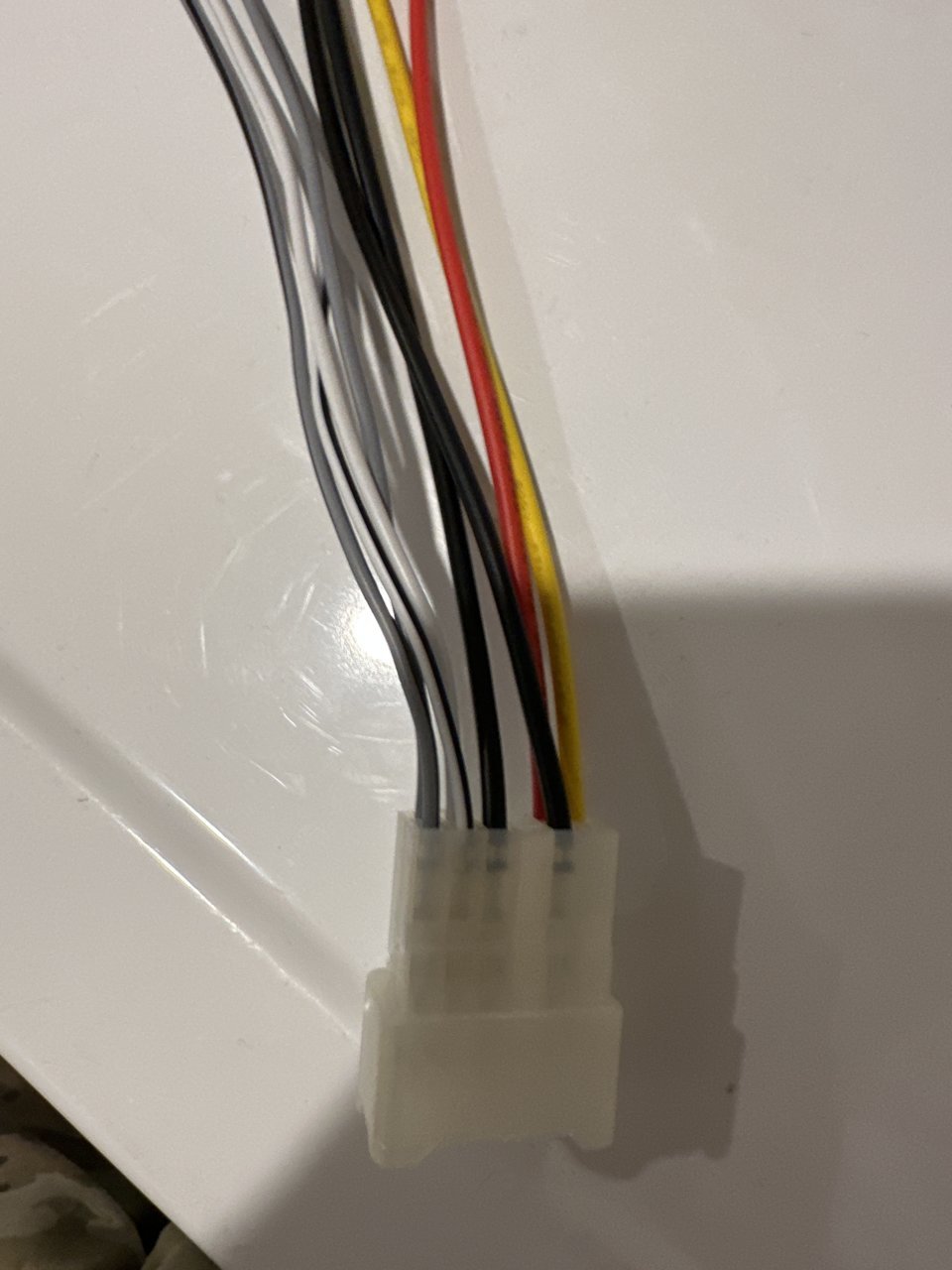

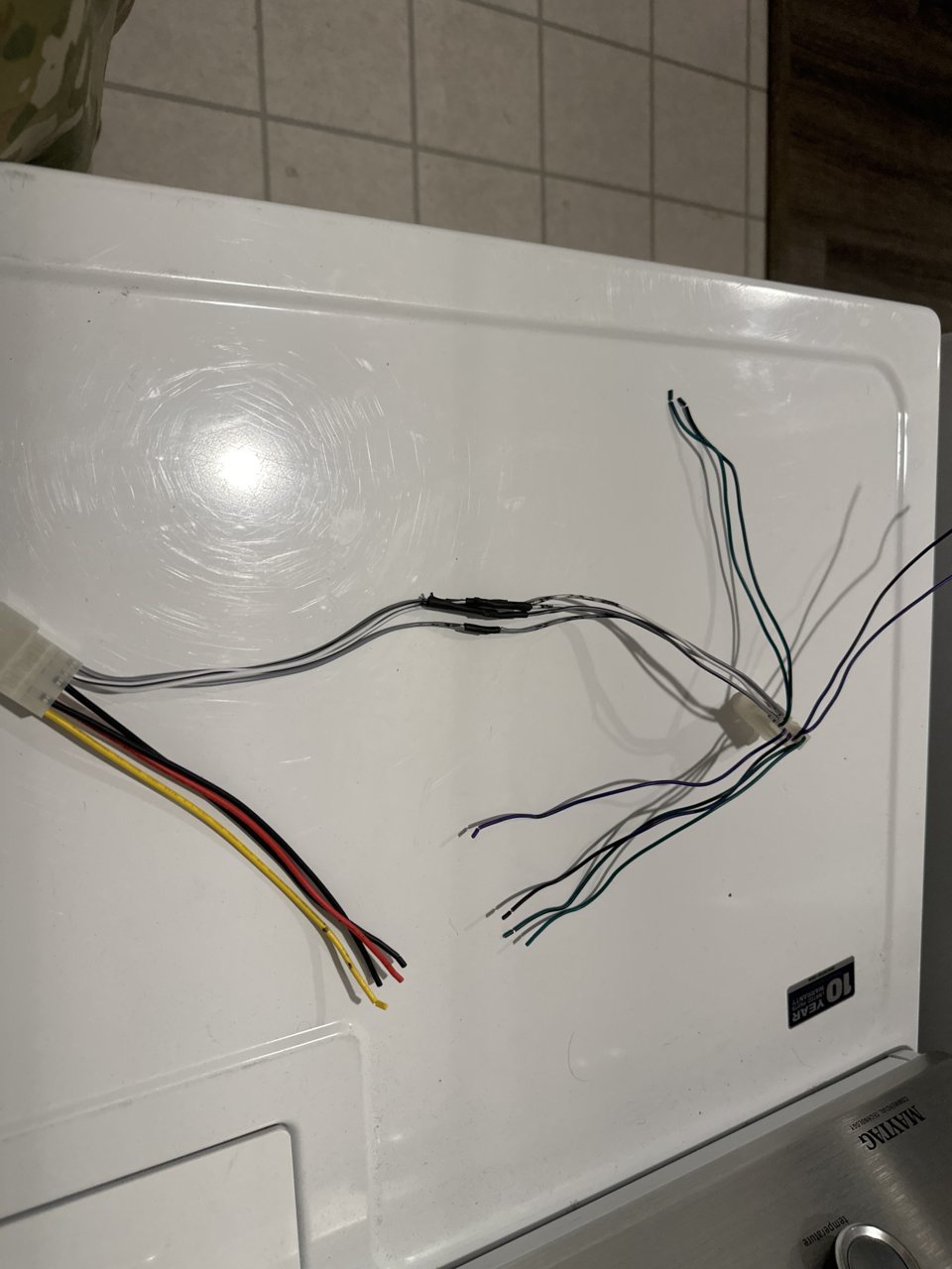

    None of your colors match to the harness ordered to bypass. Small from factory hookup into amp for harness to bypass white, white/black, grey, grey/black, black, black, red, yellow
    bigger harness
    White, white/black, grey, grey/black, 2 sets purple, purple/black, 2 sets green, green/black

    It randomly gets stuck black screen on boot have to unhook battery and rehook up. And it works. Apparently it’s a vivid issue

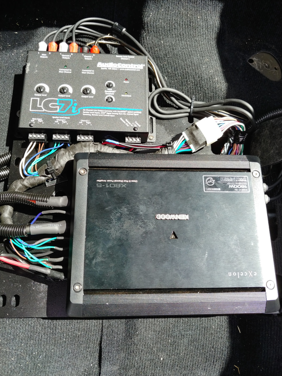

    Pillar Tape, Bullet Liner, 20% Tint, Tyger Star Armor, Kenwood Amp, Tech12volts JL Tweeters, Dasaita G13, Fumoto Valve, Driver Side Grab Handle
    im looking at the Dasaita unit as we type this.
    I also have bypassed my factory amp for this setup. Hoping the Dasaita works well when all done.
