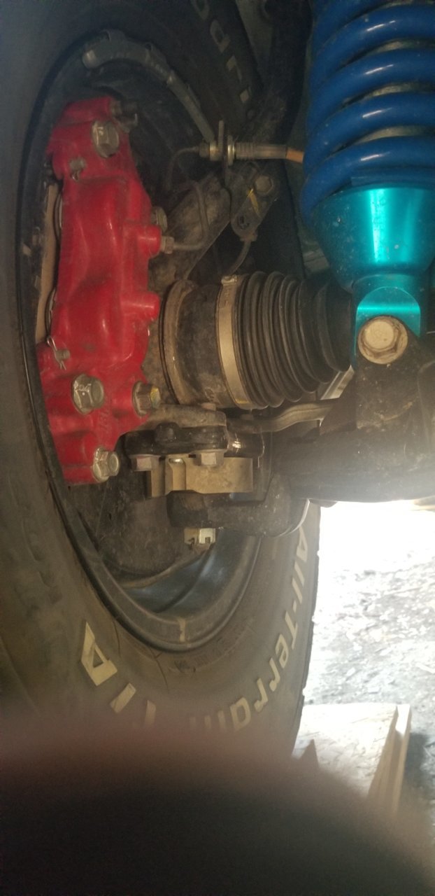

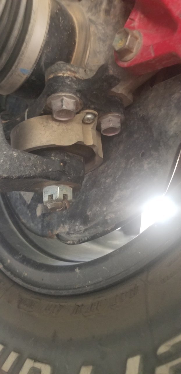

    2004 Tundra DC SR5 4WD
    What do you see wrong with it? I recently got it replaced on recall with the local Toyota dealership which is why it looks brand new.
    I don't know jack about suspensions so please tell me if something looks off about it!

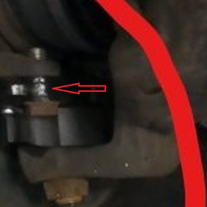

    T150 Lover
    To me it may be an optical collusion but is that bolt loose ?

    2019 MGM TRD Sport D/C
    Ben, you need to take a better pic of that lower ball joint and post it here, it looks like its failed.

    Mumba 18x9 ET 12, BFG KO2, FOX suspension, diamond back HD cover w/ rack, LED head & fog light bulb, TRD rear sway bar, timbren enhancement, RAS helper spring, avs auto shade, Carhartt front seat cover, bench seat cover
    yall smoking something, the lower ball joint nut is on the bottom

    The darkest
    It's really dark
    You're seeing the small bolt poke through the spindle (silver part on top).
    That ball joint has the cover on it so probably Toyota
    It looks fine to me.

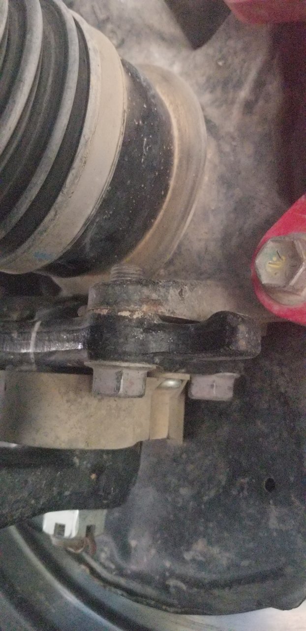

    2004 Black DC Limited 4x4
    Tonto cover
    That's correct, but it looks like the proper rubber boot that holds in the grease and protects the ball joint is missing. Also that protector screws into the LBJ. See mine.

    The SoAz….. big surprise
    Bone stock
    It’s literally the shiny new ball joint that your seeing, rusty bolt head on bottom and bolt poking thru at the top
    Tonto cover
    Am I drunk (possibly) or does it look like their spindle isnt mating with the LBJ like mine is? I don't see any shiny between the LBJ and spindle.
    Bone stock
    I think this is your classic blue dress/red dress or whatever the fuck that was. The secondary pics show a good BJ, play ball!

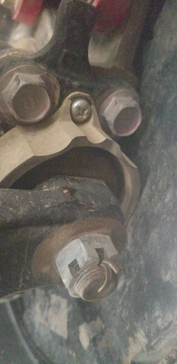

    Tonto cover
    Also that is correct. The LBJ tightens to both the lower control arm and the spindle. The LBJ-to-LCA bolt has a cotter pin so as long as that is done correctly that won't come loose. To me it looks like the bolts that connect the LBJ (and by extension the LCA) are loose. The LBJ and spindle should be closer together. If this is the case, OP is really walking on egg shells. Those four bolts are the main failure point I believe. Unless there is some sort of optical illusion I'm missing?
    Tonto cover
    Yes this might be a blue dress scenario but OP should definitely post some more pictures... I see something wrong unless it's a complete illusion. That LBJ should be closer to the spindle.

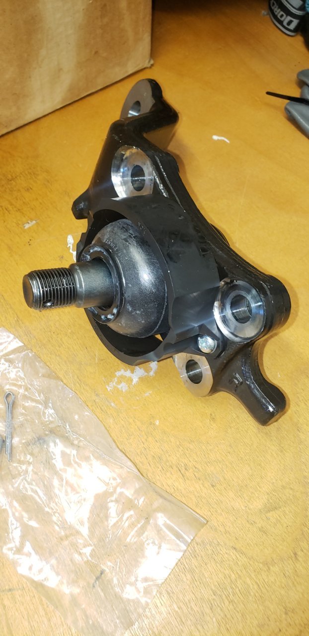

    Zach
    WA
    Closer pictures would help.
    For another visual; here's one from the Sequoia, plus the new kid on the block waiting to get installed.
