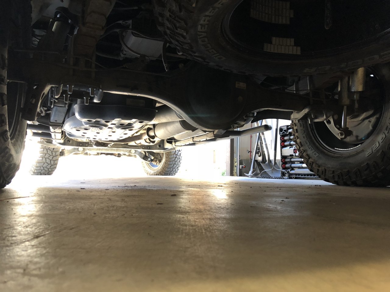

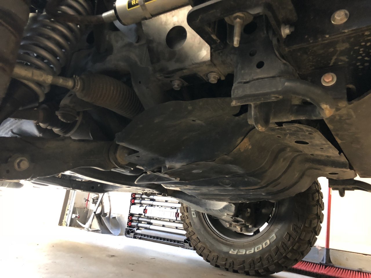

    No more sway bars
    @831Tun No more rock rake:rofl:
  14. Sep 11, 2018 at 6:50 PM
    #314
    joonbug
    joonbug °°°°°°°°°°
    Oct 13, 2015
    #1948
    16,870
    Joon
    NorCal - Dublin
    2020 LT DC
  15. Sep 11, 2018 at 6:52 PM
    #315
    Erichudgins
    Erichudgins New Member
    Apr 19, 2018
    #14593
    2,302
    Eric
    Murfreesboro, TN
    2017 Super white Limited DC
    https://www.tundras.com/threads/the-un-limited-build.25949/
    Been contemplating this....
    831Tun, GiantsFanDan[OP] and joonbug like this.

  18. Sep 11, 2018 at 7:06 PM
    #318
    dcsleeper408
    dcsleeper408 BASTRDS
    Nov 10, 2015
    #2081
    4,947
    mark
    San Jose CA
    2015 TRD PRO
    Where the skids at though!!?!!
  19. Sep 11, 2018 at 7:12 PM

  20. Sep 11, 2018 at 7:14 PM

  21. Sep 11, 2018 at 7:15 PM
    #321
    831Tun
    831Tun heartless Bastrd
    Jun 7, 2016
    #3549
    11,597
    Warren
    Santa Cruz
    '16 CM limited
    You can always put 'em back on but I bet you won't.;)
