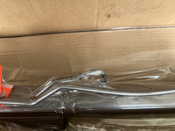

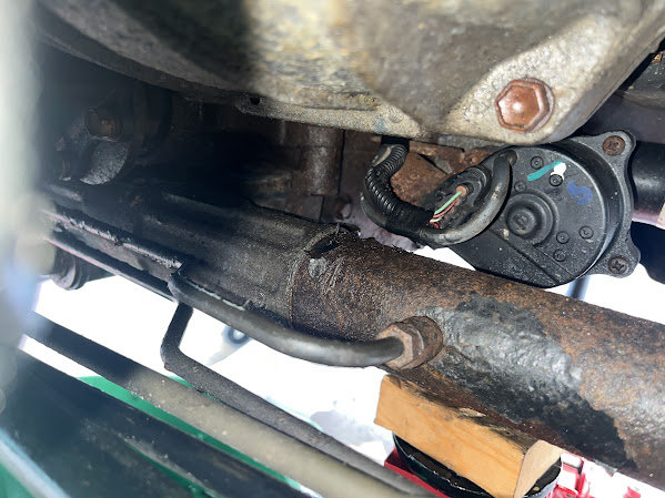

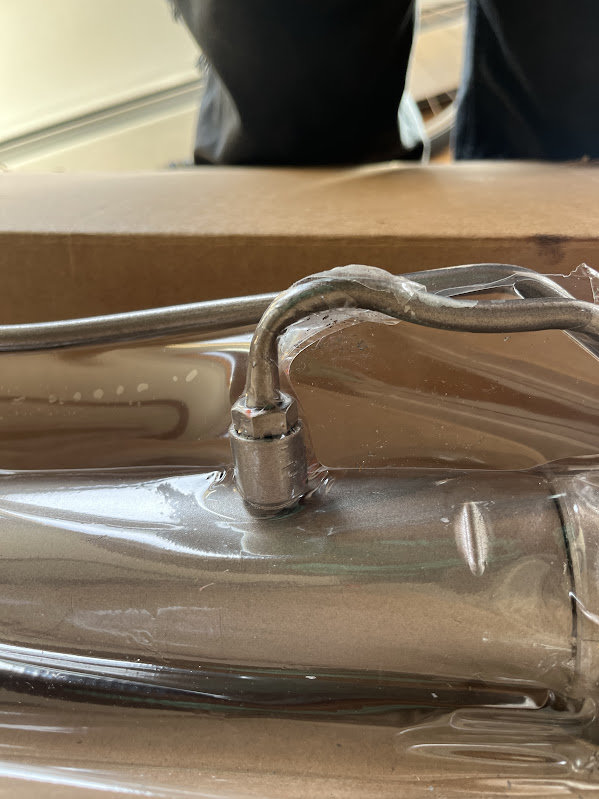

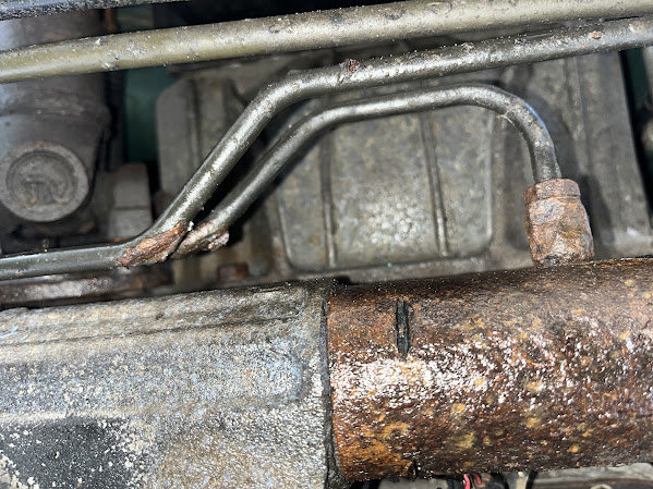

    I finally got around to replacing my leaking rack, and opted for an $630 OEM reman straight from the dealership. I should have checked all this more thoroughly before starting the job, but here I am, completely torn down ready for install, and notice the hard lines on the new unit are all dented up. Seems like shipping damage since the paint is chipping off and there are marks on the lines.
    Any thoughts on what I should do here? If I go demand a replacement, I'll probably be another week+ out. What are the odds the next one's any better?
    Photos of my current lines and the same sections on the new one for comparison:
    I guess there's a chance the routing isn't supposed to be identical on the new one but it looks like dents to me.

    bfunke
    bfunke Tundra Curmudgeon
    Oct 13, 2019
    #37321
    2,490
    South Carolina
    2018 SR-5 CM 5.7, 2000 SR-5 AC 4.7L
    That’s unsat.

  3. Mar 12, 2025 at 3:36 PM
    Tundra2
    Tundra2 Zoinked
    Feb 10, 2019
    #25875
    12,449
    Noah
    Western Kentucky
    That's definitely a flow restrictions, and now a new weak point in the line

  4. Mar 12, 2025 at 3:37 PM
    BeauDacious
    BeauDacious 040 > all other colors
    Mar 5, 2022
    #75444
    522
    Beau
    14 DC 4x
    I'd replace it or see if they have that line in stock and replace just that line on the rebuild.
    The kink in the bend area makes it look pretty restrictive, which isn't the base case scenario in a hydro system.

  5. Mar 12, 2025 at 3:46 PM
    shifty`
    shifty` We call it “riding the gravy train”
    Jun 20, 2020
    #48239
    29,780
    ATL
    '06 AC Limited V8/4WD
    Are any of the lines actually smooshed, other than the narrow sections where the bends are that are already in the rack lines? (I don't think they use mandrel bends)
    If no, then I'd send it dude. You have no recourse now anyway.

  6. Mar 12, 2025 at 3:48 PM
    Dook55
    Dook55 RCLB Guy
    Sep 15, 2019
    #36150
    338
    Montana
    2004 4x4 V8 RCLB 2006 4x4 V8 RCLB
    Flow restrictions in pipes are measured by the foot, meaning that the restriction will only affect that small area. My guess is that you would never notice it driving. If I'm wrong, you can do as BeauDacious suggested.
    As far as weak spot is concerned, as long as it wasn't bent back and forth several times, it will likely hold until the next ice age.

  7. Mar 12, 2025 at 4:43 PM
    Green00SR5
    Green00SR5 [OP] New Member
    Feb 10, 2024
    #111755
    48
    2000 Tundra SR5 4WD 4.7
    Thanks for the replies everyone. I ended up just racing over to the dealership before they closed since I figured showing up all greasy and annoyed would be more useful than a phone call.
    I explained the situation and after 15 minutes or so they agreed to expedite me a new one and said it should be here by Friday. It escalated through a few rankings of people over there, but nobody was very argumentative about it.
    I was worried about flow restrictions as well, though if I had to guess I'd say there's a good chance it would have functioned normally. Was mostly an issue of splurging for an expensive dealer part only to end up with something that was obviously maimed in shipping.
    I'll update this thread when I get the new one and keep some tabs on how it's workin. I know people have had some mixed results with the reman's, it took a lot of research and coin-flipping to go with this option in the first place.

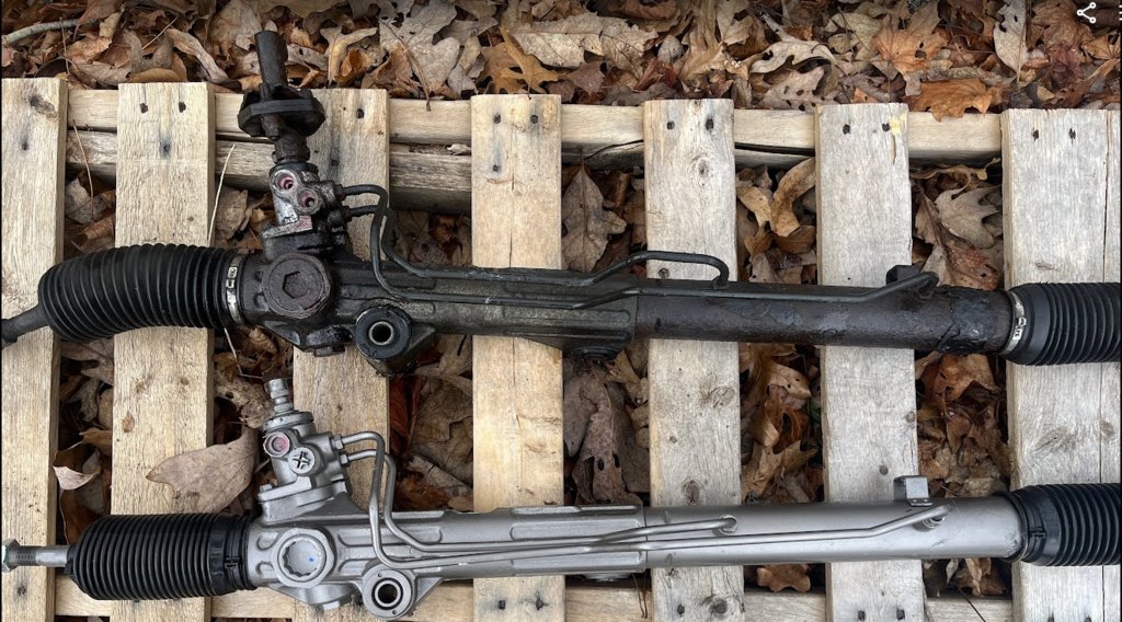

    Update:
    Bit of an overdue follow-up, but I wanted to give an update on the situation for anyone else rack-shopping.
    The replacement showed up quickly and had the lines straight, but I will say I was very surprised by the seemingly low quality of a $700 dealership reman. Mostly superficial, but the whole thing was shoddily oversprayed in this chalky silver paint, even over the splines and rubber. The boots were also clamped on with plastic zip-tie style clamps that were barely tight instead of the original metal CT clamps. I went ahead and swapped the old ones on which wasn't difficult.
    I was expecting something more like in this post, which appears to be a bit smoother around the edges, and painted like an original unit.
    The install and bleeding went fine, I replaced the rag joint, bushing, and all of the hardware while I was in there, and so far it's been leak-free, and noticeably more precise. Steering effort didn't really change, a little heavy but not bad for an old truck.
    Only big thing I would recommend is be very careful to locate the center of travel before installing. I thought I was, but ended up with the wheel a good 20 degrees off center, which I was able to fix with the outer TRE's
    The main reason I went with Toyota was for OEM inner tie-rods, and just the general fact that it's a high-force, safety-related part. Time will tell, but after getting my hands on it, I can totally see how one of the new builds from rockauto/detroit axle would make sense for half the price and a lifetime warranty.
