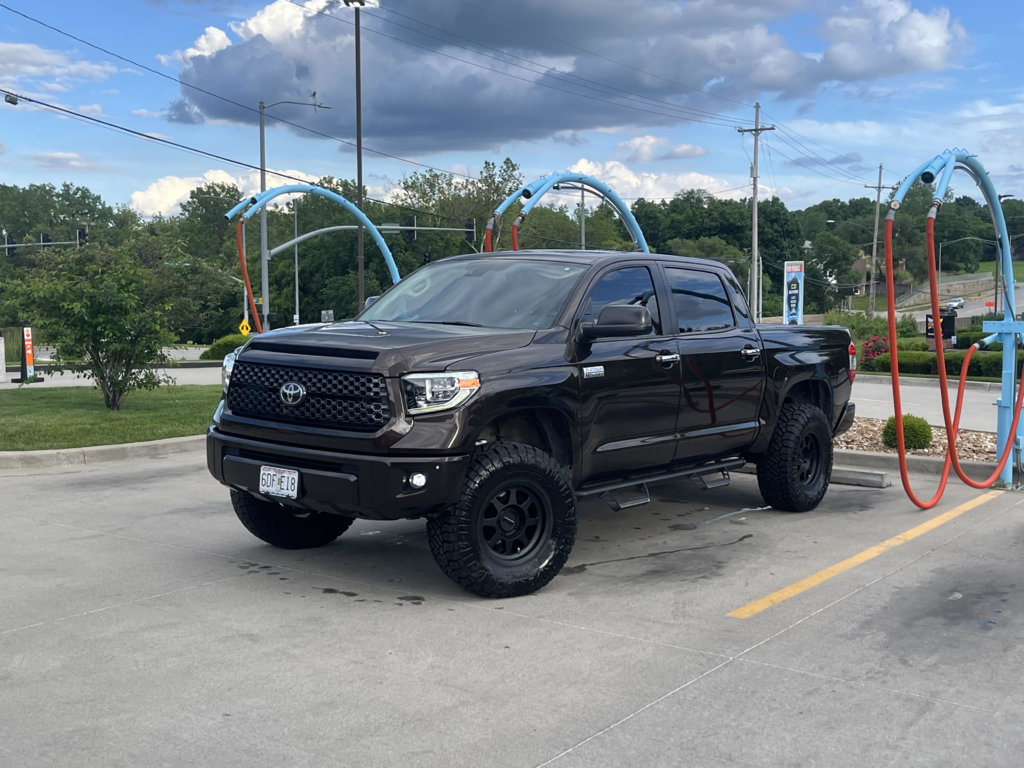

    Finally done! I noticed the sides diverge slightly but I chose not to change it to give some room for flex as Rough Country calls for minimum of 0.5" anyway.

    I appreciate it. It's called Smoked Mesquite. I considered doing the washer method after the fact since I didn't realize the divergence until it was all tightened up. I was too focused on making sure gaps on both left and right were even. But it really doesn't bother me too much so I may just leave it.
    As for the DD lights, I did similar to you. (thanks for the idea) I used the supplied brackets and extended them with weld tabs (one side longer with 2 holes and one side shorter with one hole). It's not perfectly straight on the road but from all I can see from testing and messing with it, its very similar to stock fogs (in direction) but brighter and no blockage from the opening. I mounted only on the single (middle/front) hole and between the knurls on the diode dynamics side, the Line-X friction and the lock washer, it doesn't budge. Time will tell once I get more miles. Thanks to you and Sumo for all the help.
