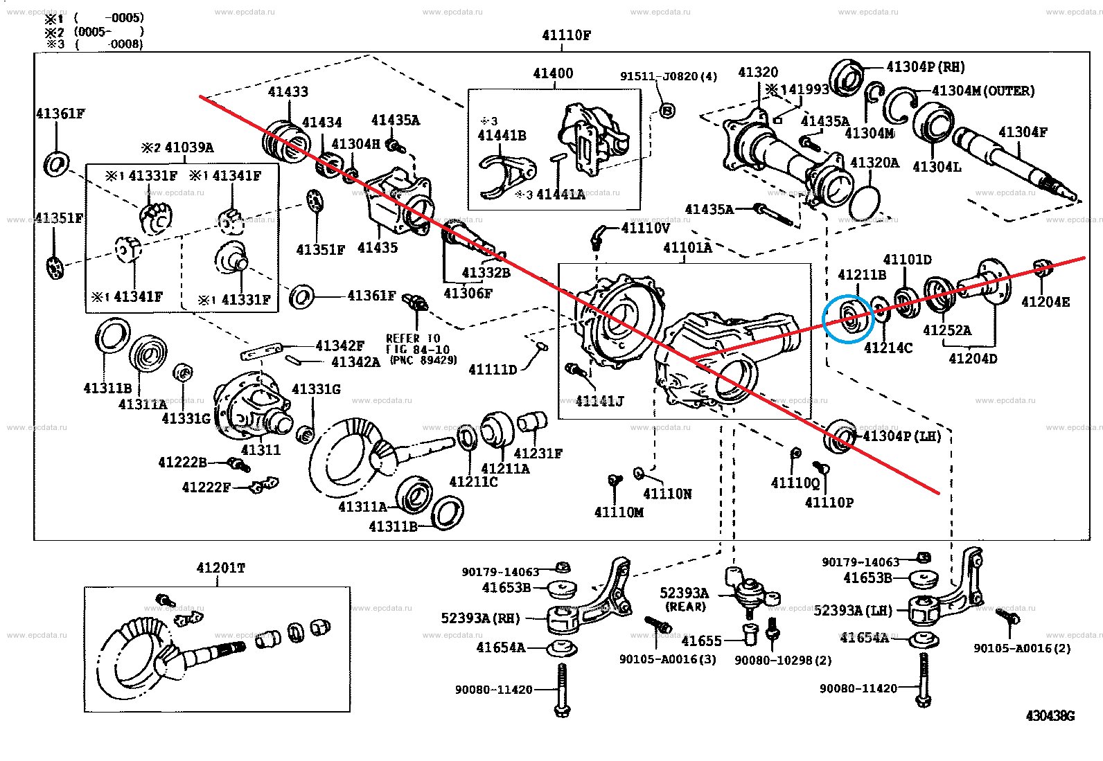

    I mean, typically any driveline output where a shaft is involved, there's going to be a bearing somewhere. Whether it's the needle bearings for the CV axle output, where the diff meets the front driveshaft, where the rear driveshaft meets the diff, etc.
    The front diff is no different. Where that front driveshaft inserts into the diff, there's basically a pinion bearing, I'm circling it here in blue, the part number for our '05-'06 is 90366-30078 and Koyo is the OEM manuf'er for that specific bearing. I've never checked for play on mine.
    But I don't think I've ever seen anyone on here say that bearing went bad on them. However, I have seen people bitch about the seal going bad (41101D in the pic). Let me ask you a stupid question: Did you check the front diff fluid at the drain plug to make sure it's topped off? Just wondering if you may've tossed the seal and have been running it low? Not sure if that's possible with front diff. Diffs and transmissions aren't my cup of tea, I can't deep dive on that shit.

    Gotcha yeah no leaks at the seal and I noticed not many forum posts on play at this spot either! As you said u joints seem to be the common factor for play in the shaft but they seem to be OK when trying to get some wiggle out of them by hand. I should have added that I topped off the diff after installing the ECGS. I checked for wheel bearing play but there wasnt any. I can hear a rotational kind of metal on metal noise though that could be part of what I’m hearing when turning the wheel by hand. Definitely coming from the hub. I added a video of the front shaft/diff flange to better illustrate the play not being within the shaft but where it meets the diff. There was no play on the transfer case side of the shaft all movement is forward. Threw in a video of the hub noise while turning the tire by hand. Perhaps the shaft/diff issue is my 4WD noise and my 2WD groan is an issue in the hub but the 4WD noise is so loud it drowns out the hub noise…

    At first I thought the metal on metal rotational noise in 2WD was being amplified and made worse in 4WD. But they ended up being separate issues. After doing a handful of tests after changing diff fluid, ECGS, axle, oil seal, diff drop and lubing drive shafts I did end up recreating the 2WD noise which was just brake drag as Toyotadude pointed out. The front drive shaft was fine according to the shop and he showed me the pinion bearing today. The inner diameter of the pinion bearing was worn bad and showed some markings starting to be engraved/metal shredded on inner race where the ring gear sat. All noise is gone today in 2WD and 4WD for the first time in months. Thanks everyone!
