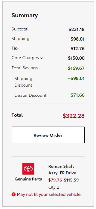

    Cheapest I can manage to eek out within 2 hours drive from of Atlanta is $79.76/ea at World Toyota. I'd do it if I had some acceptable cores.
    But the site is also saying these won't fit my vehicle. Although I double-checked and the original part is definitely 43430-0C010, so 43430-0C010-84 should be 100% correct.

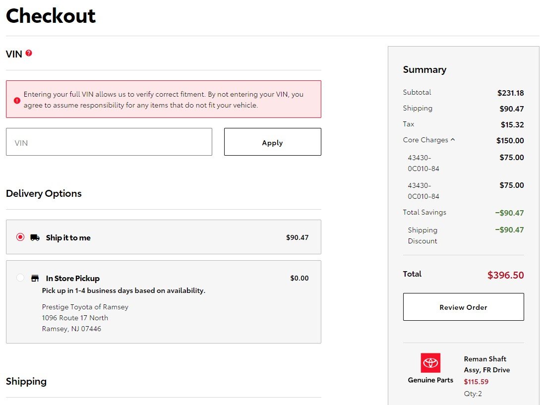

    As @des2mtn said - from Toyotapartsdeal: "Your order has been voided because of the following reason(s): The ordered part(s) have been discontinued (no longer available) and/or is backordered with no ETA date by the manufacture."
    Some area dealer sites show availability - called the local dealer, no stock and none at depot. System showed 3 @ Boch (Boston) but web site showed none. Called and they had 2 on the shelf, which they updated the site for the order.
    $70 ea.

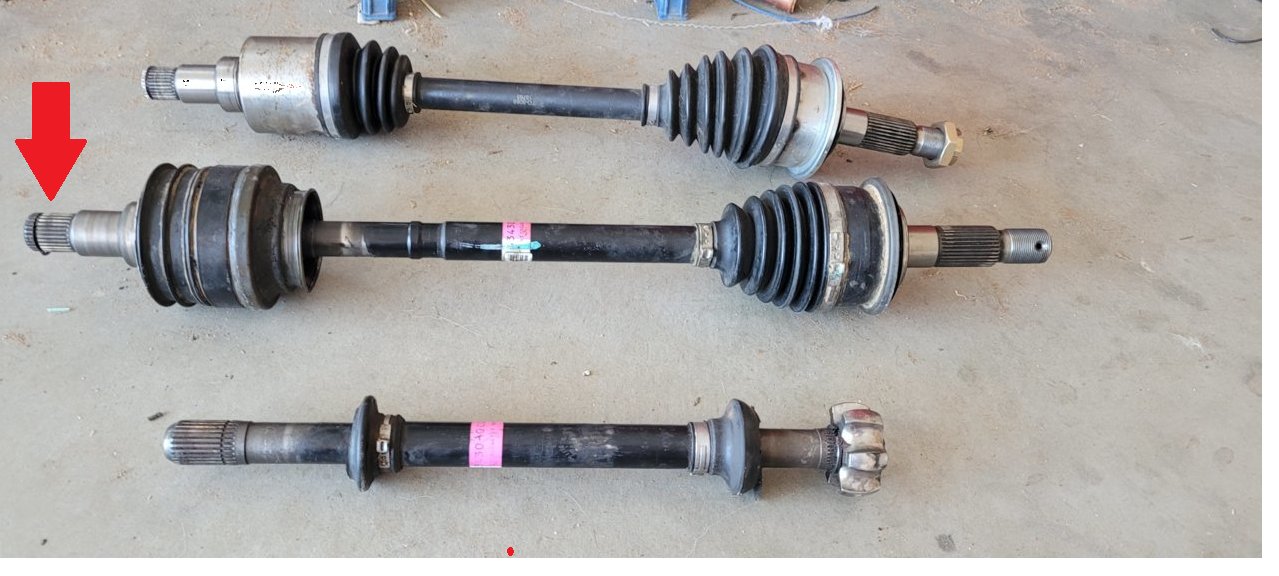

    This works for the passenger side that's a PITA to get out because of the clip that is inside the diff correct? different way of same process I assume.

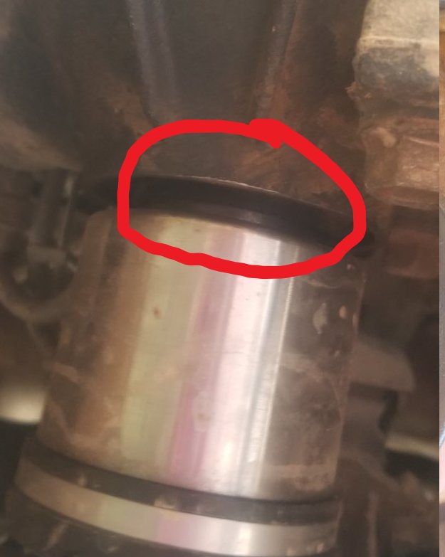

    Both axles have a c-clip on the diff side that holds the axle into the differential and they both come out the same way. You have to pry on the the axle, maybe give the pry bar a smack with the hammer, and make the clip on the splines compress to get it out.
    You want to be a little cautious of how you pry out and not mangle the axle seal in the diff though. Pry outwards on the CV and the screwdriver can hit the lip of the diff housing. You can see where my pry bar has rested before.

    Yep, get your pry bar in-between there (diff housing and axle housing, tip of pry bar on the CV, like des said) and rotate the axle as you pry. You need to be gentle, but firm when prying (if that makes sense), and you'll know when you hit that sweet spot.

    Ok, so that black piece in his last post is the seal i'm trying not to destroy? I'll climb under mine in a min. So, this prying and tapping essentially just pops the little clip past where it sits to get the axle out correct?

    Correct. Well that and the C-clips, you use too much force and break those in the diff and you're gonna have a bad time.
    The seal is recessed in the diff housing, so as long as the tip of the pry bar is on the cv housing, it shouldn't hurt the seal. What will hurt the seal are the splines of the shaft (if you drag it over the seal as you remove or install) and the weight of the axle itself (if you accidentally drop the shaft on it and squish it).

    Order the remans yesterday. Got a voicemail from the parts guy today saying that they don't want the old ones back and they credited the core charge, so Toyota is done with rebuilds.
    @metalpete & @des2mtn - thanks for the directions, looks pretty straight forward and is sounds easier to pry them out instead of hammer/drift as in the FSM.

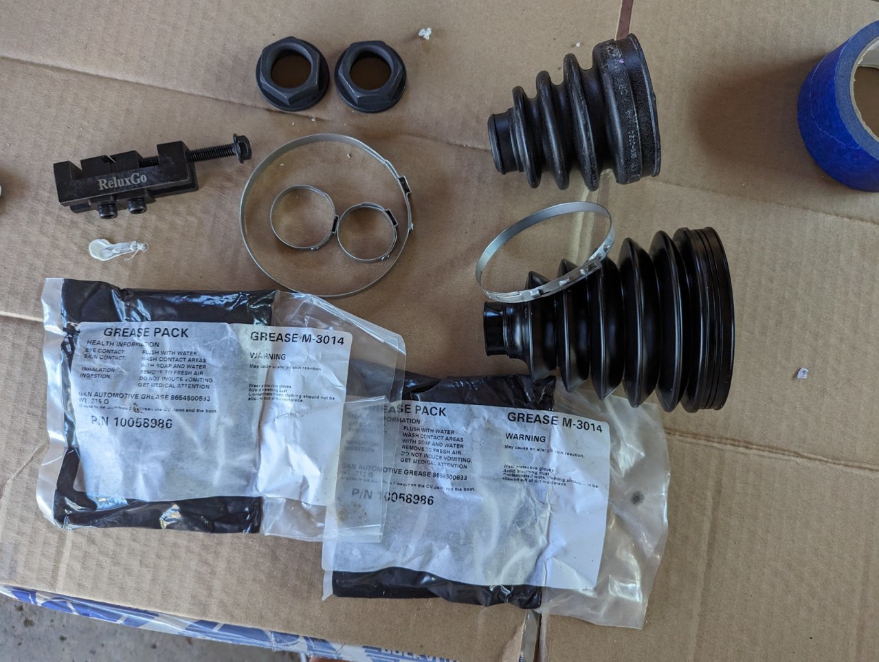

    Awesome. I just got the boots and grease I ordered today, inner boot which I need to replace because of rip is a good rubber quality outer boots seem more plastic-type.material. grease is same on both kits both packets have same part #..so I guess the grease doesn't matter anymore like videos show 2 different types?
    Where did you end up ordering from @Richid ? Have they actually shipped? I so would've got remans but just couldn't find anything obviously from my previous posts on this thread.
    Edit: I forgot to add that apparently my year truck doesn't have the type of axle nut that requires being set with a punch like we see in most videos. Picked up 2 new ones today from local stealership double checked when I saw the thickness, he showed the diagram on his screen. I really couldn't remember from last time I was that far in the hub so.i just took them anyway. Appear to be 35mm, measures about 1-3/8".

    @Hi06silver - I saw some reman listed on the dealer websites so I called my local dealer. The local dealer saw that the depot stock was empty and a ton of backorders, but it showed that Boch Toyota had 3. The parts guy down there said they have them and he would update the 'discount, ship only' site so I could order them. They accidentally cancelled my order and when I called back, he said he pulled the 2 they had on the shelf and put them in shipping. Created a new order and they shipped today. That's when they left the VM saying that Toyota doesn't want any more cores back and to keep them.
    So - if anyone is thinking about getting remans, you should probably call around now before they're all gone as it looks like whatever is in dealer stock is all there is.

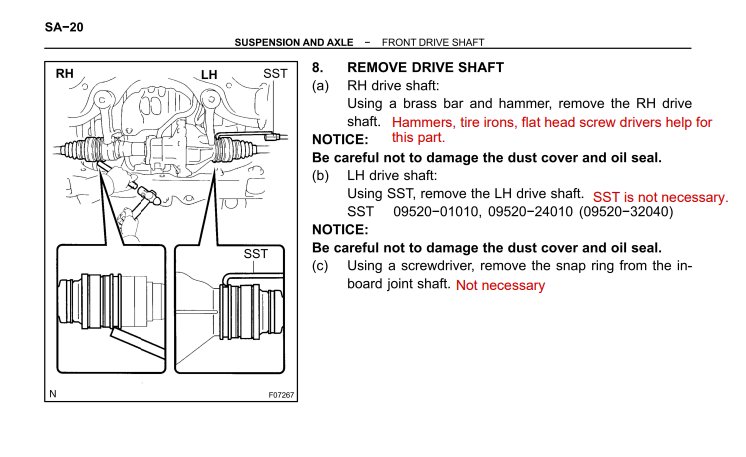

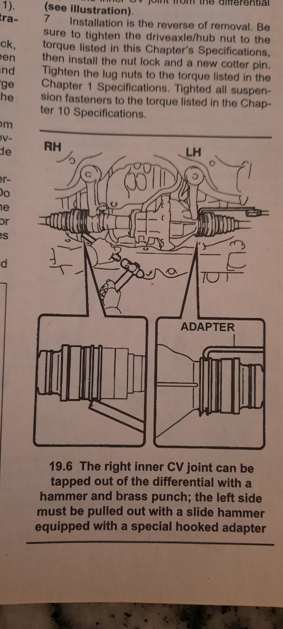

    There's reference to needing a slide-hammer with a hook (or something) to remove the driver's side cv, but I've never needed to use one.

    Just posting a follow up. Dealer called back and said Toyota doesn't want the cores back, so 2 for $185 including shipping. Put them in a few weeks ago.

    Sweet! Where'd you order from?

    Boch in Boston had two sitting on the shelf. Had to call so they could update the inventory on the web site so I could get the discounted price.

    Are these boot stretcher tools a gimmick, or legit? Like, am I missing something or could you replace your inner boots on perfectly good axles w/o having to pull the actual axle out of the diff?
