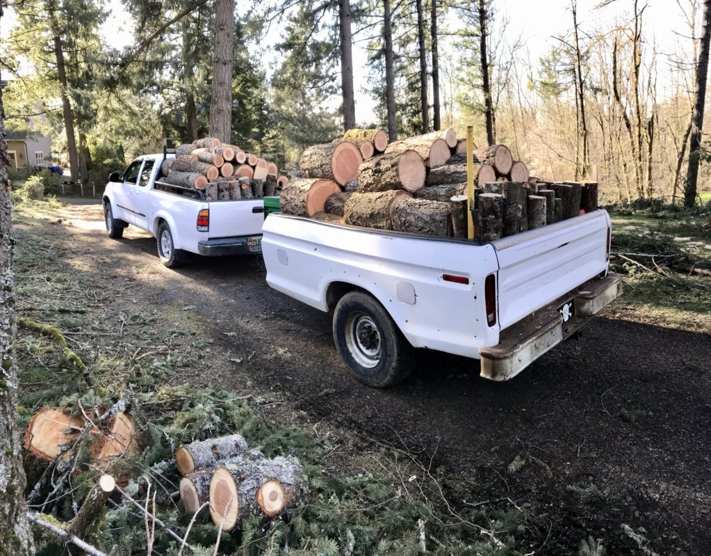

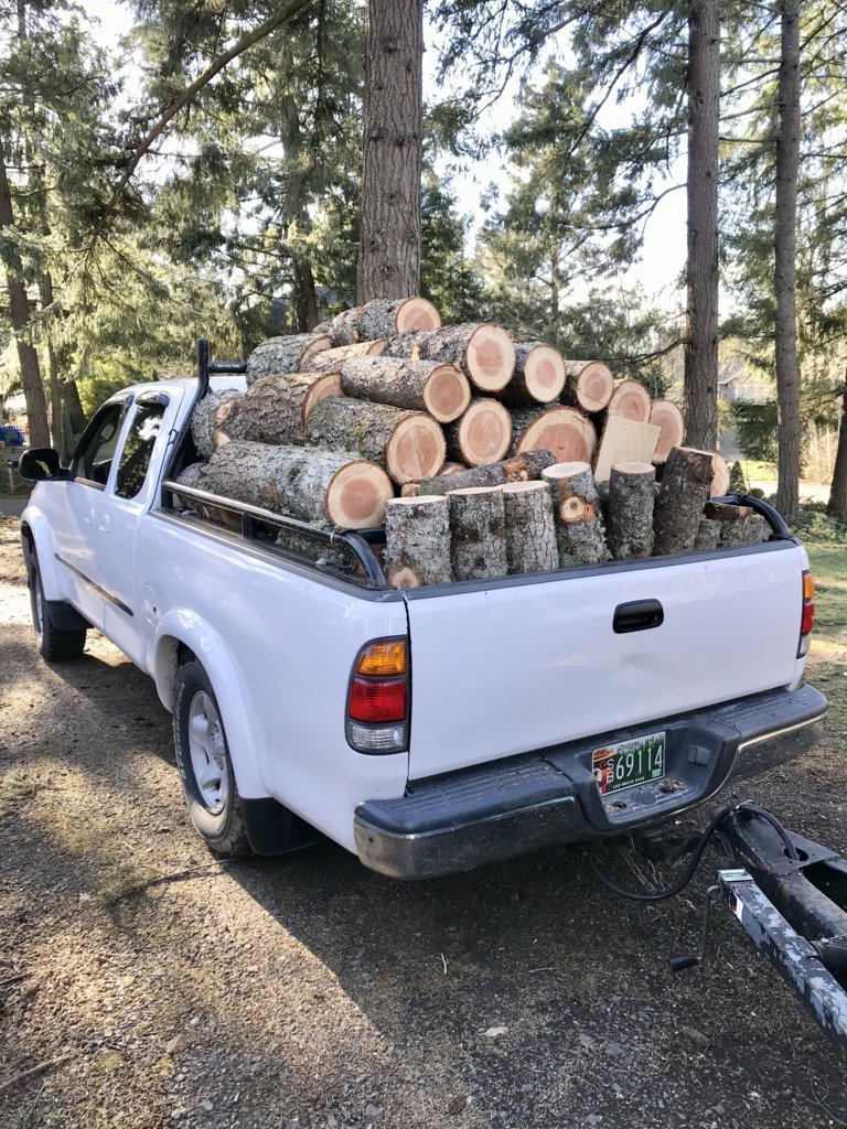

    This is my tundra chocked full of wet doug fir. I don’t know how many tons it is, but the axle was squishing down the bumpstops when the bed was less than half full. I then proceeded more than double the load. I then hooked up my 8’ trailer to the tundra. There was LOTS of tongue weight on the hitch. With no trailer brake the truck still seemed to stop well enough. And that’s with the front tires almost wanting to come off the ground.IMG_9805.jpg IMG_9804.jpg
