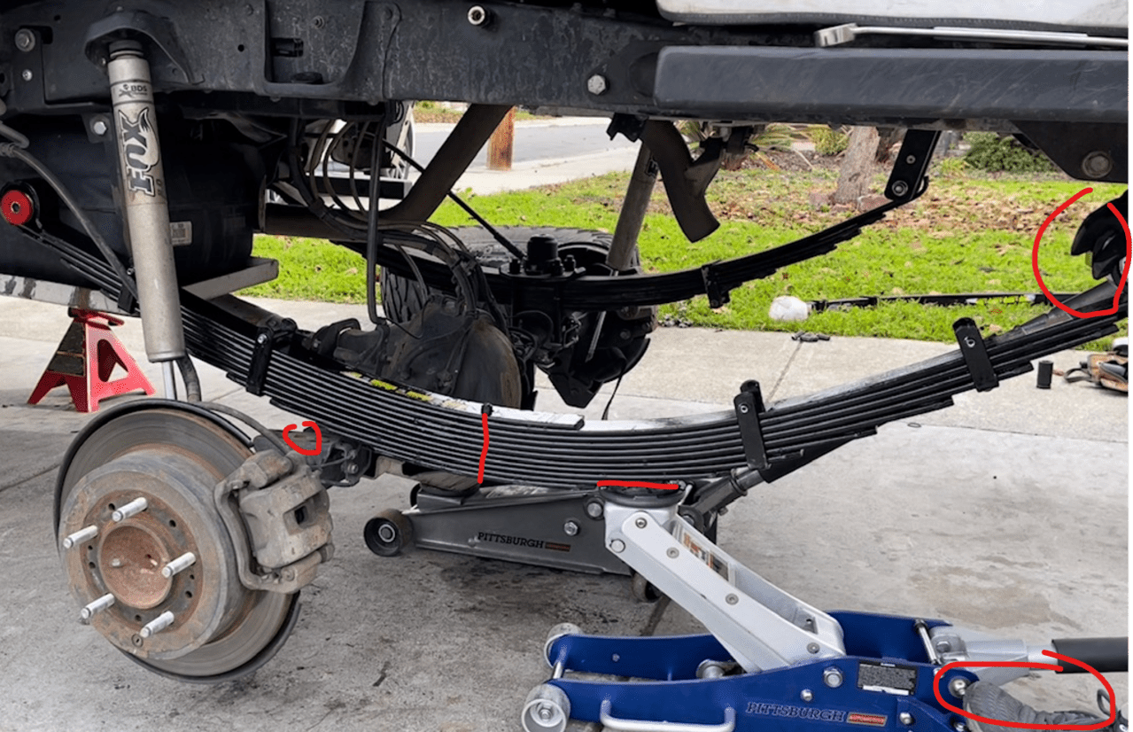

    This is how I install leaf springs by myself.
    I line up the floor jack inline with the frame hanger. Place the leaf pack on the jack but offset so you have room to place the pack onto the perch. Using my hands to balance the pack and my foot to push it in. I get the pack right above the perch and drop the center pin into the hole. My leaf pack was 110lbs, this made it easy, and avoided pinching the ABS wire (which I've done a few times before using this technique).

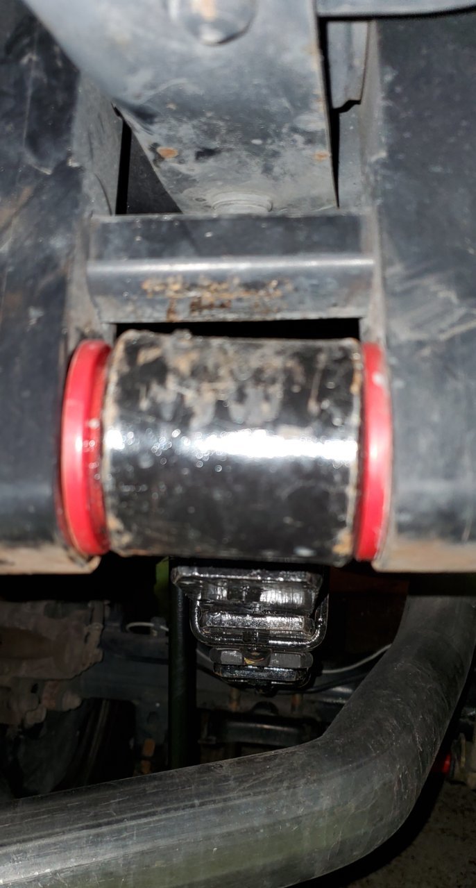

    So mine pops when I start backing out of the driveway in the morning. It will only do it then. When I pull back in, it will do it again after it sits for several hours. It does not do it when I am backing into a space at work. My Toytecs are torqued at 74 ft lbs. What he wants me to do is loosen the nut on both shackles and then back down the driveway to see if it still does it. He is wondering if the torque on the shackles is what's causing it. He also said that someone else called him and has the same exact issue...only backing out of their driveway.

    Interesting….not familiar with Toytec shackles but do the shackles compress to where they are rubbing against the spring or does the bushing protrude out enough to prevent rubbing?

    Mine doss the exact same thing. Have you tried out his suggestion? My CB shackle doesn't hug the bushings like your Toytecs do. They're more of a H shape where yours bow in a little. I thought that could be a factor...but if you also have the sound...

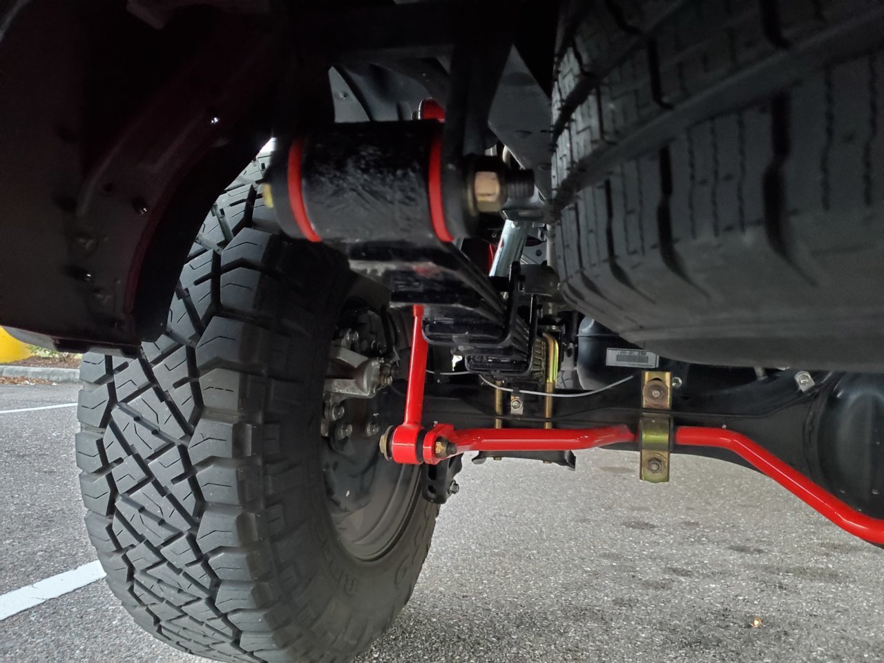

    Chilly here too but my ass got stir crazy and mounted the anti-sway bar.
    Here is my shackle shot. My driveway has a sloping, twisted grade to it so my truck always sits with mild articulation.

    I'm giving it another few days to see if it comes back. The front eye bolts and ubolts are torqued to 90 ft lbs. My shackles were torqued to 74 ft lbs. I loosened the nuts as suggested and I could see the shackles creating some space between the shackle and the bushings. I rolled back in neutral with the truck off and no pop. I retorqued them to 65 ft lbs and no pop that I can hear. My neighbor said that he heard it pop but he could have been messing with me....he does that at times.
