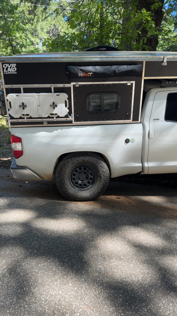

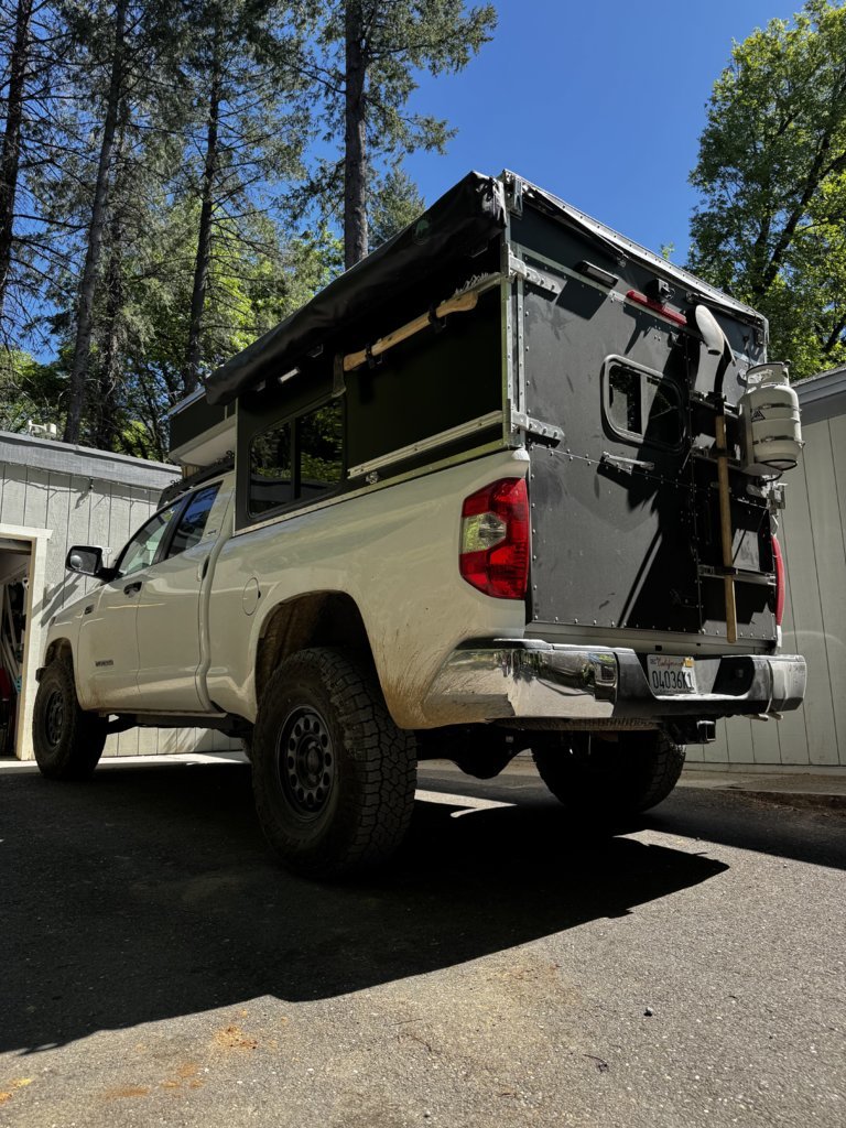

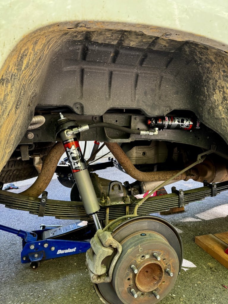

    I just installed a custom pack from Alcan, with +1400# carrying capacity and a set of Fox 2.5 Performance Elite shocks. The whole experience was great, and the quality of the springs is top notch!

    Nice setup! Looks like you ended up going with Alcan's u-bolt flip kit with bump - happy with the fitment/install? Alcan shackles or something else? Lead time pretty consistent with what was promised? Spring rate looks right on the money for all the extra weight, good stuff!

    What torque values did you use for the leaf spring install?

    Yeah I did the Ubolt flip kit, their bump stops, and their two position shackles. lead time was spot-on, I don’t remember the spring rate off the top of my head, but they nailed it.. @Tundra234 haha, I’m terrible at remembering shit at the moment, so I don’t remember the torque specks for the Ubolts or shackles, but they provided those specs. Something like 65ftlb for the shackles and front spring bolt, and 84ftlb for the Ubolts. And I have re-torqued them a couple times since the install. Equally impressive was working with Accutune suspension on the custom valving for these Fox shocks. The whole package works together incredibly well!

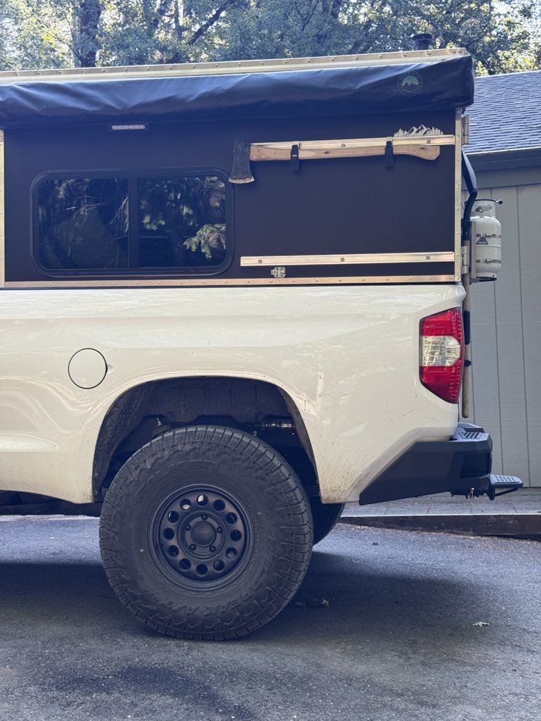

    Stuffing those 37’s!
