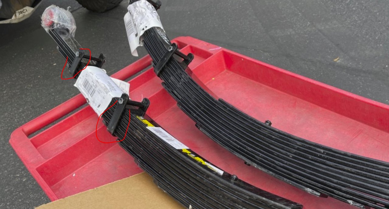

    Have you seen these?

    Interested to see how this works for you, I might need to do something similar. How long are you going to make each piece?

    I tried something similar - no worky.

    Long enough so that they get held in place by the brackets because they will likely rotate out of place.
    We will find out at T2S if this works.

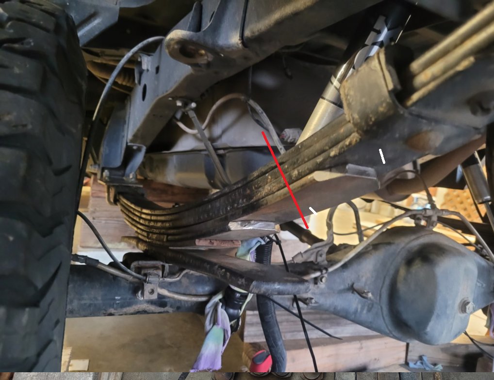

    I just finished adding two more tundra leaves to my truck for a bastard pack and I added the OEM metal plates from that leaf pack. Sprayed WD-40 dry silicone in between the leaves. Will see how it does at T2S. After seeing this, I kind of wish I did something like you're trying. Curious on the results for sure!

    Curious about your "bastard pack". I need to boost my load carrying a good amount and do not want to pay $$$ for a custom pack. I was going to add a short and long add-a-leaf with long travel air bags for tuning.
    Did you cut down the leafs? Photos?

    I initially put a poor quality add-a-leaf in my truck years back and both of them broke. When I took my pack apart, I actually left them in place and cut two of the leaves from the other pack to stack on top. I was toying with the idea of taking apart my main pack and putting a leaf in between the three there, but decided against it for now. If I want to do that in the future, I still have the main leaf from the donor pack.
    I'm also running clamps in front and behind the axle where the broken add-a-leaf ends.
    This is how the pack looks with the two new leaves in, I will likely add a clamp where the red line is.
    At bare minimum I would get 1/2" of lift from the new springs but overall it netted me 2-1/4"ish inches, I'm expecting it to settle some however.

    I like it! Boise Spring does something similar to what you have when beefing up rear leaf packs. They remove the overload though, and then add 3 additional leafs below the regular pack, that are staggered but pretty close in length as I recall. Maybe I can find a photo. Looks like the add-a-leaf is curved a lot more than the Tundra leafs; that's why it broke. Stupid way to do things, you want them all the same.

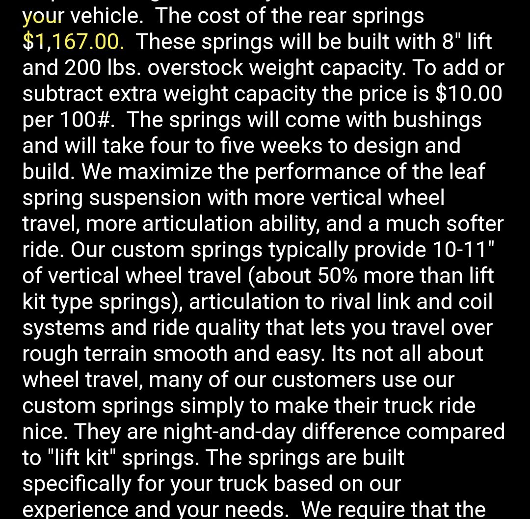

    huntsonora
    huntsonora New Member
    Jun 6, 2021
    #63963
    95
    2006 Toyota Tundra DC
    What are y’all paying for your Alcans?
  18. May 6, 2023 at 10:31 PM
    #408
    Tundra234
    Tundra234 New Member
    Nov 30, 2018
    #22402
    18,466
    George
    Florida
    2020 Tundra DC SR5 Barcelona
    Alot of them
    IIRC, mine were around $1100 shipped.
  19. May 6, 2023 at 11:38 PM
    #409
    blenton
    blenton New Member
    Jul 15, 2022
    #80740
    3,259
    I was quoted $1178 + shipping from Alcan.

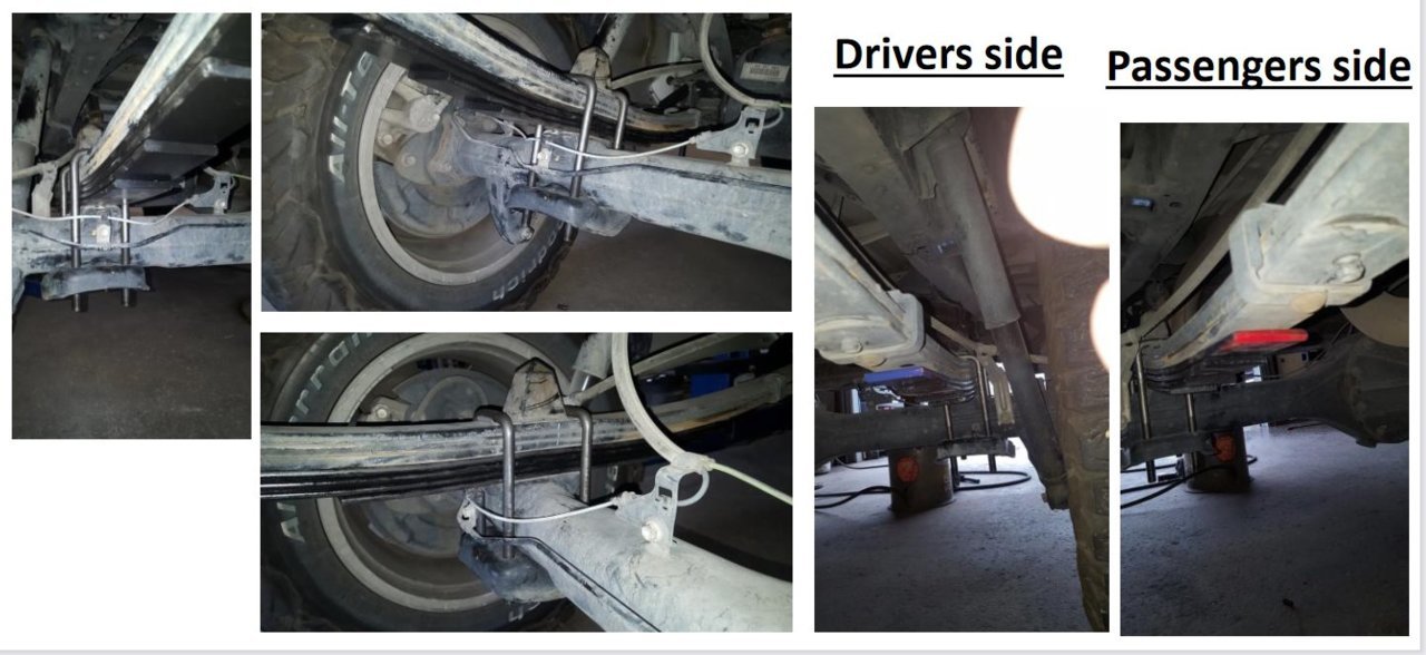

    I solved creaking/squeaky leaf pack on my Tacoma with a ziptie. Cheap and easy, worth trying maybe if the noise really bugs you. Near rear end of one of the middle leaves that didnt already have a pad between them. Just pry apart and slide a ziptie in and pull it tight on that 1 leaf.
