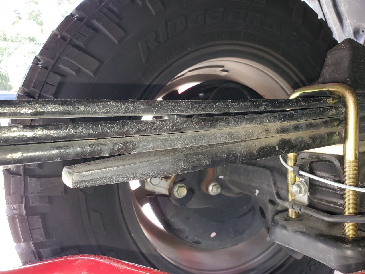

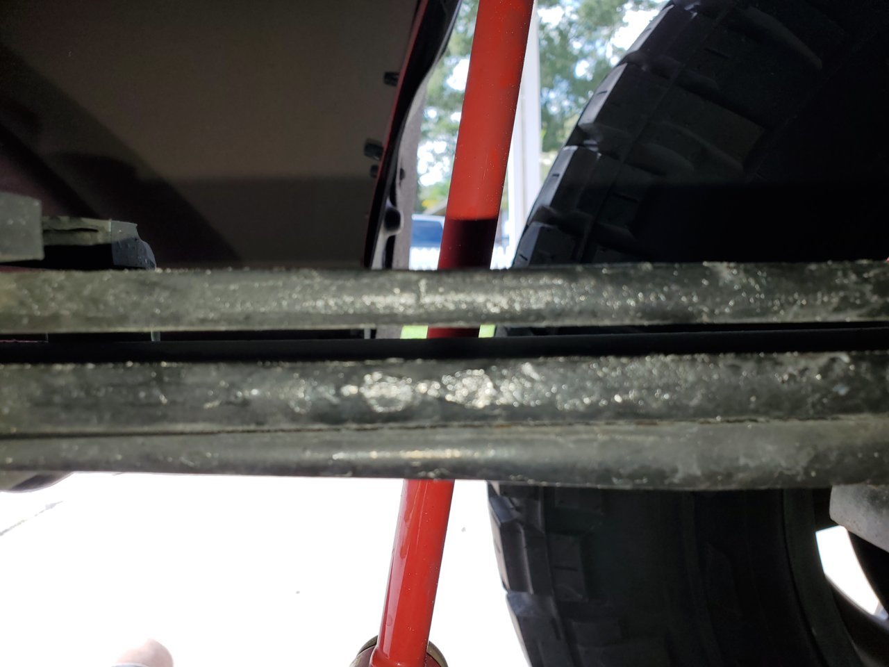

    Mine were shot at 13K miles. Check out the gaps. One of the guys on here had his look like mine at 4400 miles.

    damn, ill have to look at mine closely. Did you pursue warranty at all with toyota? I know suspension usually isnt covered but that would be a premature failure in my book.

    Not worth fighting Toyota over it. My stock ones were shot at 3k miles from the weight and lift i added. Even if Toyota were to replace it will just happen again. And the reason we all spend so much on the Alcans/deavers is because the ride is substantially better than your on the shelf springs. Plus each set is custom made

    No I didn't. I'm lifted so that would toss it out. The ride is so much better than stock springs.

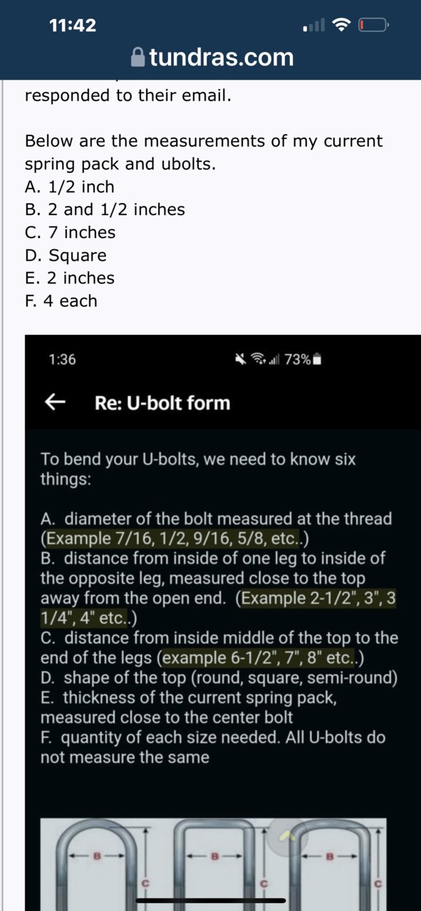

    You should be close. You will be about a week out once you get the email asking about ubolt measurements. Once you email the measurements if you are getting the ubolts from them, call and make sure she has your email. She missed mine and I had to wait an extra week for them.

    Actually, I just looked at email and have 4 UPS tracking numbers from Alcan. A little confusing because I did not get an email for ubolt measurements. Also the weights on the tracking numbers are weird.
    • 4 lbs (I assume shackles)
    • 82 lbs (I assume one pack)
    • 82 lbs (I assume the other pack)
    • 168 lbs (this one has me confused) Maybe I got @Mrf1987 springs as well for a bonus.

    My shipping notification was the same way. The springs will ship as 2 separate pieces. Disregard the 168 lb notification. The 4 lb would be your shackles. The ubolt package weighs more than that. I would call them about ubolts, maybe they overlooked it.

    Tyler is the U Bolt bender I think. He helped me order what was good for my application. Super nice and knowledgeable

    Im traveling right now so can’t measure my U Bolts. Can always run with @Tundra234 measurements which should be accurate for ORM springs.

    They had me double check. A is actually closer to 9/16 diameter. I'll update original post.

    It's updated. Yes, those are measurements for the stock ubolts and stock leaf pack for anyone that needs them.
