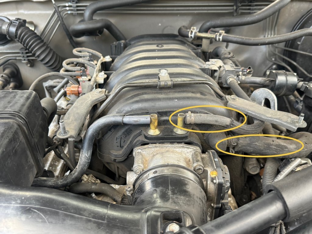

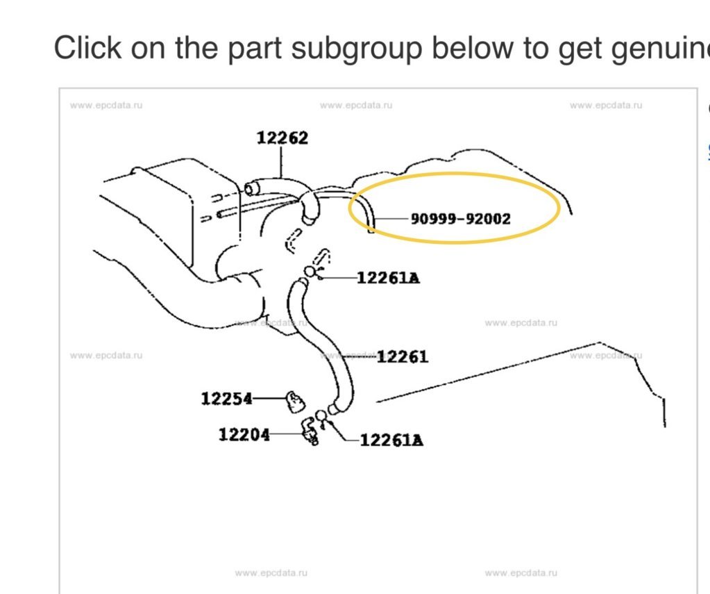

    i'm hunting down a few of those now. I replaced the PCV valve last week and it's in about the same shape. Trying to get all of the specialty molded ones at once because the shipping seems to stay about the same
    I've already replaced the molded and insulated one going to the power steering valve.
    PITA the Toyota dealership says one of them doesn't fit my vehicle and it is identical in the image even though I know you can't always trust that. The one they're suggesting is a big hose. It's nothing like what I need.

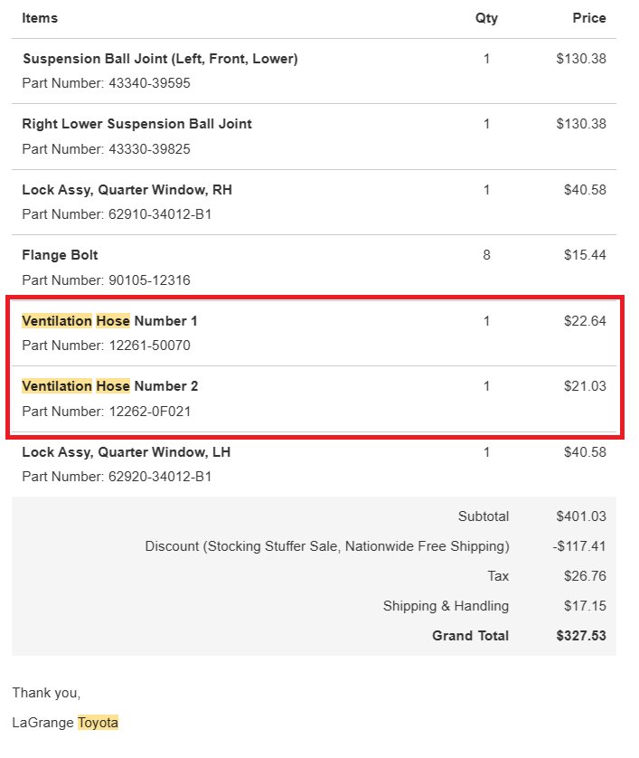

    Here were my part numbers from my order, we both have the 2006 2UZ so I assume your part numbers will be the same. I want to say '1' is driver, '2' is passenger, that jibes with your diagram (first 5 of diagram number almost always matches first 5 of part number)
    Weagle[QUOTED][OP] likes this.

    Confirmed: I just realized as I'm looking at the routing: This makes no sense, the valve is either always-open or always-closed, and when it senses pressure from the PS line it's threaded into, it changes state. This is why, when you pinch the hose, the idle changes; it's simulating the condition of pressure activating the switch. And besides, there's no arrows on the bibs I could see, suggesting directionality, so you'd be at the mercy of the threading of the part to dictate which bib was pointed which way! In my case, the bib closeest to the firewall went up to the intake box. The other went up on top of the throttle body.

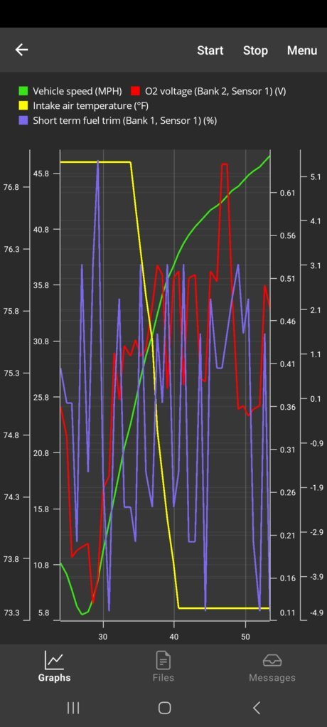

    I think you will get it. In open loop, mine runs at around 1000rpm maybe 1100 during cold start. Only reason i inquired about mxpro is many tuners " turn off" closed loop to get around emissions related codes as ecu is running blind. But I dont think this is your issue as its been dropping as your addressing things. However, it would help narrow down the exact cause. Open loop logging will look like a flat line ( sensors off), closed loop something like this , where you see ecu adjusting per sensor input. Many tuners make " mild adjustments" to open look tune
    And send off. " set cold start parameter, set target afr, timing chart etc" , its not a bad thing. But not good if your changing elevations. Its like measuring by pacing it out w feet vs using a measuring wheel. A quick log of you vac readings would confirm or remove speculation of vav leak.
    Example of closed loop operation: ( me passing slow moving vehicle on hwy)

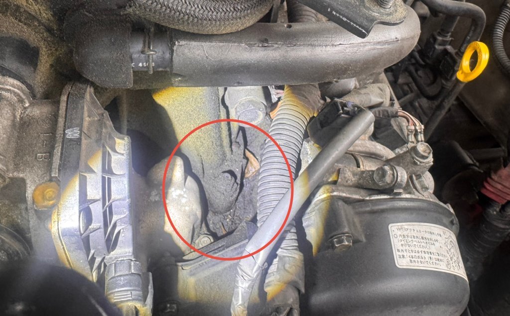

    I am going to try this again. I did it a few weeks back before the throttle body cleaning and it did seem to make the throttle response smoother (less delay) and more responsive. The ECU tune also improved throttle response as it was designed
    G_unit3000[QUOTED] likes this.

    Thats awesome! Well played! Looks like you removed quite a bit of Gunk. !
    Weagle[OP] likes this.

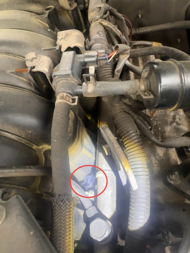

    Update:
    I replaced the power steering air control valve along with a few terribly dry rotted vacuum hoses and the fast idle on a cold start to improved. It drops much quicker, but it still starting off too high
    I just did a smoke test. Smoke is coming out around the top of the valve covers on both side, but it is worse on the passenger side. It's really hard to tell definitively but I think it is from the valve cover gaskets
    the smoke starts coming out so thick I had to turn it off and let it clear and try to catch it when the first wisp of smoke came out. I can't imagine this being related to the long warm start, but could it be affecting the idle on a cold start?
    passenger side. It's hard to see without making a video, but that in the circle is the first wisp of smoke
    ditto on the driver's side
    I know this would not be ideal, but since it seems to be just a very small section on each side, could I do a temporary plug fix with some RTV?

    I guess I'm really just need to take some of the hoses and wiring harnesses off of the top so I can see if the source is the intake manifold gasket or the valve cover gaskets

    I can't remember if I responded to this after I replaced that air control valve. But it did seem to drop it about 20%.
    that was an improvement, but it is still too high as compared to early last summer after header install. I remember specifically because one of the vacuum hoses fell off and the idle was extremely rough and when I reconnected it, it then consistently started at 1800 RPMs and then dropped quickly and was very smooth
