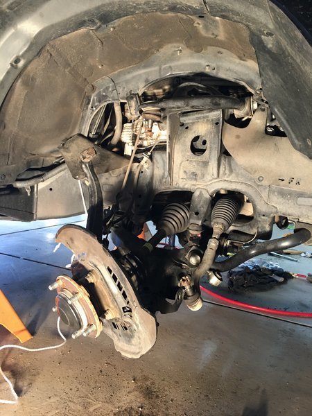

  24. Apr 13, 2016 at 2:24 PM
    #684
    csuviper
    csuviper [OP] Moderator Staff Member
    Jan 6, 2014
    #38
    17,260
    Brian
    Broomfield, CO
    2019 TRD Sport CM 5.7L 4X4
    Missing something?

  28. Apr 13, 2016 at 6:26 PM
    #688
    csuviper
    Jan 6, 2014
    #38
    17,260
    Brian
    Broomfield, CO
    TC UCAs and Toytec Boss kit set at 3.25" and rear at either 1.5" or 2".
    Medic and T-Rex266 like this.
  29. Apr 14, 2016 at 3:42 PM
    #689
    csuviper
    Jan 6, 2014
    #38
    17,260
    Brian
    Broomfield, CO
    Well front suspension is back together. Have one rotor, caliper and pads to put back in. Then wheel spacers and tires. Will check out the new front ride height then determin if I step up to the 1.5" rear block or if I need to go trade it in for a 2" block.
    Medic likes this.

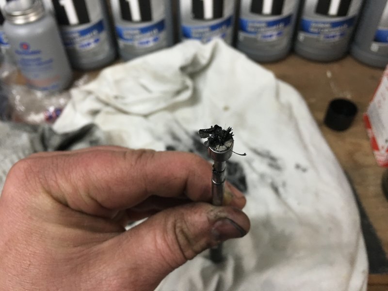

  30. Apr 14, 2016 at 4:00 PM
    #690
    csuviper
    Jan 6, 2014
    #38
    17,260
    Brian
    Broomfield, CO
    Drained the rear diff. Found some metal pieces. More than what I was hoping for but nothing concerning.
