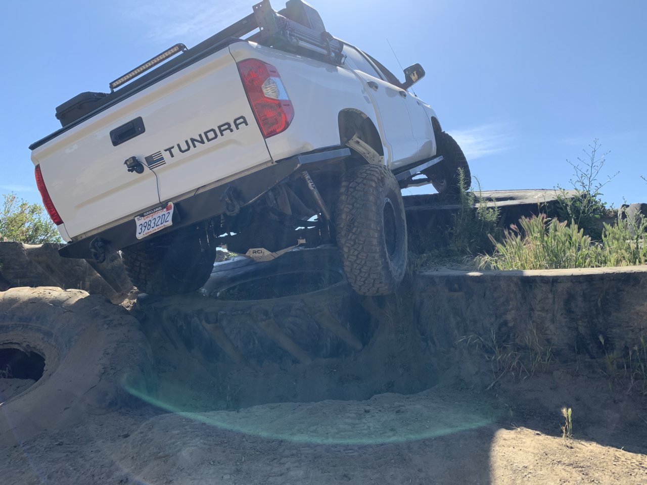

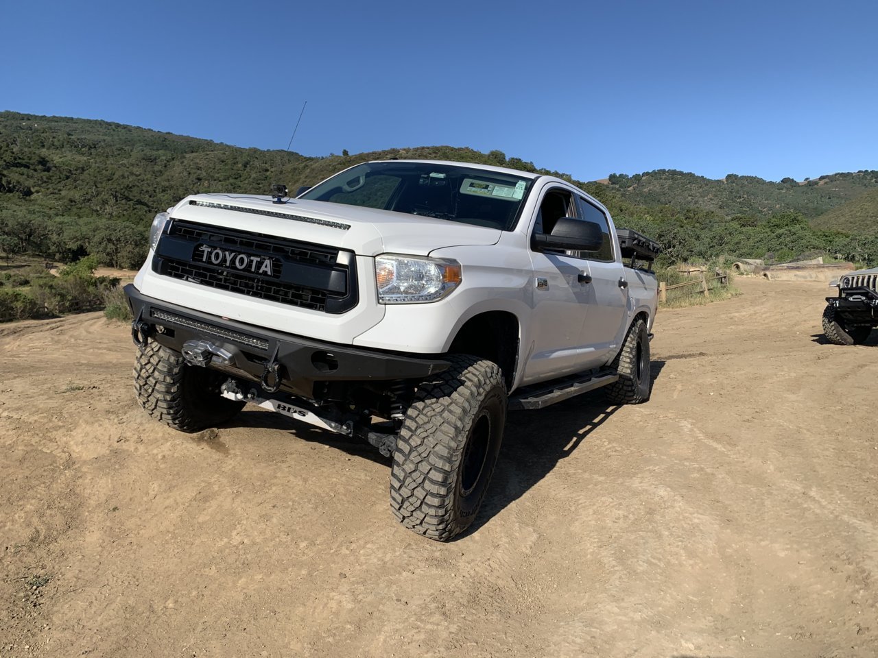

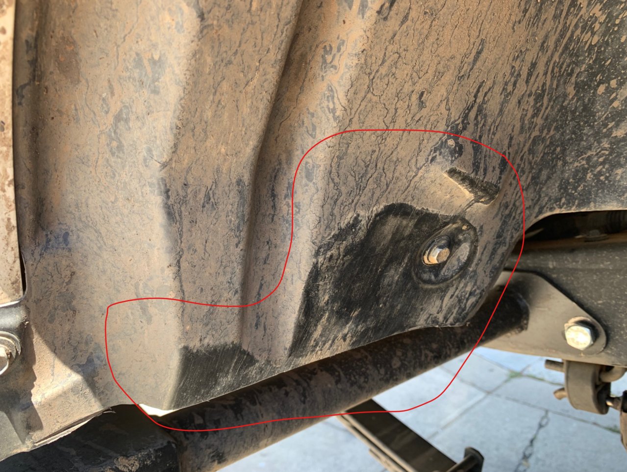

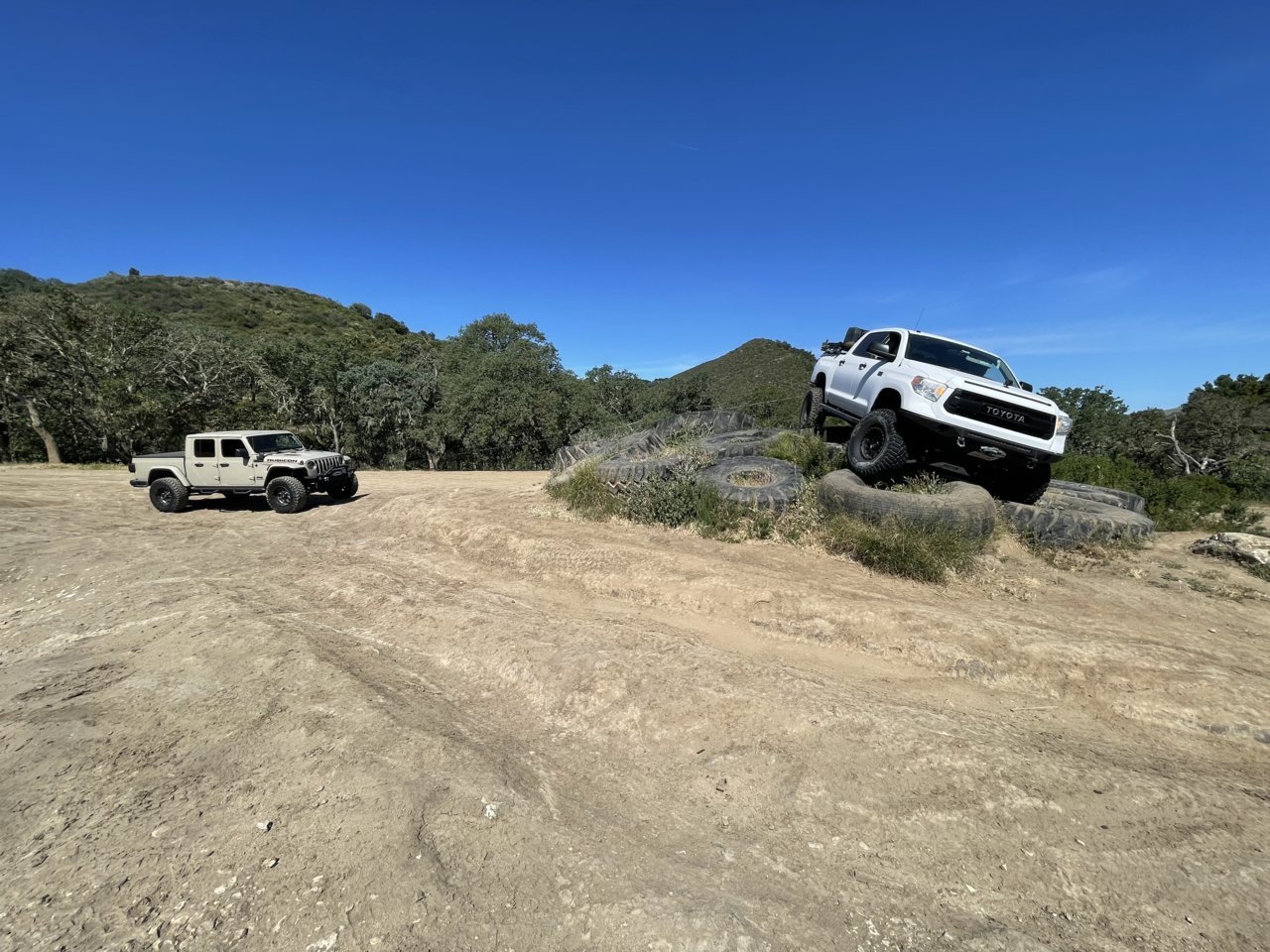

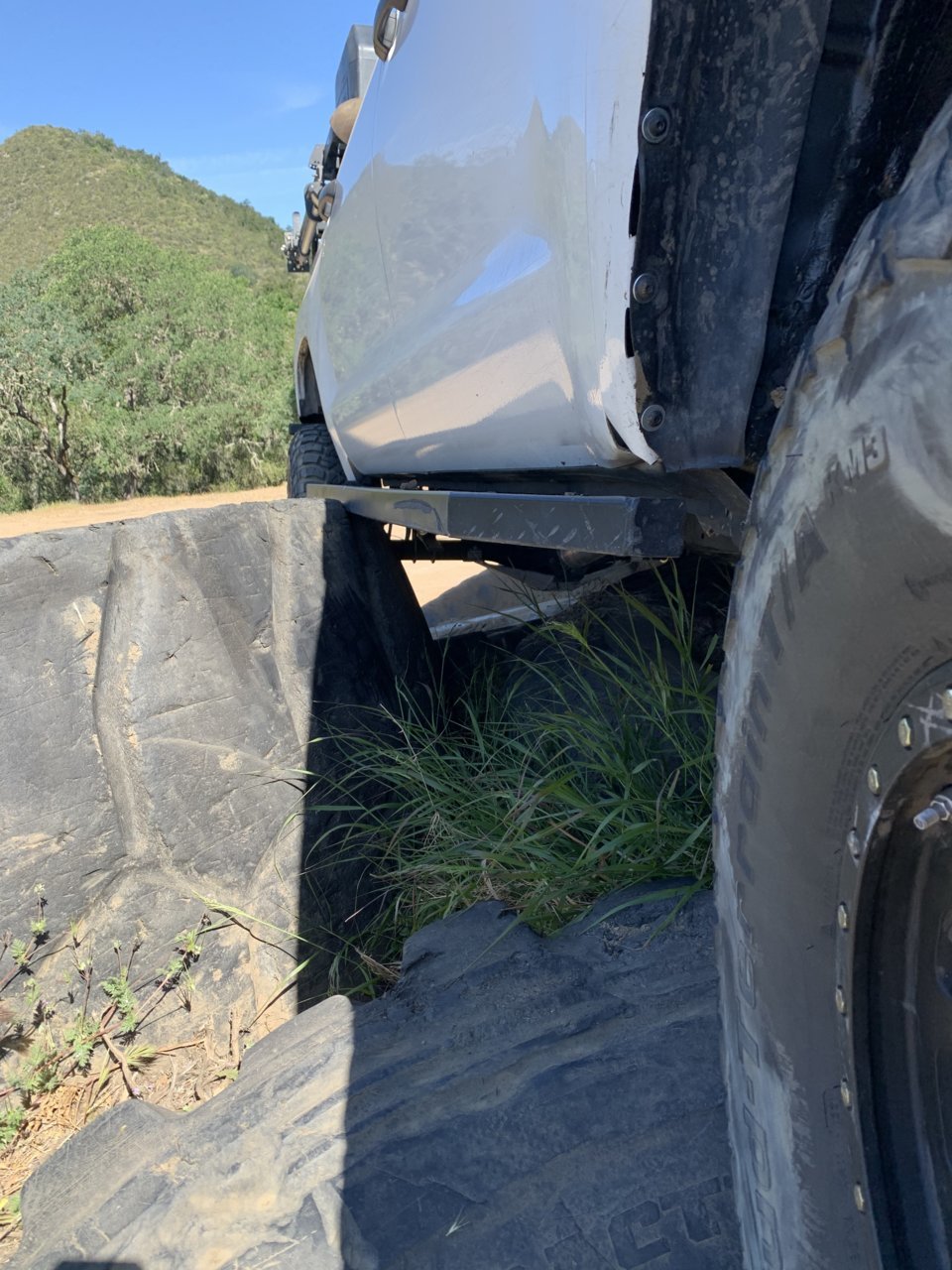

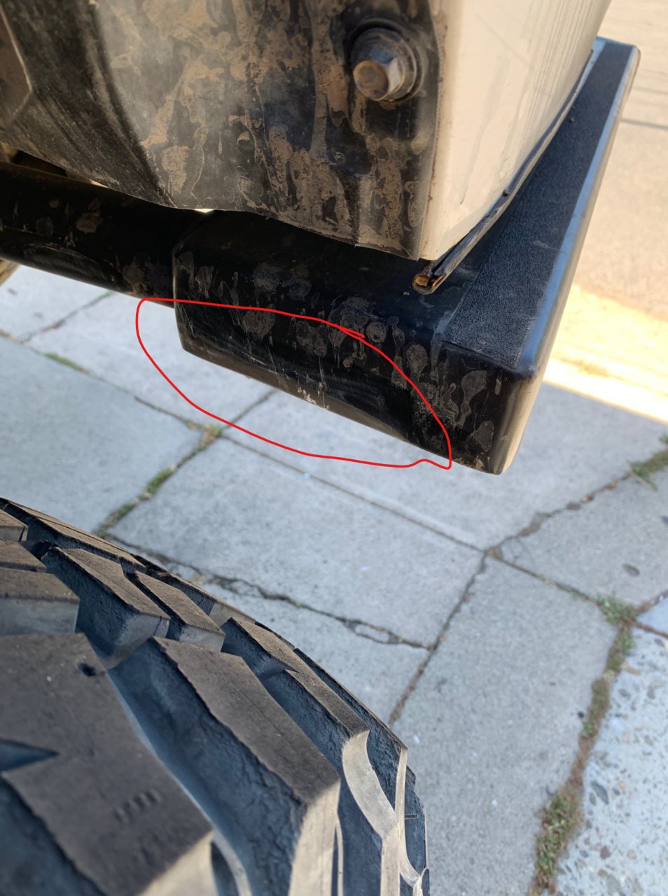

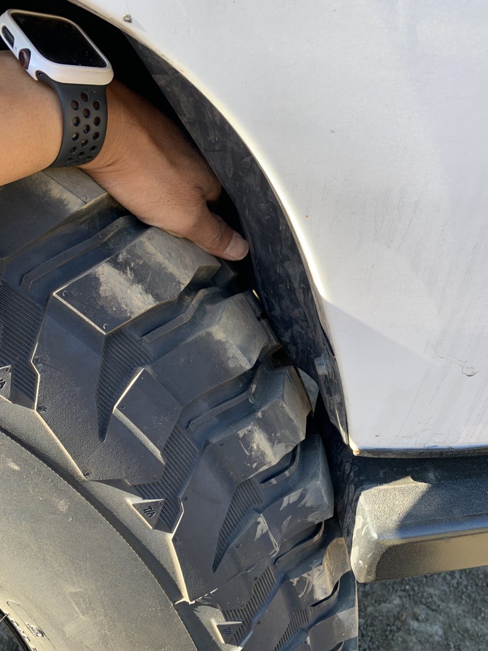

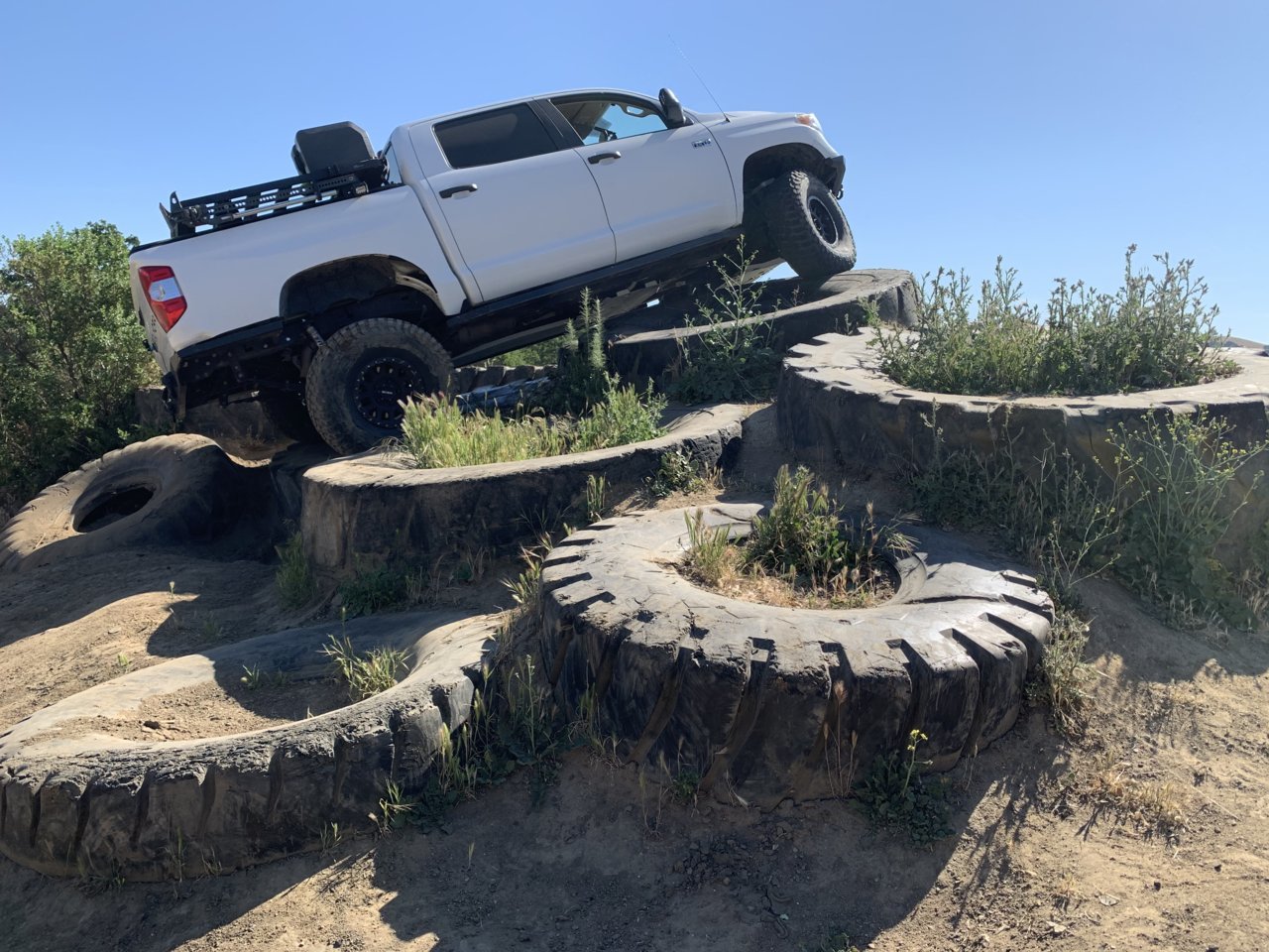

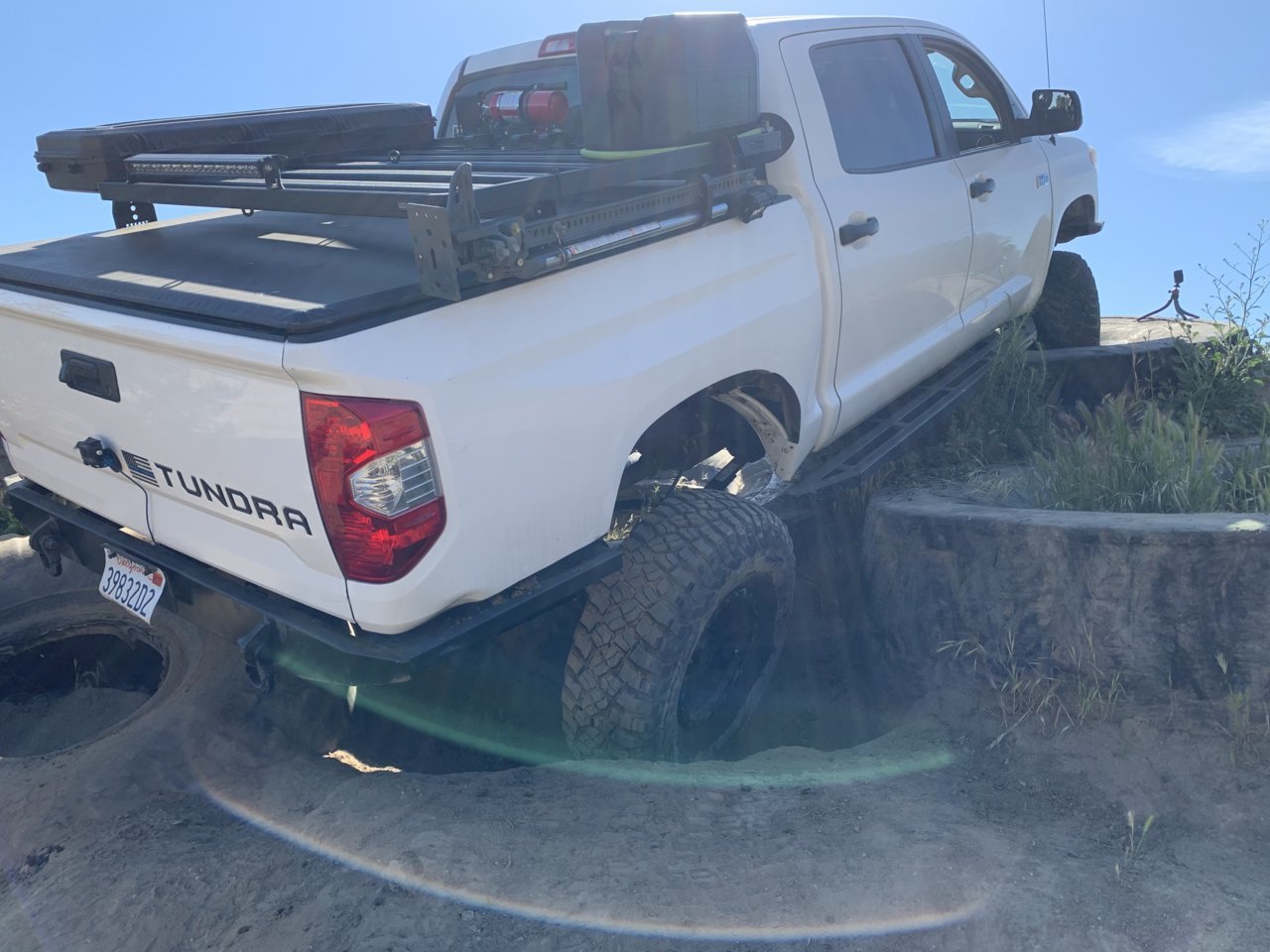

    Took the truck out for a test ride at Hollister Hills this morning. Here's what I learned:
    1. Truck can't take corners like it did with 37s on pavement.
    2. KM3s are pretty quiet on the highway. So much so that I can now hear my rear 5.29 gears whining, which I thought they didn't.
    3. KM3s are not that great on the dirt. I'm missing my Yokohama X-MTs right about now.
    4. Found a little dirt mound and tested the flex. Rear tires tuck in nicely BUT it rubbed pretty hard on my rear bumper. The caveat though is that my rear bumper is wide where it meets the tire - so if you have a plate or tube bumper that stays on the outer perimeter of the body then you're good. However, you would still need to do some fender trimming of the rear section.

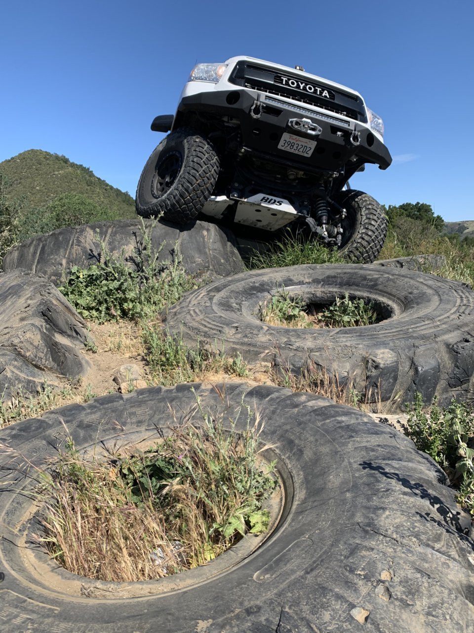

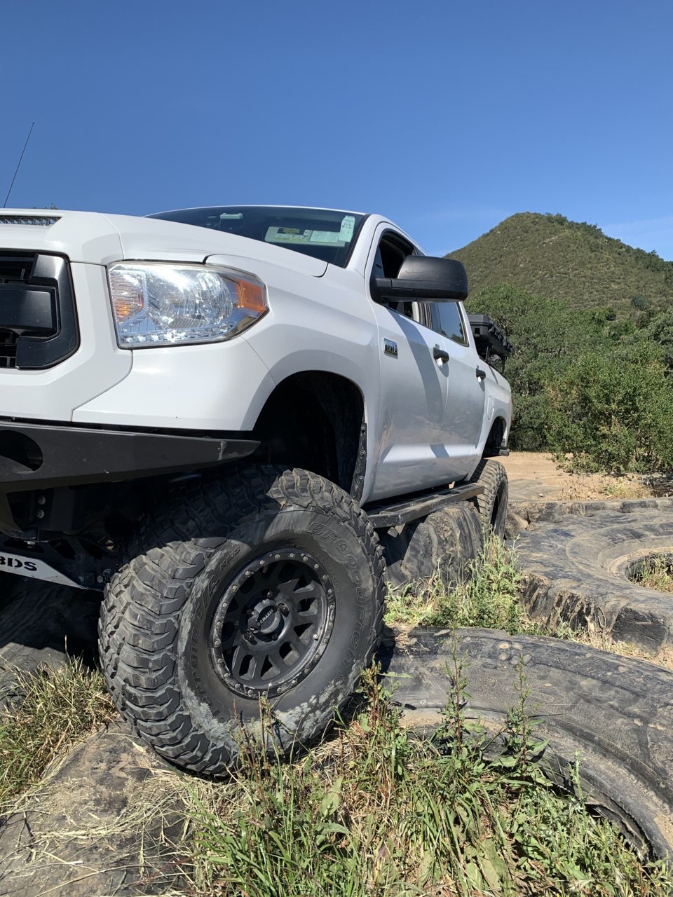

    5. Can I fit 40s? I believe I could but then I would be relegated to hanging out at the mall. I love my rear bumper, the 39s do rub on it pretty hard, so I'm thinking of having it shaved a bit.
    6. What about the front? I didn't get a chance to test that out as I started goofing around. Did the usual tree log obstacle. Tried going over some of the cement pipes - nope, got turtled. Then I went for the large tire pile.
    Was climbing over the top.
    Then I got sort of hung up with rear wheels having minimal traction along with the front driver. But the passenger front tire was wedged in pretty good, so with the help of the HP Tuner 4Lo delete, I gave it some ooomph.
    After the oomph I heard a loud pop. I believe the passenger side CV axle broke. With lockers engaged the driver side tire spins and I don't hear any gears grinding but got nada from the passenger side.
    After being winched forward a little, I was able to go straight down but aided by my friend - he had his winch on my bumper in case I tipped over.
    It must be fate though because I ordered my RCV axle last night :D
    But all in all the whole time I was mobile I never felt the front end rub at all.

    Some cut off wheels, a grinder and a welder with fix that bumper quick. Even better if you have access to a plasma cutter.
    Looks great.

    @dcsleeper408, Mark is close to you and I'm sure he can do a little pruning and welding to clear your bumper.

    That's what I'm thinking.
