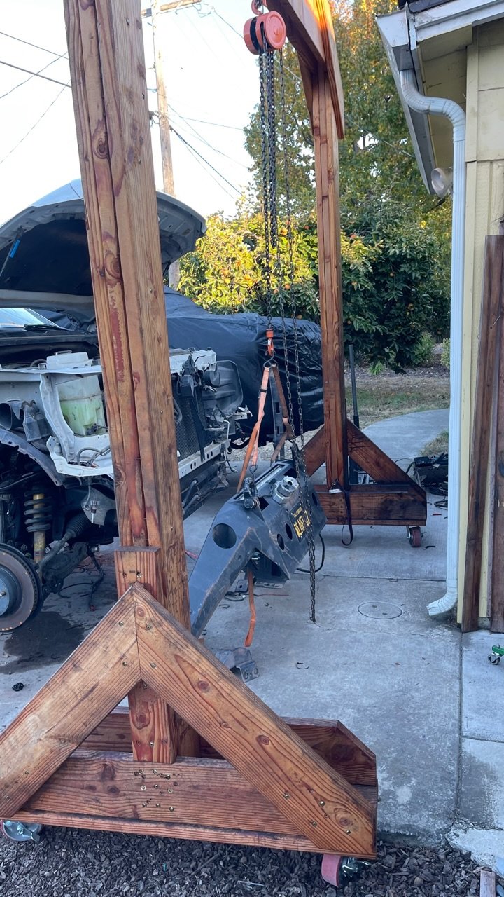

    That contraption probably cost as much to build as the new truck you bought ! Lumber ain't cheap anymore

    I thought you were making something people get married under little did I know it’s for the tundra. :rofl::rofl:

    I would definitely look at making the bottom part where the casters are attached longer to make it more stable. You get any sort of weight hanging on that and try and move it the whole thing will fall over if a caster gets stuck in a crack or hits a little rock. There is a ratio based on height of the gantry vs length of the bottom legs and weight being supported. It gets a little more complex when things swing as well. I've seen these things start to swing before and when that happens the gantry will start hopping. It's scary as hell with good weight on it and you just need to get out of the way and let everything happen.

    Yeah, I plan to bolt on longer pieces for stability. I built it that way in order to fit through the side of the house.

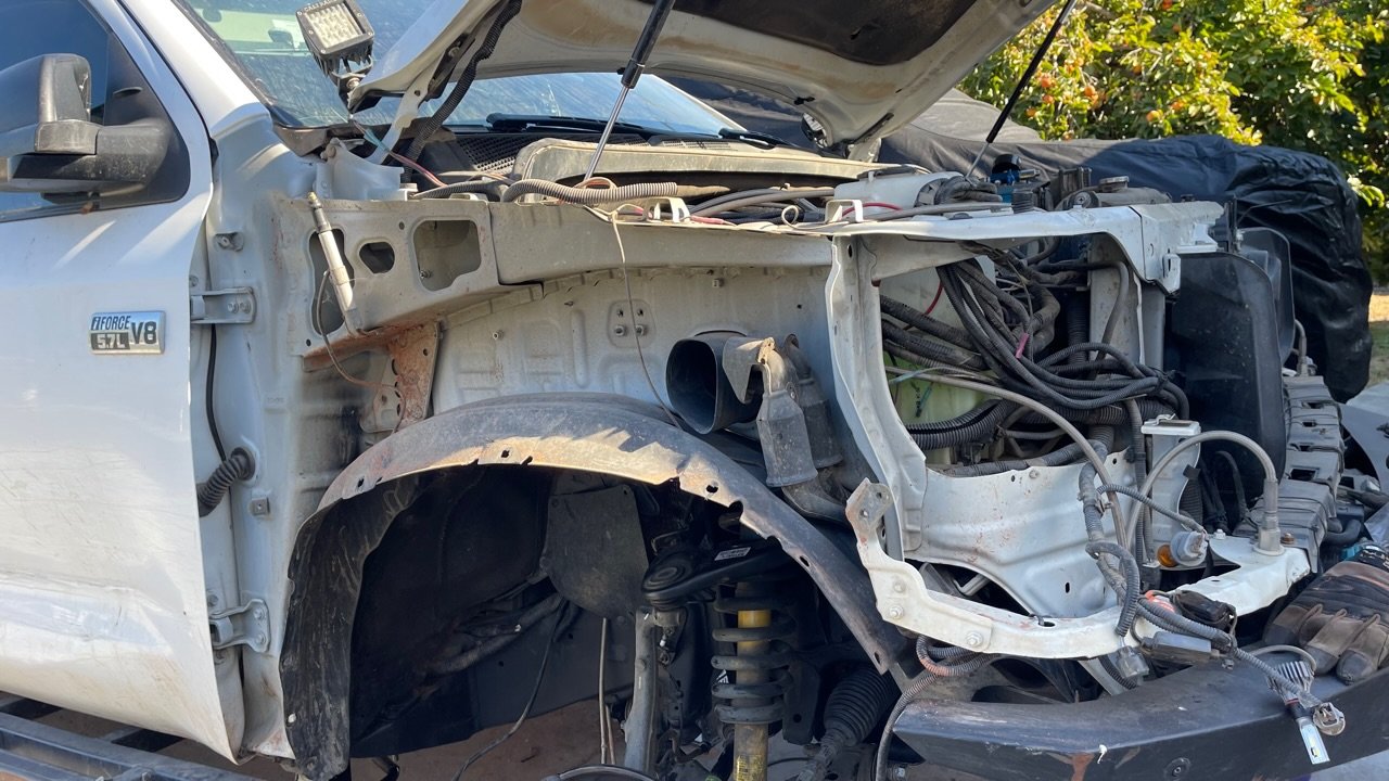

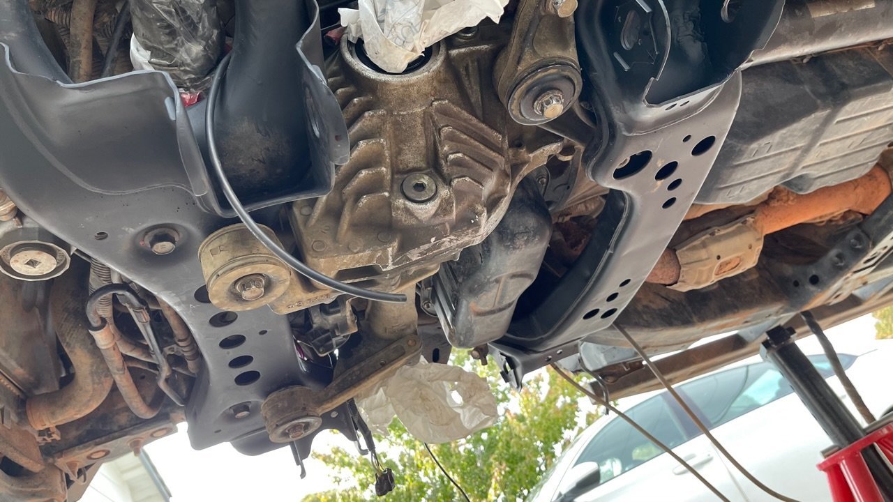

    Wasted many weeks with this crossmember. Welded it on, didn’t like it, ground it off. Welded it again, didn’t like the bird turd I was laying, ground it off. Welding uphill, welding overhead. Kept adjusting the welder settings and kinda figured it out. Got it to a point where I was ok with the welds, repainted it, and finally bolted the front diff back on. I’m thinking the CM will be more whole by next weekend.

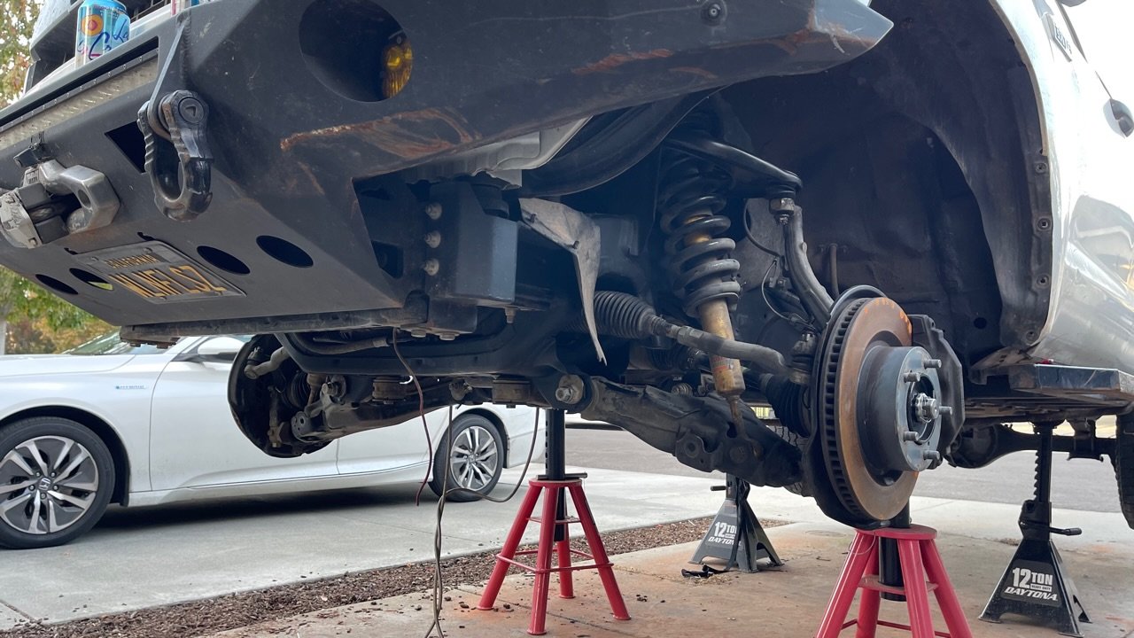

    Got most of the front suspension back on. Gonna swap out the bumper, grill, and fenders tomorrow. Hoping with the fenders off the alternator is easier to get to, if not I’m leaving that mofo in there.

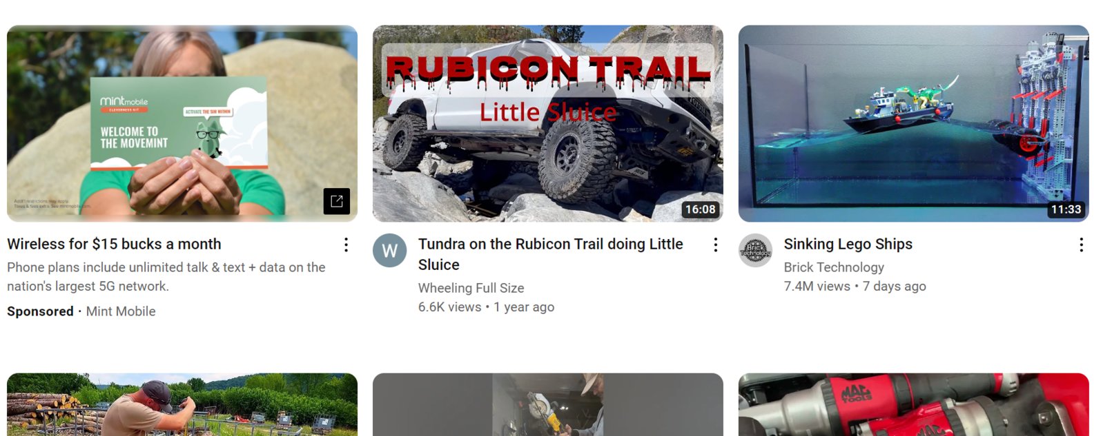

    Look what popped up on my YouTube homepage. Algorithms at work.. guess I gotta watch, like and subscribe now :rofl:

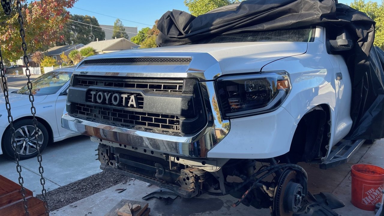

    I thought removing the bumper with the winch on it was gonna be a bitch but with this gantry it was easy.

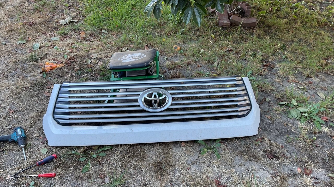

    I prefer the Limited grill insert over the Pro insert so I swapped them out.
