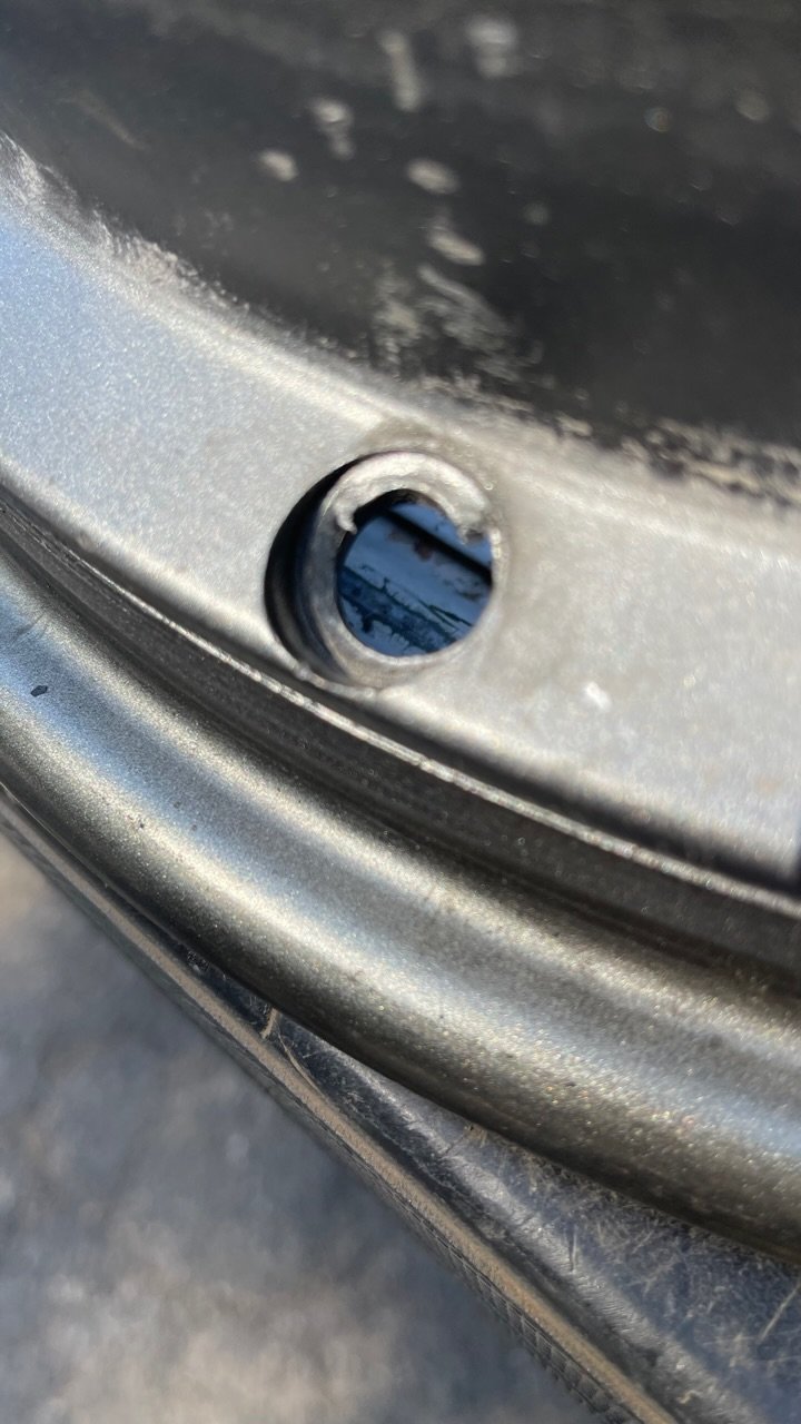

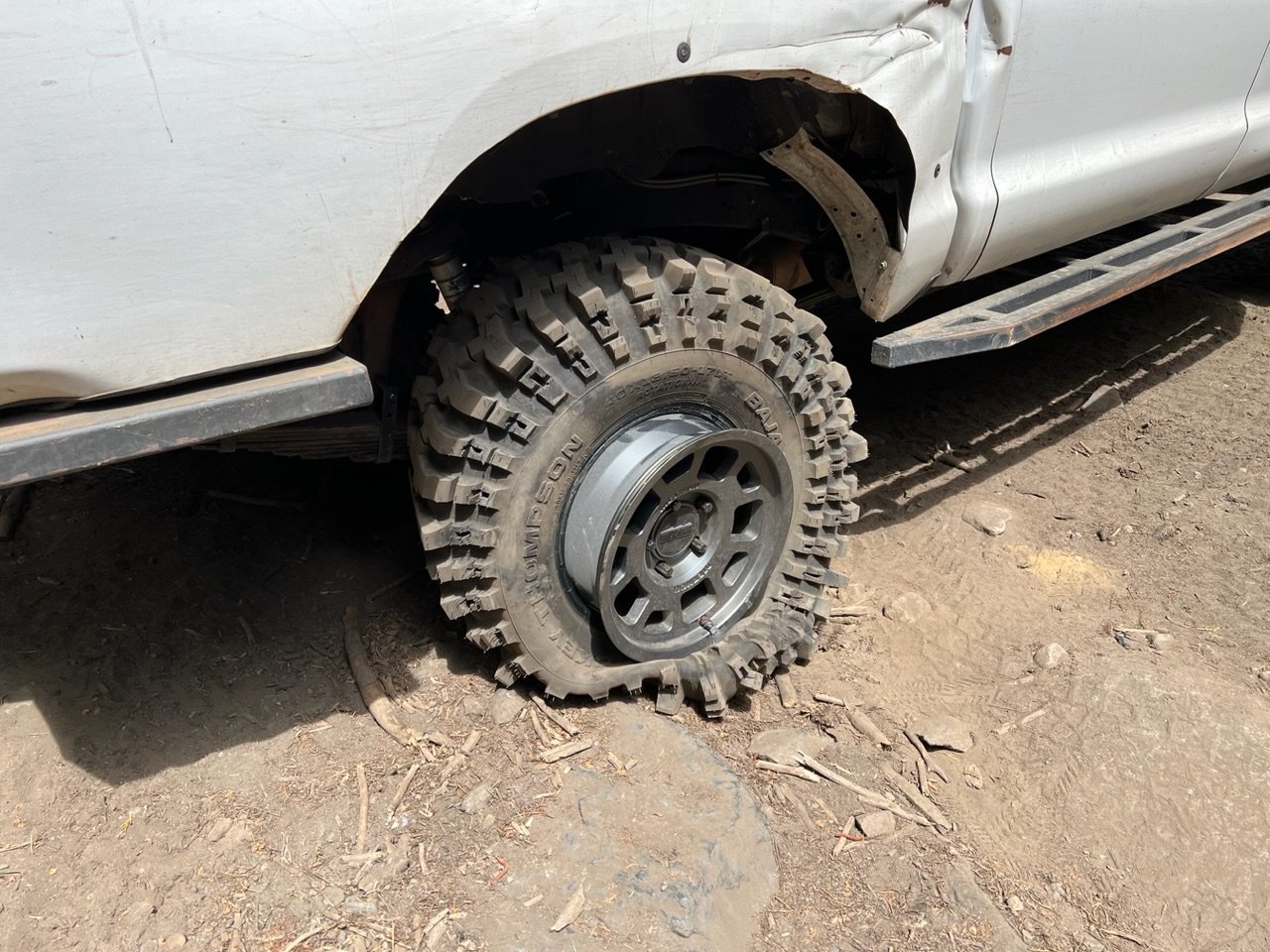

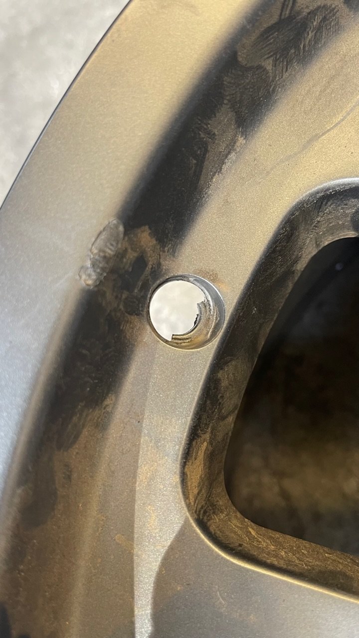

    This happened yesterday.
    I think the new valve stem got sheared off by a rock, since it stuck out, let all the air out, then popped the bead.
    Went to a tire shop to get a new valve stem and pop the bead back on but found out that the wheel broke at the valve stem opening. Apparently the valve stem cracked off a couple pieces of the wheel and the shop couldn’t put a valve stem on. There goes the rest of this trip.

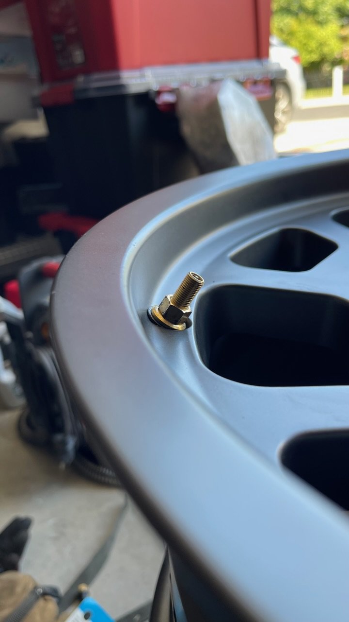

    Just ordered the Colby extra short permanent valves. Fuck all that fancy shit.

    Build Page: Cruzer's Re-Build for the Rubicon
    Not as short as I thought they’d be. Ordering even shorter ones now.
    Kiiiiinda having regrets. Gonna give it another chance. But if I snag another valve then I’m putting these up for sale. I realize now that my fake beadlocks did a very good job protecting the valve stem.
