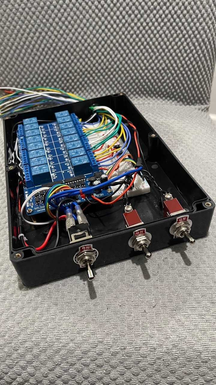

    I finally got 4Lo working when the truck thinks it’s in 2WD!!
    I initially made it more complicated than it had to be. Now I just gotta clean it up and make it production ready.

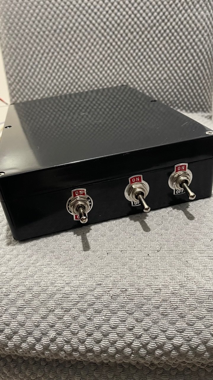

    I’ll be able to use the Tow/Haul button to give me the boost I need in 4Lo. Hopefully I don’t break shit now that I’ve bypassed the ultimate nanny.
  18. Jul 23, 2023 at 10:19 PM
    #1278
    snivilous
    snivilous snivspeedshop.com
    Apr 16, 2019
    #29192
    4,733
    SW UT
    300k+ Supercharged 2008
    Can you elaborate on what that means and why you needed to do it?
    FrenchToasty likes this.
  19. Jul 23, 2023 at 10:28 PM
    #1279
    Cruzer
    Cruzer [OP] Wheeling Full Size
    Oct 12, 2020
    #53461
    3,246
    Cruz
    Sunnyvale, CA
    Build Page: Cruzer's Re-Build for the Rubicon
    When I had 37s it was easier to climb up an obstacle, say for example a 3’ ledge, but with 40s I couldn’t go up the same ledge. I’d step on the gas and it didn’t want to do anything. Couldn’t even get the RPMs high enough. Apparently, the ECU is limiting how high your RPMs or throttle valve angle are when in 1st gear 4Lo.
    As you know, the tow button can be programmed for a different throttle valve angle. I’ve tried 1st gear at 15% and holy shit it’ll jump! But the tow button only works in 2wd. I need the tow button oomph in 4Lo hence this box.

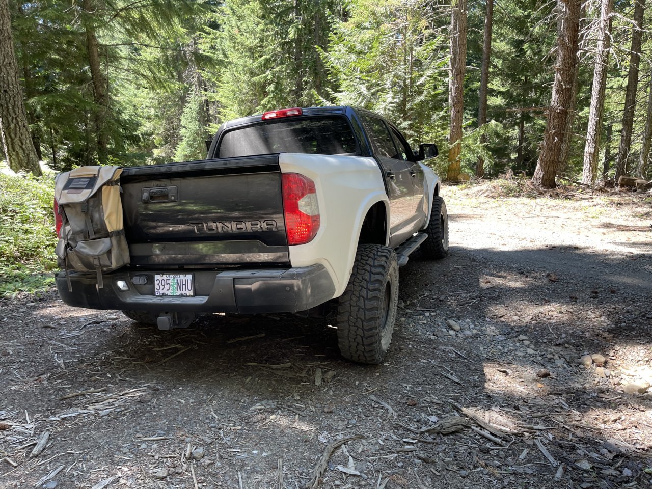

    Got the new bag on with the new shoes.

  22. Jul 31, 2023 at 8:39 PM
    #1282
    FrenchToasty
    Sep 15, 2019
    #36156
    18,344
    Mo
    The SoAz….. big surprise
    Bone stock
    Fancy sack!
  23. Jul 31, 2023 at 8:56 PM
    #1283
    reywcms
    reywcms New Member
    Dec 20, 2021
    #72040
    7,021
    Rey
    Beaverton,Oregon
    2017 Tundra Platnium
    Too many mods to come
    Dude they make great bags. I got one of the early ones. I need to update and get the heritage colors lol.

  25. Jul 31, 2023 at 9:00 PM
    #1285
    reywcms
    reywcms New Member
    Dec 20, 2021
    #72040
    7,021
    Rey
    Beaverton,Oregon
    Yep I have that same fabric one before they switched
