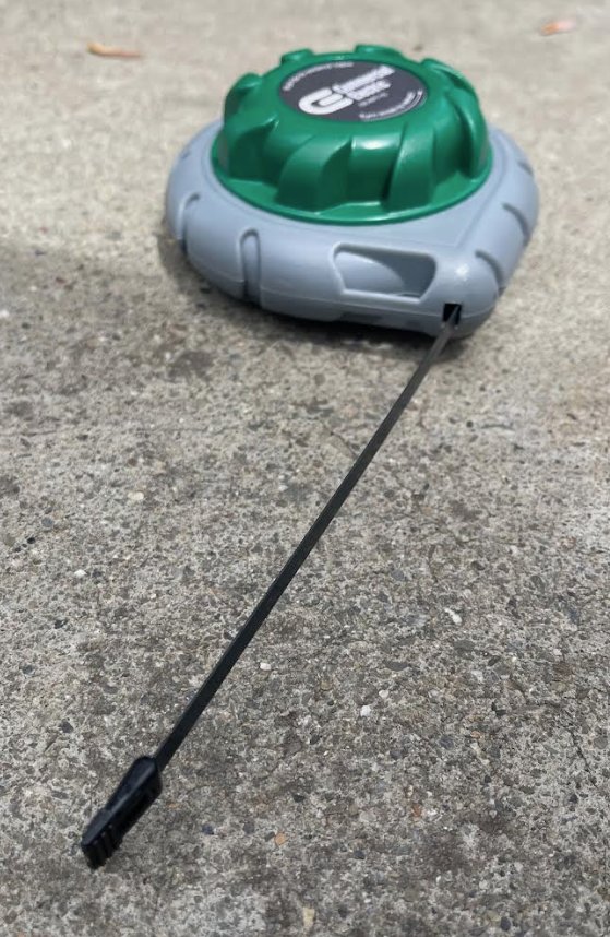

    What a long long week. After leaving T2S on Friday morning to go to Stagecoach in the Coachella Valley I had yet another misadventure.
    Since my truck was still shaking, which was making me paranoid, I scheduled a morning appointment to get the rest of my wheels balanced at Discount Tire in Kingman. Halfway there I pullover to get gas. Tried to pump gas but the stupid pump would just click. Get a squirt of gas in and click. Click. Click. WTF?! Stupid gas station! So I went across the street to the other gas station - same thing. Uh oh. That's when I realized I somehow triggered the rollover check valve inside the fuel tank. Fuuuuuuckk! After 20 minutes I was able to get 8 gallons in and just left to make my appointment.
    I read on the forum that the fix is to drop the fuel tank, remove the filler neck/hose, and pop the valve back in. I didn't have time for that shit. Once my truck was in the shop I walked over to Home Depot and bought these wire fishing tools.
    I stuck the flexible pole in the filler neck but it didn't get far. So I stuck the fishing tape in and got about 3-3.5' in before it couldn't go any further. I started poking at whatever was on the other end pretty hard. Went to a gas station and filled right up :cool: I'm going to carry this mofo in my toolbox from now on.

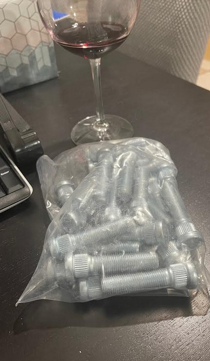

    Got this today. It's the eBay M14x1.50 ones that @Vizsla has. Thinking I'll change them out every 2 years (studs and lugs).
